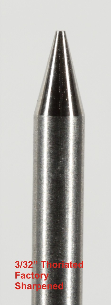

    I was playing around with Chem-sharp tungsten tip sharpening method just to see how well it worked. I decided to give it a try mostly because I didn’t want any more “pollutants” in me from the grinding dust in either my basement or garage workshops. It’s pretty easy to step outside into the breeze with nothing more than a pair of pliers, a propane torch, and a jar of Chem-sharp (I found it’s better to heat the tungsten with a propane torch and work the tip in the Chem-sarp with the pliers).
    First let me qualify my “Chem-sharp testing” as nothing more than curiosity by someone who is trying to learn how to weld, purely for a hobby purposes. So I am absolutely as green as a person can be; an honest to gosh “Pilgrim” trying to follow John Wayne’s footsteps.
    I had what I consider to be the absolute good fortune of acquiring an Everlast 250EX only a few weeks ago. Up until that time, I never so much as held a TIG torch in my hand. Needless to say, I make more than my fair share of mistakes.

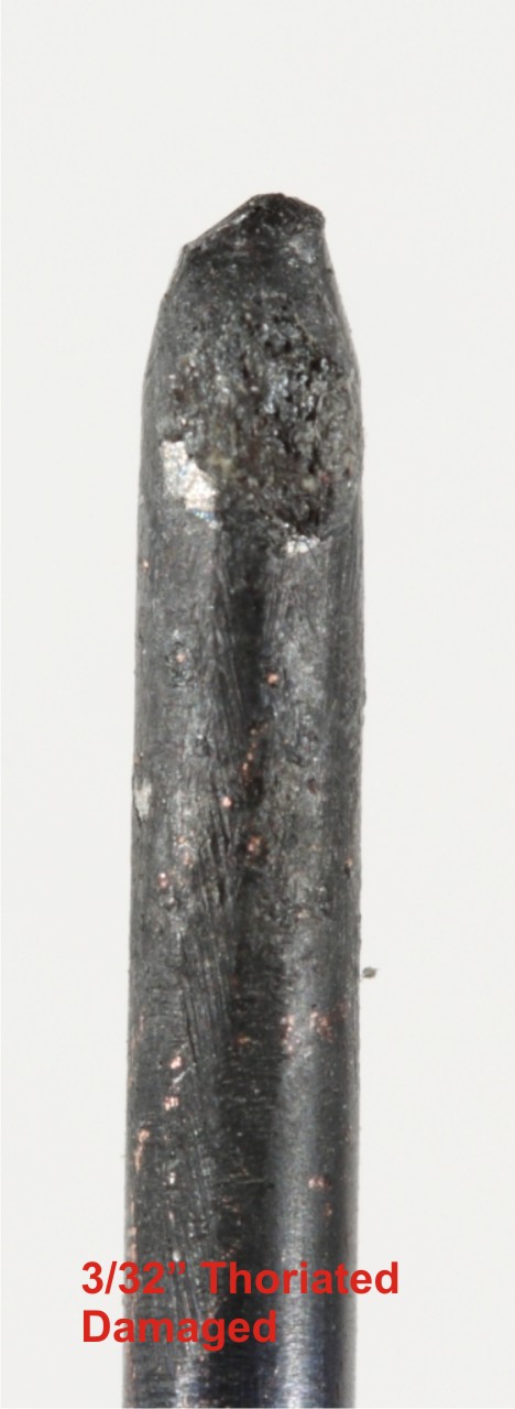

    I “proudly” damaged the tungsten shown in the picture. Technically I had already known enough about the purpose and absolute requirement for the argon shield. I had read many articles and watched a lot of videos demonstrating the TIG welding process. I even knew enough to keep the large fan I had blowing on me positioned such that it couldn’t possibly blow any air over my practice table.
    After I had been doing nothing more than simply practicing running a pass along a piece of sheet metal, I decided to push it a little adding a little filler rod to a pass. The first pass or two went fine. Suddenly everything went wildly haywire and everything flared up in front of my eyes. I had no clue what happened. I spent hours trying to figure out what “I was doing” wrong. Before I even went into the garage and power the machine up, I had made a “Check List” of every setting. I double checked my check list; no accidental changes there. I checked to make sure I had argon in the tank; nearly full. The ball blow indicator was still right where I had set it. I could hear the air solenoid in the machine clicking when I hit the foot pedal. I was totally stumped, and I mean totally stumped. What could I be doing wrong?
    I finally decided to give it up for the day. To be honest, the first day I tried the machine out, I was like a kid on Christmas. I had fastened the argon tank in a safe corner between some shelving and the block wall. I had simply set the machine on the floor support by some scrap 2”x4”s. I had very carefully attached the argon hose to the barbed fittings at the tank and machine
    I already had turned the machine off so went over to the big fan and extra temporary work lighting and turned them off. Walked over to the argon tank to shut it off at the main; I had just had put my hand on the valve when I noticed a loud hissing sound; like my truck tire going flat. I followed the sound (I am sure every single one of you knew this as soon as I started describing “my” problem) and saw the argon hose had popped off of the barbed fitting on the machine. All that time beating my head because I couldn’t hear the hissing with the big fan running. Naturally I fired it back up one more time and everything was back to normal.
    As I look back on it, I think it’s funnier than heck. I should have checked that. No one had ever put up a video showing what happens when you light up an arc without the argon shield. That’s one lesson learned. Oh yeah, I had tightened the hose clamp to the point I was wary of breaking it the first time. I made sure to tighten it just as hard as I dared the second time. The next day I was setting up to practice and shortly after I had turned the argon on while I was checking the machine settings, Two nnew heavy duty hose clamps are now on each end of the hose.
    That story should give you an idea of just how new I am to TIG welding. So please take that into consideration. Yes, you’re also free to laugh at me. I am. I think it was hilarious……Now!
    Oh yeah, I was writing about the Chem-sharp test, sorry.
    The tungsten shown in the pictures is 2% Thoriated (red). It’s 3/32” diameter, 2” length, and factory sharpened at both ends. I have the pictures of the tips magnified quite a bit. Most of the finer scratches aren’t visible to the naked eye.
    1. Factory Sharpened--This is a new factory sharpened point
    2. Damaged—This is what happens without the argon gas shield

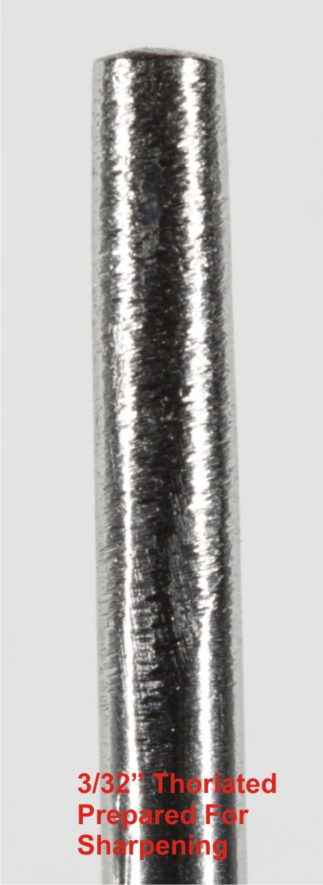

    3. Prepared For Sharpening—This is the tip prepared for sharpening. Note cross grinding marks. The intent is to remove a small layer from the tungsten to eliminate those marks

    The tungsten that was sharpened with Chen-sharp was already becoming too short for practical use. Normally I would have broken the end off and started sharpening on a section of tungsten I could be sure wasn’t contaminated.
    I haven’t tried that particular piece of tungsten yet, but I am guessing it would have a slightly narrower arc.
    I have used Chem-sharp sharpened tips in both 2% Thoriated (red) and 2% Ceriated (orange) in several sizes up 1/8” without what I would think was a surprising result. On the other hand these were all standard unsharpened 7” pieces.
    I was kind of hoping an experienced eye might have a look and please add their thoughts or comments. No matter how hard I try, I can’t learn someone’s experience. The old saying of “How many years does it take to get 30 years of experience” is as true today as it was before the pyramids were built.
