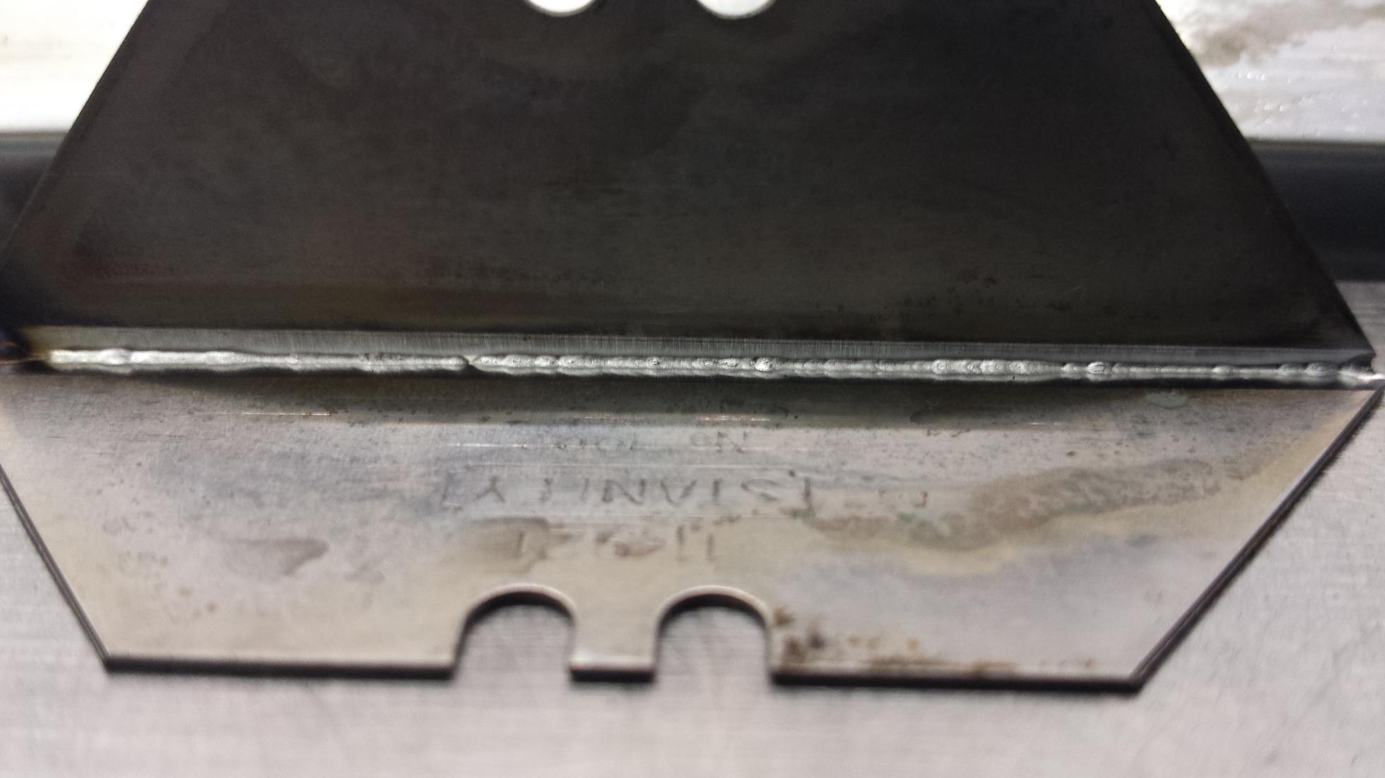

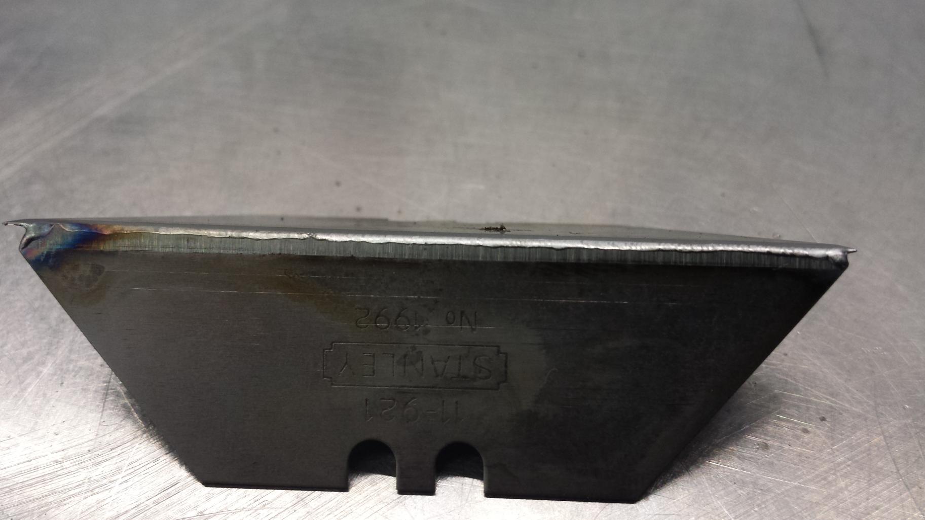

    Anyway this was my first use out of the machine, fusion welded 2 razor blades together.

    Wow...so nice!
    showing no signs of heat....cept a little at the very end.....to be expected.
    Im impressed!

    Thanks, the heat build up was actually starting the arc. Used aluminum angle for backing.

    I wondered about that. Looks real nice! What settings did you use?

    Powertig 185 set at about 15 amps on the panel and used a pedal, 3/32 e3 tungsten sharpened to a point, and a # 7 cup with gas lens
