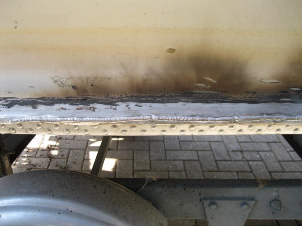

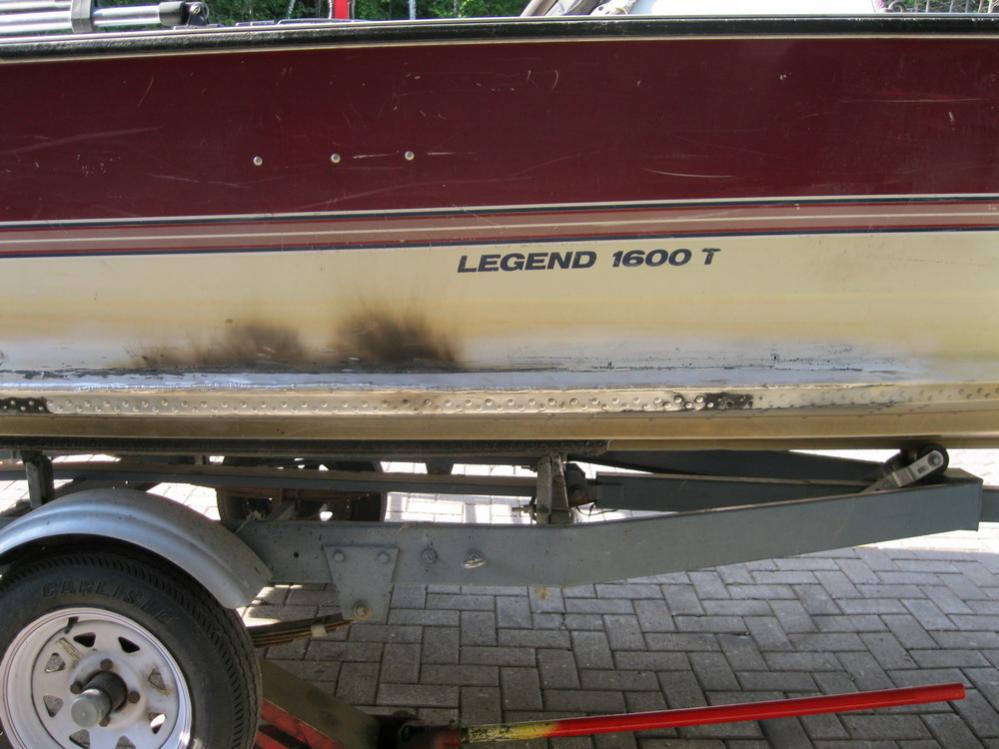

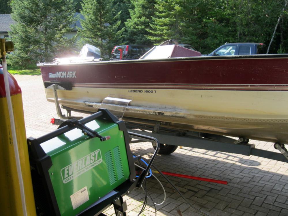

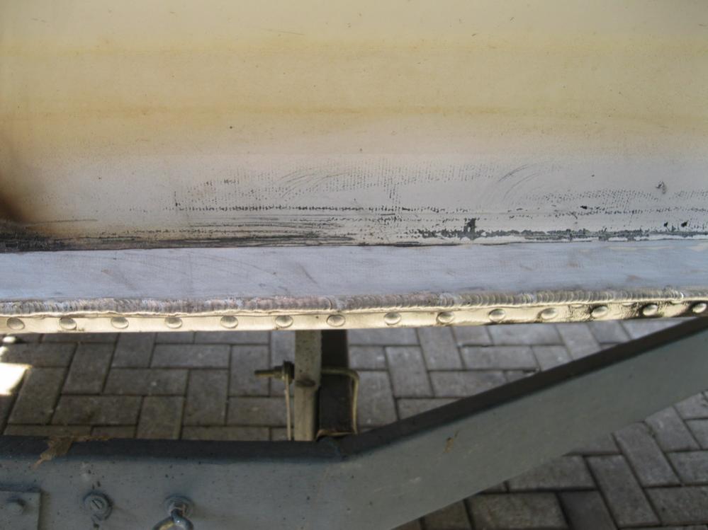

    Used the new 325EXT in single phase 240V had to welded a boat with a crack 52 inches long just a little leak.
Name:	52 inch crack 325EXT-A.jpg
ID:	12260Click image for larger version.
Name:	52 inch crack 325EXT-B.jpg
ID:	12261Click image for larger version.
Name:	52 inch crack 325EXT-C.jpg
ID:	12262Click image for larger version.
Name:	52 inch crack 325EXT-D.jpg
  9. #29
    Dang. How did you prep it?
  10. #30
    Grind all the paint off sand blast some of it and tack welded every six inches then weld it up on pulse weld used vice grips to hold it first before tacking it.
