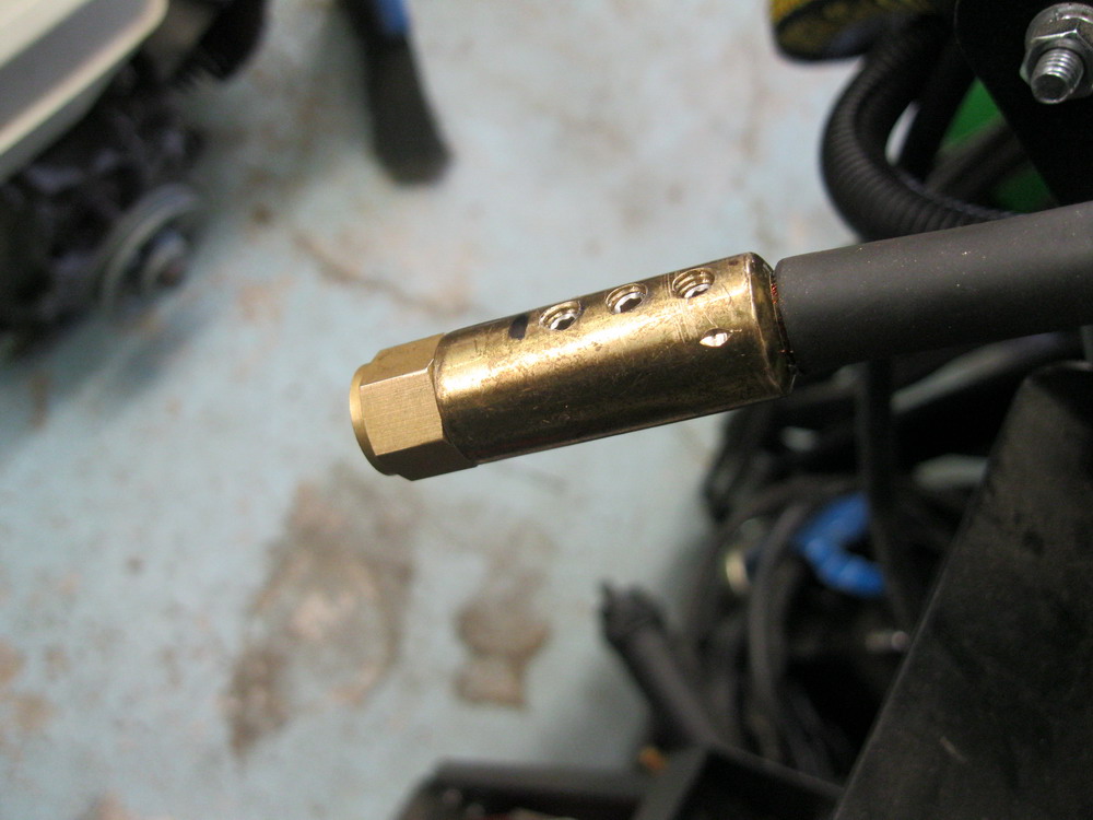

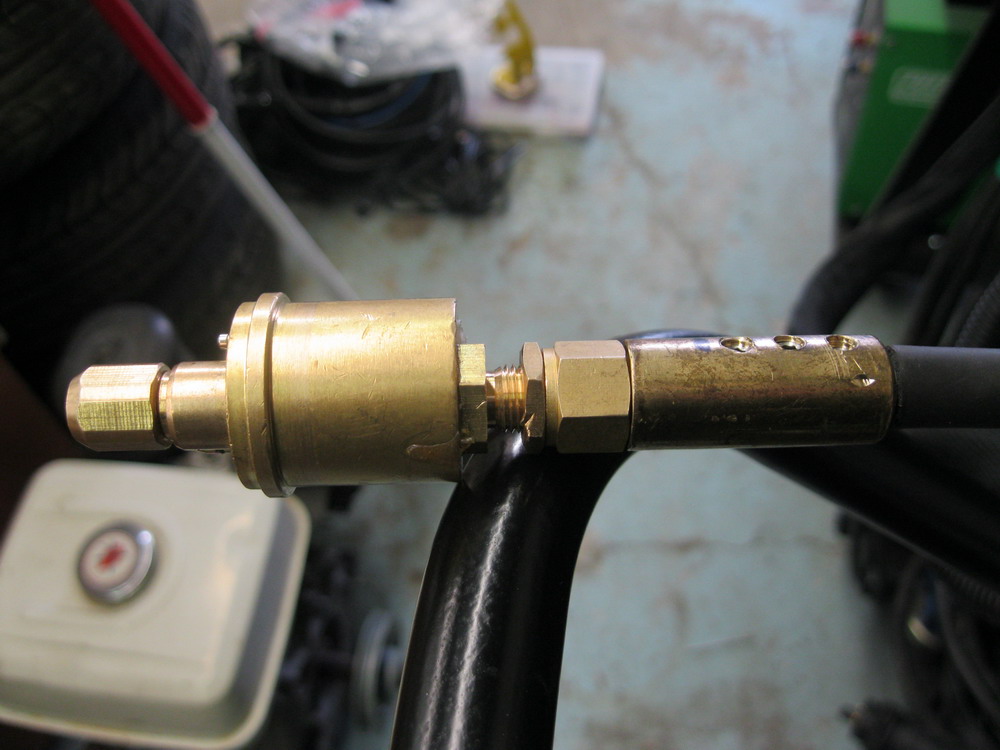

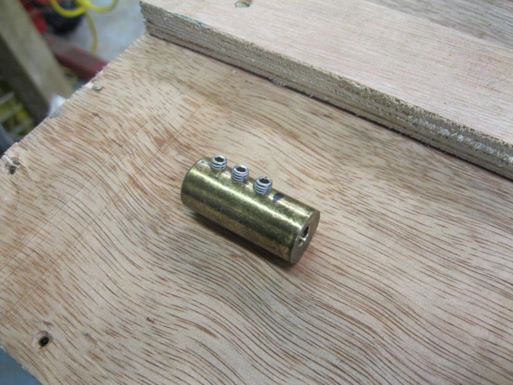

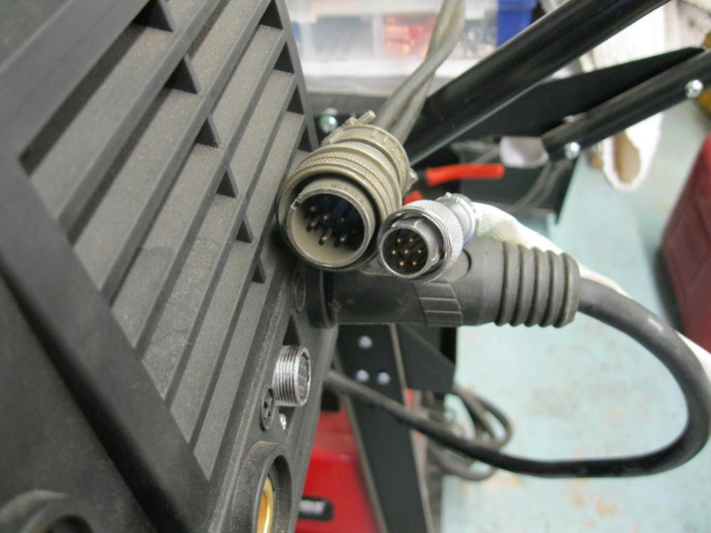

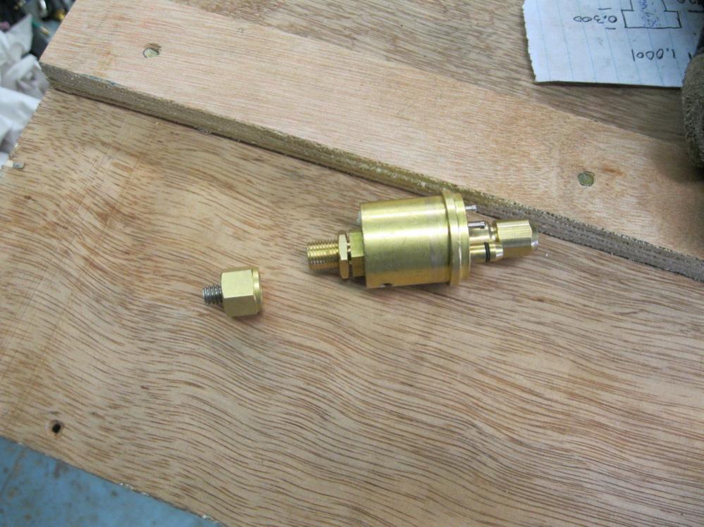

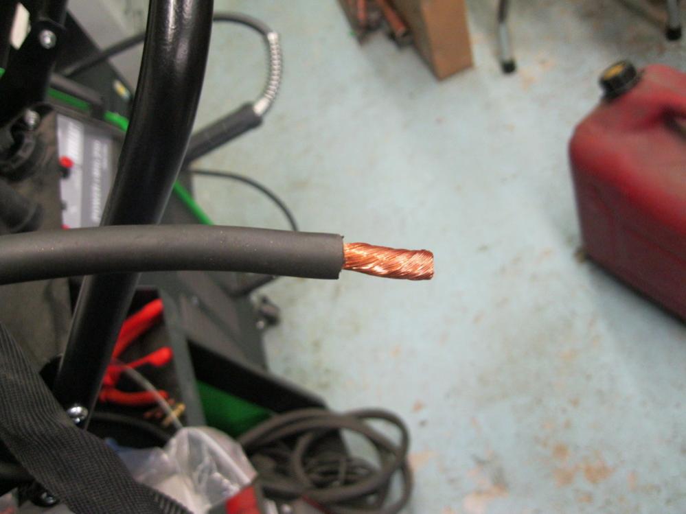

    I fitted a 30A to my MTS250S to use .045 wire and .062 it works just fine thanks to Yofish to tell me which 30A to buy. Cut the end off the power and put it on to the EURO end just and a brass fitting to join then together. Cut the plug off and rewired it to the MTS250S plug. Set the welder to old spec's and did a test run adjusted the setting and welded heaver aluminum come out just fine and the gun did not even get hot.
Name:	30A end cut off for new end EURO 1.jpg
ID:	12177Click image for larger version.
Name:	30A end cut off for new end EURO 2.jpg
ID:	12178Click image for larger version.
Name:	30A end cut off for new end EURO.jpg
ID:	12179Click image for larger version.
Name:	30A end cut off.jpg
ID:	12180Click image for larger version.
Name:	30A plug to MTS250S plug.jpg

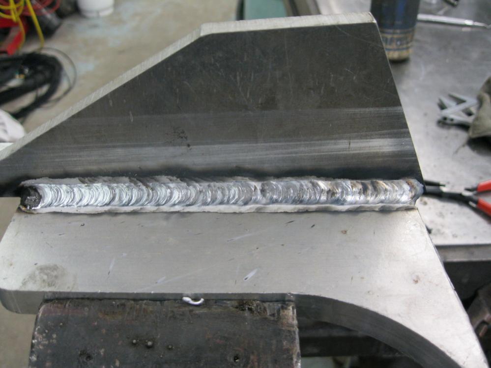

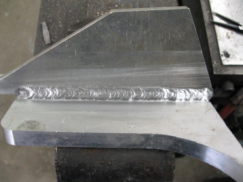

    First weld with 30A Spool Gun set on Synergic Spool, aluminum used 4043 .045
Name:	30A fitted with EURO for MTS250S first test weld.jpg

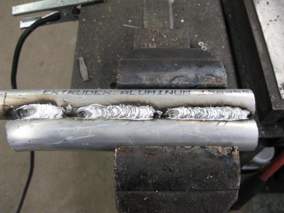

    Second weld with voltage up 1.5V
Name:	30A fitted with EURO for MTS250S second test weld.jpg
    Cleaned with wire brush.
Name:	30A fitted with EURO for MTS250S second test weld wire brushed..jpg

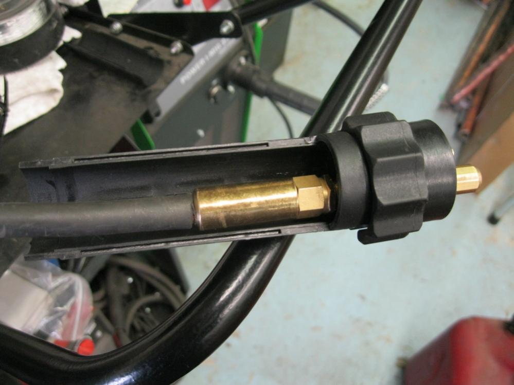

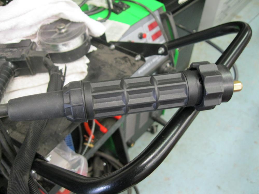

    Final fit of EURO handle and 30A spool gun.
Name:	30A end cut off for new end EURO 3.jpg
ID:	12185Click image for larger version.
Name:	30A end cut off for new end EURO 4.jpg
ID:	12186Click image for larger version.
Name:	30A end cut off for new end EURO 5.jpg
ID:	12187Click image for larger version.
Name:	30A end cut off for new end EURO 6.jpg

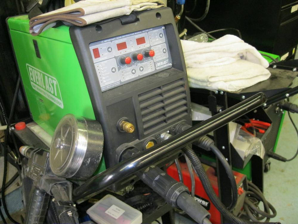

    I used the original gas fitting and got a Y manifold with shut off valves on it. One is for the 30A and the other for the welder at the back for the Tig and Mig. Spool gun has 30 foot line can go a long way around the shop.
Name:	30A fitted with EURO for MTS250S Y for gas.jpg
ID:	12189Click image for larger version.
Name:	30A fitted with EURO for MTS250S.jpg

    This was a good fine for $300.00 the 30A is so smooth and it did not even get hot at 220A and 25V welding aluminum for 10 minutes yesterday forgot to take picture's of the job. The MTS250S ran like a dream.

    The MTS250S uses the wire speed on the gun and it is a 10K pot and the MTS250S uses a 10K pot to run the SM200 Spool Gun on the side of it. The 30A was a very ease hookup just had to get the wires diagram for both and rewire the plug and put the power line on the Euro connector. If you need the wiring diagrams I have them.
