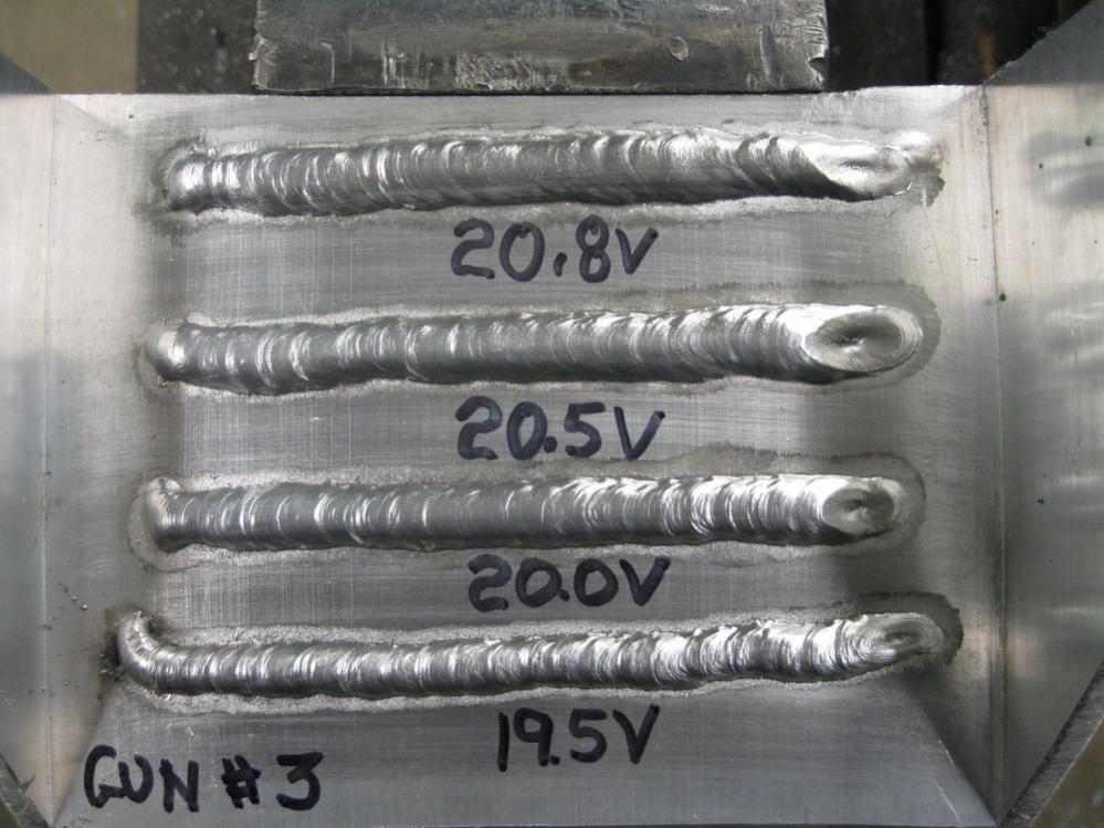

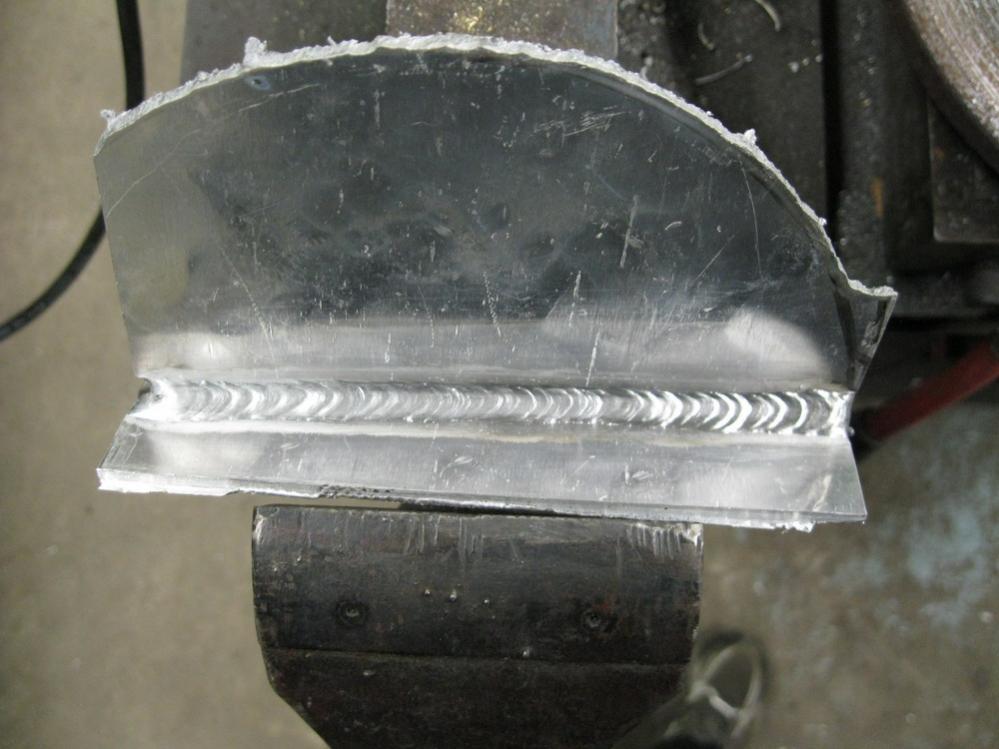

    Test new settings to gun tip and voltage to wire speed on gun suggested by Yofish just need more practices to get it closer keeping notes. All welds are working in spray mode no splatter the welding material is .125 aluminum plate.

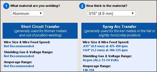

    Kempy, you've got it! Now it's just a matter of technique. You will find as you proceed that many times all the 'control' you will do is adjusting wire speed for the differing welding positions encountered. For example, on a skiff I'm building right now I could show you a flat lap, a flat butt, a lap vertical up, a lap down and a fillet within a foot of one another all done by adjusting the wire only. BTW, according to Miller, you're not 'spraying' because the voltage is too low!

    If it is not in Spray Arc Transfer i have no splatter and it is welding with good heat and very little black smoke on the work pieces what do they call in-between Spray Arc Transfer and Short Circuit Transfer a nice welded

    Ha ha, do you really want to go there? If I answer, it will only be pointed out that I don't know what I'm talking about. I want to tell you this, it has been a pleasure to give you some small help in your quest which appears to be a success. There is satisfaction for me in that. I like what you're doing with the tests, most don't do that, and suggest you go up the volts and up and down with the wire until you get the welds that are right for you. There are no set this-is-the-way-it-is rules. Also, aluminum is not steel. And what you know about steel does not apply to AL. Kevin bailed on those discussions when the videos (on steel) that were offered as examples of arc forms because, as he told me, it wasn't worth the effort. Hey, the guy has only built 200 boats, WTF does he know anyway?
    Here is what Miller says you're 'sposed to do and good luck with it as your unerring guide. I use many times, the wonderful Gershwin line from his Porgy and Bess opera, "The things that you're are liable, to read in the Bible, they ain't necessarily so." Now, having said that I won't deny that these settings will not work. It's the times that they don't, for numerous reasons, that make them to be taken lightly:
