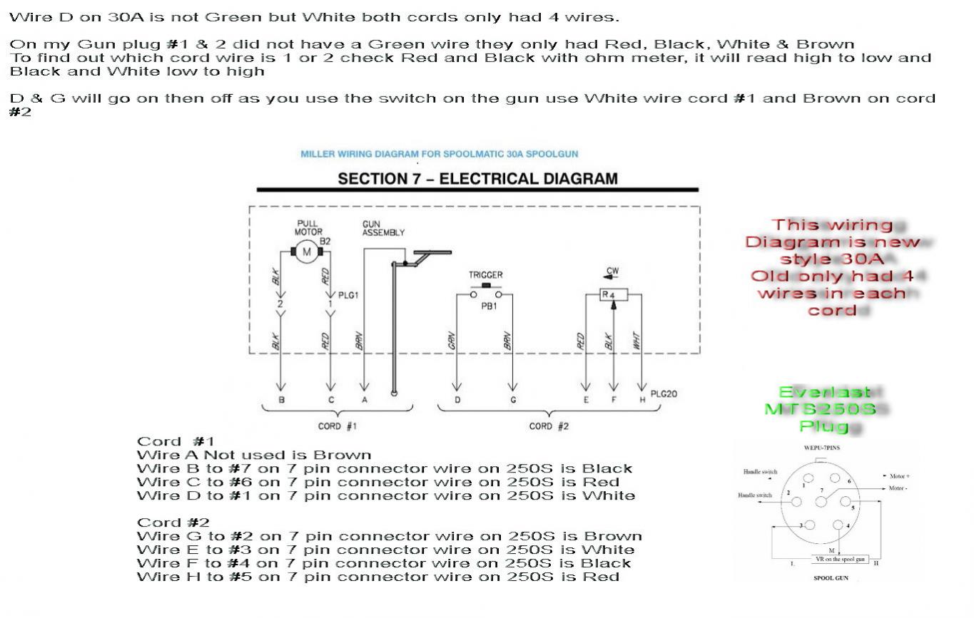

    This the wiring diagram to convert the 30A 8 wires 10 pin connector plug to fit the MTS250S (Canadian model) that I have with a 7 pin connector with 7 wires only.
    I don't no if any of the other MTS's use the same set up maybe the 200 does because it is in the same manual.

    Thanks for the diagram. I have it saved in my documents.

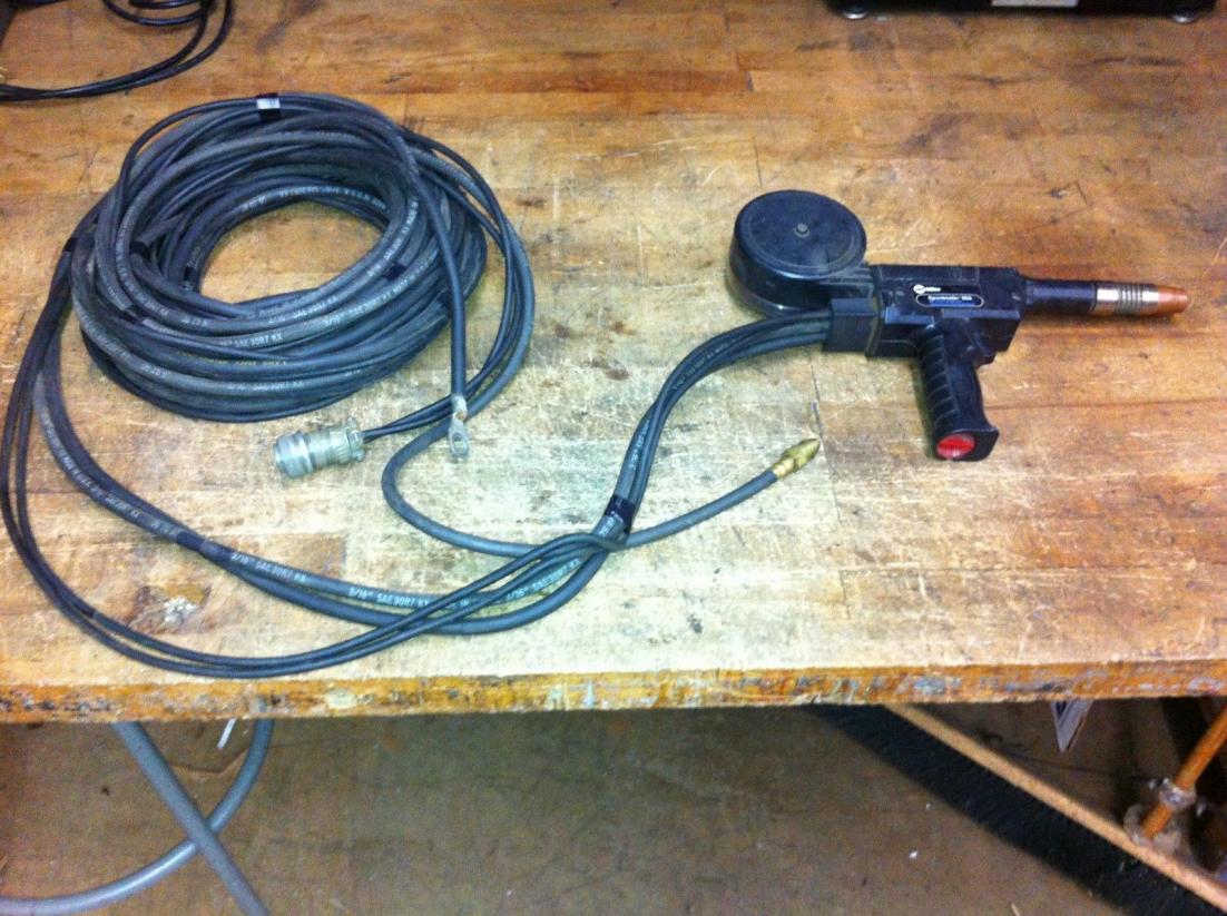

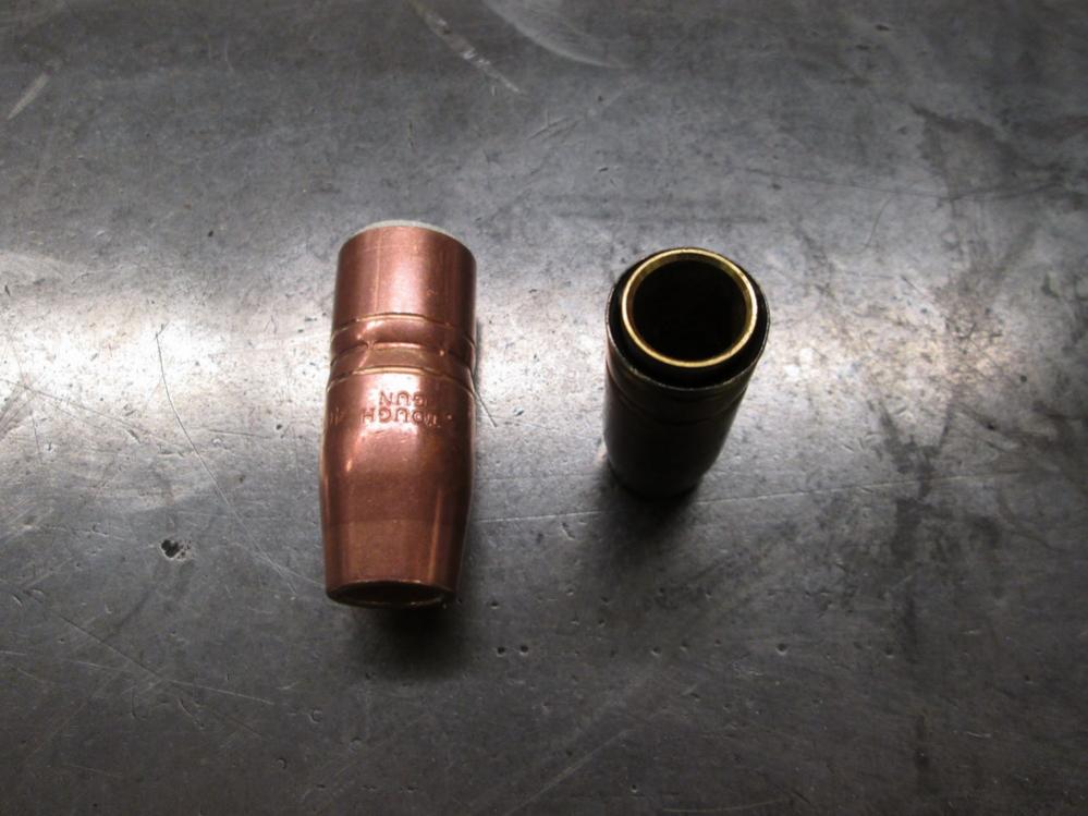

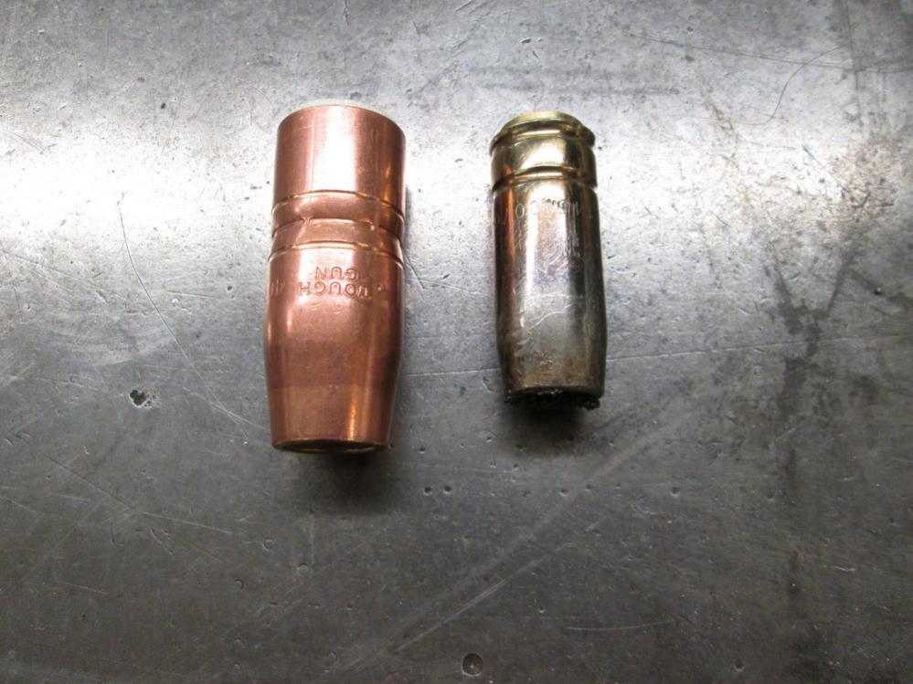

    I have two SM200-N and the power wire are not even close to the 1/0 that the 30A has, 100% duty cycle at 200 amps. The SM200-N works fine but not when I was welding all day with it, it just got to hot and the cup with the insulator in it would burn up had to put a new cup on every day so I made a Tough Gun cup fit it now no problems heating the cup up not a chance now, use them on the 25 Mig gun also got over 20 of them and other cup also.
Name:	Tough Gun 1 and 200.jpg
ID:	12193Click image for larger version.

    I have to retracked my statement about the 30A not being sold new any more. I went to the Blue site and they are making the pro 30A . I have not looked at new spool guns for a while. Last I new they had stopped making it. Well that tells you something about how good of a gun it is. They put it back in production for a reason. Sales . Its been around for a long time now with just minor improvements. Don't look at the price though unless your sitting down and have a strong heart.

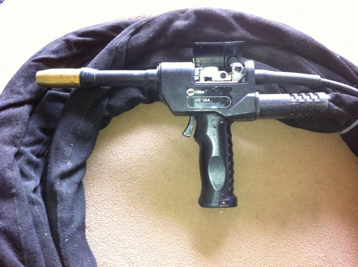

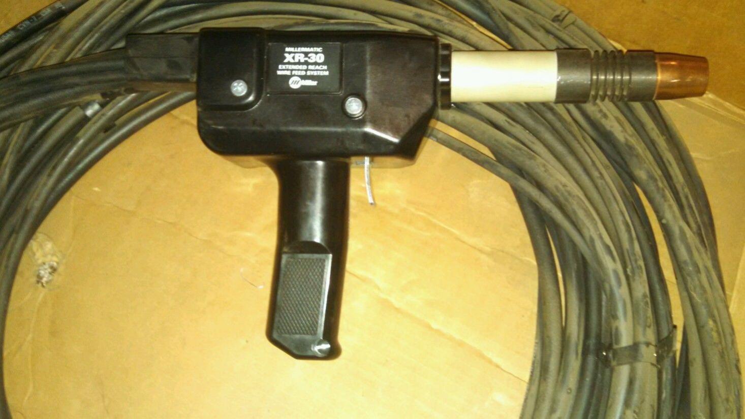

    Gary, Miller has never stopped producing a version of the XR line since the 80's. Here is a picture of the first one I owned. It was strictly a push-pull affair (no detachable spool) mated to their new XR box. The first ones used the same long contact tips as the Spoolmatic, Airo etc. did.
    When the so-called second generation gun came out they intelligently added the spool housing thus getting a twofer; a spool gun and a push-pull. Also, the 1st gen could be retroed with the new shorter contact tip that was held by a collet/diffuser. You can tell if you have an early or late 2nd gen gun by the Amphenol; metal at the beginning and plastic at the end. Also, the early ones did not have serial numbers on sticker. The 1st gen had a clear plastic cover over the drive mechanism that had a knurled screw that held it and the 2nd gen had cover that retracts against a copper spring. Few parts are interchangeable between the two.
    By the third generation they had ruined some of the good features of the second generation.
    Much as us boomers have over the 'Greatest Generation', of our fathers. In the third (turd), the genius's at Miller decided that operators didn't know what was the proper relationship of the contact tip vis a vis to the gas cup (in or out) and therefore 'fixed' that relationship as a constant. Also, they came up with the clever idea of the 'FasTip' . The contact tip now screws into the diffuser with a high pitched thread. Only problem is when you fry a tip (ever done that?) one has to unscrew the tip after removing the cup by holding on to it with pliers and then rotate the gun! Now, if that isn't an example of need-to-find-something-to-fix-that-really-doesn't-need-fixing engineers at work nothing ever will be. More often than not, the wire breaks inside the tip therefore ruining any chance to recover usage, good job engineers, double down! For some reason they replaced the teflon liner with a bronze coil and you can imagine what that does over time when running AL. I replace them with the old teflon as they fit. The cup is thinner and has a fiber shield that (IMO) causes excessive heat to build at the tip. I have used all of these guns extensively and loath the last version. Two to one easily, I've fried more tips with the turd-gen guns, especially with .035 wire. Stuff happens, but this winter I built a power skiff using a spanking new 252 Miller with a 30A in some elses shop and had to bring my 2nd gen in to finish the job because the drive motor in his went out. Numerous parts are interchangeable between two gen and three gen. They both have extensive additions that make them adaptable; curved barrels and even a 'long dong silver' 12" flex barrel that is wonderful for doing whacky welds or overhead.
    I've used a lot of MK products and don't like the Cobra but like the Prince except for the gas cups being so narrow and getting 'boogered' too quickly. Zero experience with Lincoln though I'd love to try their magnum XL250 out. They just don't exist in my part of the world.
    EDIT: Oh, another really good feature of the last gens of the 30A is that the spool canister can rotate right and left which is huge, believe it or not, in it's ability to adapt. I don't think any other spool gun has this feature.

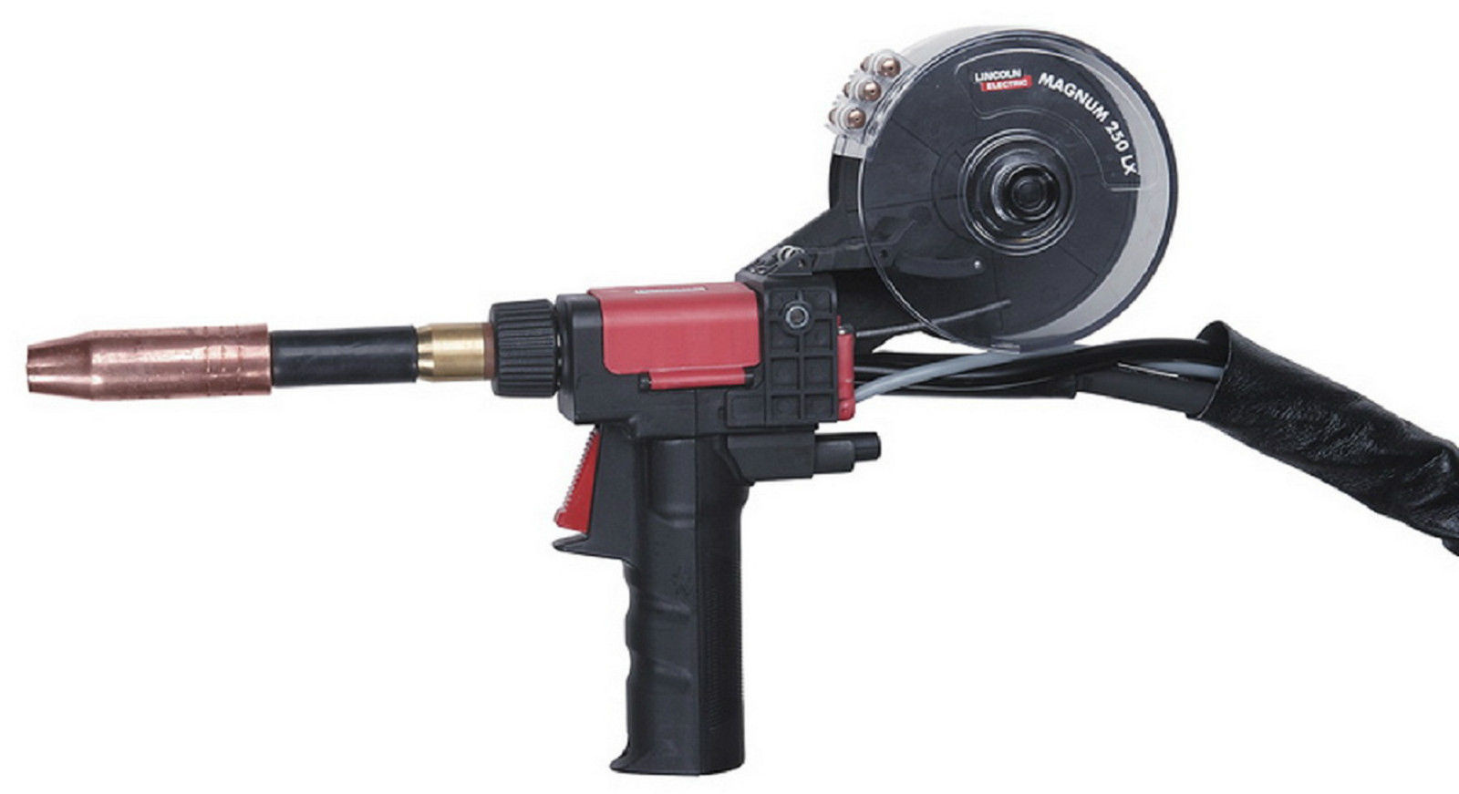

    I went over to the red site and looked at the 250 magnum. It almost looks like a spitting image of the HTP spool gun. I would not be surprised if HTP makes it for them or visa versa.

    Gary, I was talking about this one:

    I agree about the HTP-Lincoln connection. As I've stated, I have no hands-on knowledge but the thing (I think) I see about the HTP gun is that it relies on spring tension against the drive roll to feed. That might not be an issue on a spool gun but it most certainly is push-pull which is the feature that interests me with the Lincoln. In its push-pull configuration they call it the Cougar. Boat building with a spool gun is a drag. I'd just like to try it out, don't think I'd ever buy one at this stage of my career.

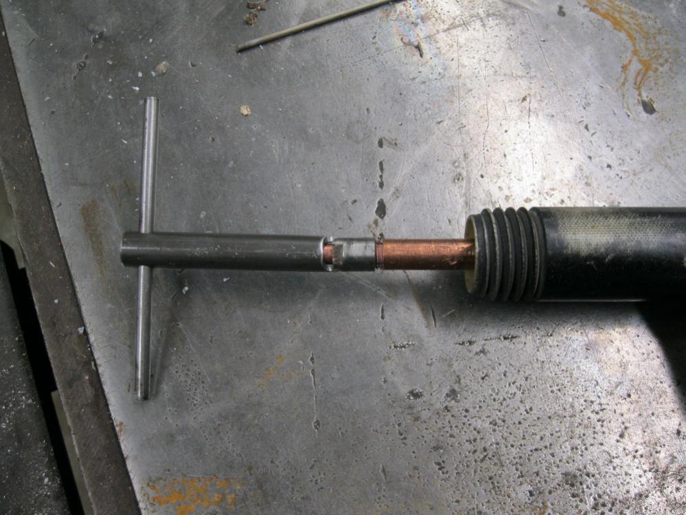

    As you were saying they make a good tool then change it plus it cost more and it is normal is not as good.

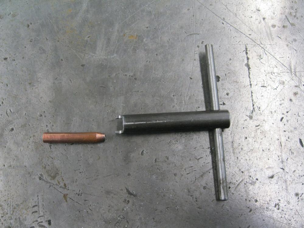

    I like the 30A old style as you recommended to look for with the barrel that you can adjust and the tip you can do also had to make the tool for tip removal myself cheaper then buying one.
Name:	home made tip wrinch 30A.jpg

    Love it! Any time someone works around 'The Man' I like it. I spent a lot of time to try and come up with a replacement for their drive motor which is obscenely priced, only to find out that the company that makes them sells them only to Miller. Being a DC motor they would be easily rebuildable but not possible because you can't get parts.
