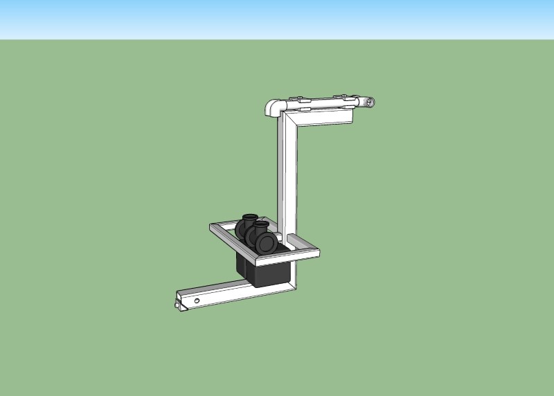

Here is the second of two hitch mounted boomless sprayers. First a model was made.
Then cut up all the pieces, and prep for welds. Still happy with the Northern corner clamps. Someday I have a few changes I want to make, though. I few gratuitous weld shots. All TIG and all with the 140ST
