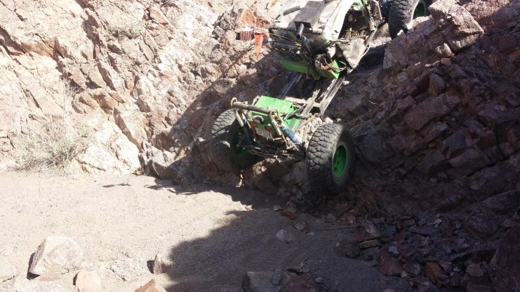

    Spent some time in Arizona this winter with a good friend from Nebraska, He Stays all winter and goes all over the southwest rock crawling. This waterfall at the end of a canyon had never been climbed and we verified that as there was a tree in the middle of the top and lots of cactus after he went up it. I tried with a friend in another machine but we kept trying to tip over backwards as the front tires could not break over the top
    A couple of pics of him going up and over. We climbed up that face and believe me it was steep.Click image for larger version.

    Pretty neat Rock Crawler, It has 1.7L VW Diesel hooked up to a 700R4 GM trans and a Rockwell transfer case, A couple of the neat things he does is the wheelbase and the shocks on the corners. The wheelbase will extend 30" on the fly, just by pulling the hydraulic lever. Also the shocks on all for corners are mounted to a hydraulic loaded bracket so you can apply pressure to each corner independently to get that traction you need and the shock will still function. He used to build a new machine each year but this one is going to go another year as 2 weeks ago when i was out in Western Nebraska he was working on it again. The wheelbase will now extend36" on the fly.
