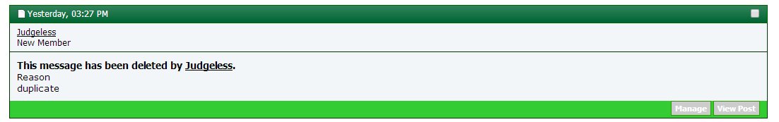

  10. #30
    Your posts haven't been deleted, not by me at least. Not sure which posts you are referring to.
    One post was deleted, but it was by the OP.
