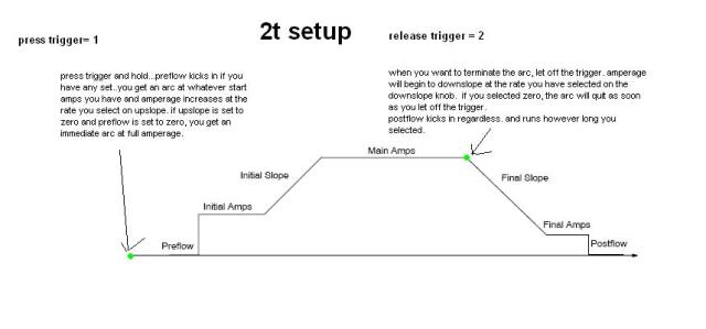

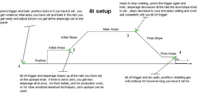

    Everlast has a different view of 2T and 4T then I do. This is what I expect.

    With 2T I would expect that I would have to hold the button the entire time and adjust the amps with another finger? Is that correct? This seems very difficult and I have not tried it.
    With 4T after I release the button I should be able to adjust the amps up or down using the rolling knob. Is this your view? It is not working on my unit.

    Try it. An inexperienced person may have difficulty... I don't have an issue personally. But it's easy enough to test by holding your finger on the button, and create a steady arc a fairly low amperage on a piece of metal, say 50 amps or so, not enough to melt it, and reach across and adjust the knob with the other. Or just hold it in your right hand while holding an arc and adjust it. YOU have tried it while welding correct? Don't look at the machine, look at the arc. Does the intensity change?
    But as usual here, you have not directly answered my questions. Your chart is immaterial, and you've not given me the answers to the questions I provided.
    Please post your direct questions and I will answer them. If those views of 2T and 4T are 1000% wrong please post how Everlast views 2T and 4T so we are on the same page.
    You claim in 2T mode this is possible. As soon as you release the button it stops, so you have to have one finger on the button at all times in 2T mode. This seems crazy to me as a right handed person, along with 90% of the right handed people in the world. Are you saying you push the button with my thumb and somehow use one of the other fingers to turn the knob? Please post a YouTube video of you doing this? This seems close to impossible.

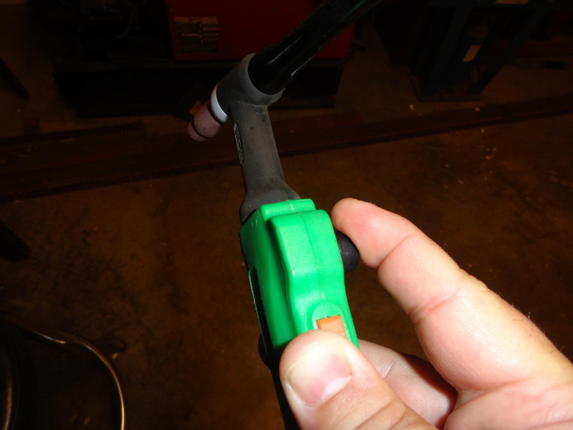

    Again, it takes practice just like feeding rod. I use a reverse grip in many places, and at 6'2", my hand is large enough to grip and hold whatever I want. Thumb on switch, Index or middle on the knob. Or, a fore hand grip thumb/hand on switch, index or middle rolling the knob. Even if you cannot master it, you can hold the torch in one hand and steady/brace yourself, and turn the knob with the other hand well enough to determine if the pot is working in 2T.

    Just went out to take a picture to show you how "impossible" you are being. What I suggested is not impossible at all, and works fine...once again, I submit proof. First the reverse grip, Second the fore hand grip...and if that doesn't suit you, you can always put a 1/4 turn (or more) twist on the head by rotating it in the handle and "turn" the torch so handle rests differently while you are welding.
