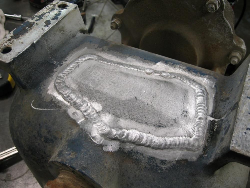

    I have both and I like the 250EX but use the 255EXT more mainly I like the memory part have it set for most of the welding I do just go thru the number till I get what I want and weld, no turning knobs or moving switches for the settings it is a little more money but it is worth it. If you are switching back and forth from thick aluminum to thin or to steel just have the preset number for what you want. I have used all the different wave forms and used Advance Square with Advance AC Pulse for some jobs it is different. Just welded a cast aluminum water pump with the 255EXT that broke over the winter and froze and blow the bottom out of it.
    Welded with 255EXT using Advance Square with Advance AC Pulse to keep heat from letting it crack worked just fine 4 separate welds let each one cool then welded again. Casting very dirty but not a show piece once back on the truck you can not see it.

    Looks good for being cast, wish I could try the 255 out fot a couple weeks
