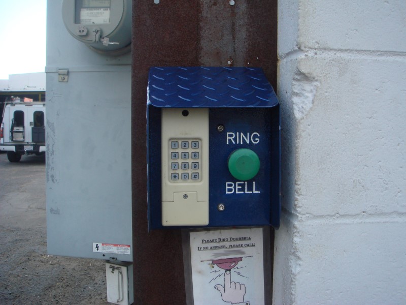

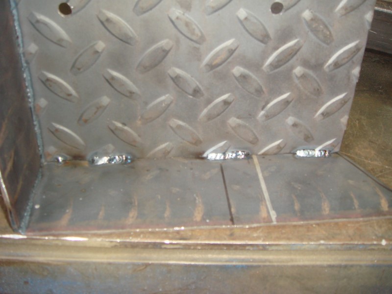

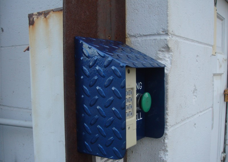

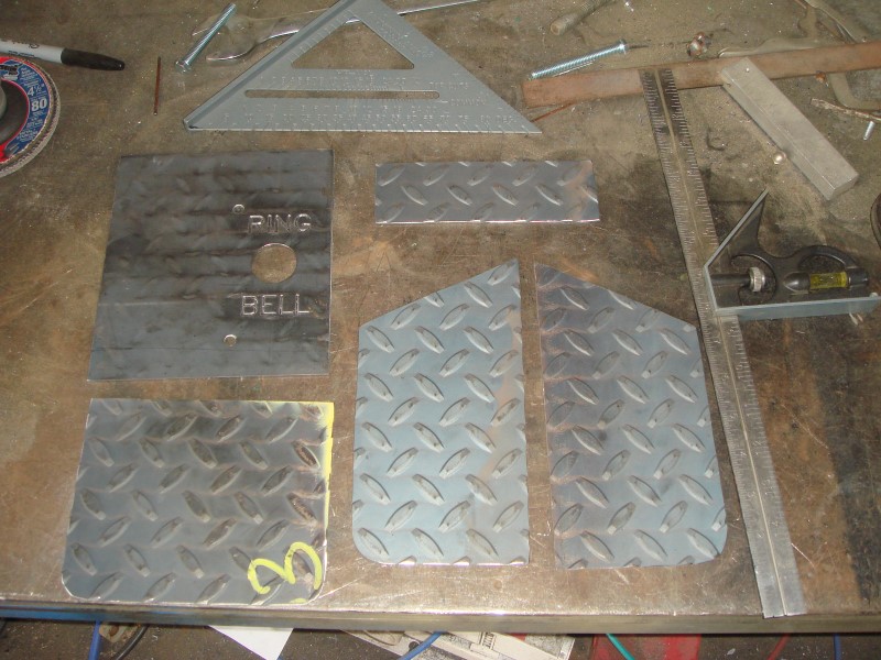

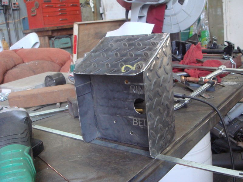

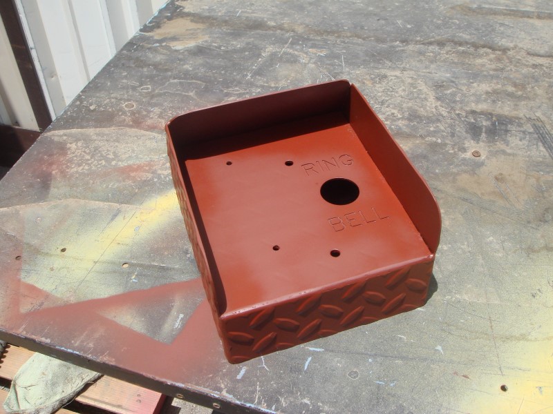

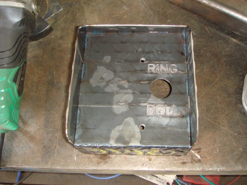

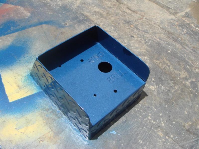

    Needed a tough enclosure for a new doorbell button and gate keypad. More than one delivery driver could't find the old one and would just drive away. So I wanted something that would stand out a little. I had some leftover 14ga. treadplate that was a good starting point.
    Cut out the pieces and did a little machine work, then TIG to assemble. Smooth, prime, paint, and install.
    Done deal.

    Nicely done.
    Is that how you got the RING BELL lettering, some milling?
    Nicely done.
    You got it.
    That turned out sweet! The added "RING BELL" detail should be hard for your delivery guy to miss.
