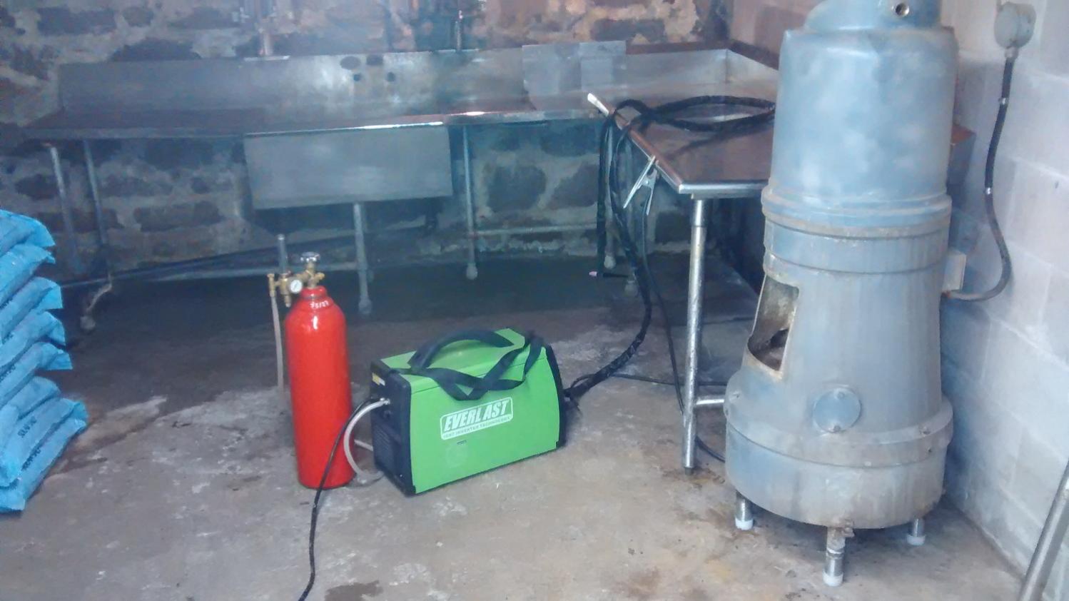

    Another job for my MTS250S one more like that and my machine will have paid for its self then I will be make good money with it as a portable machine. I do use it in the shop also but I did by it as a portable machine over my 400 lbs. Hobart.

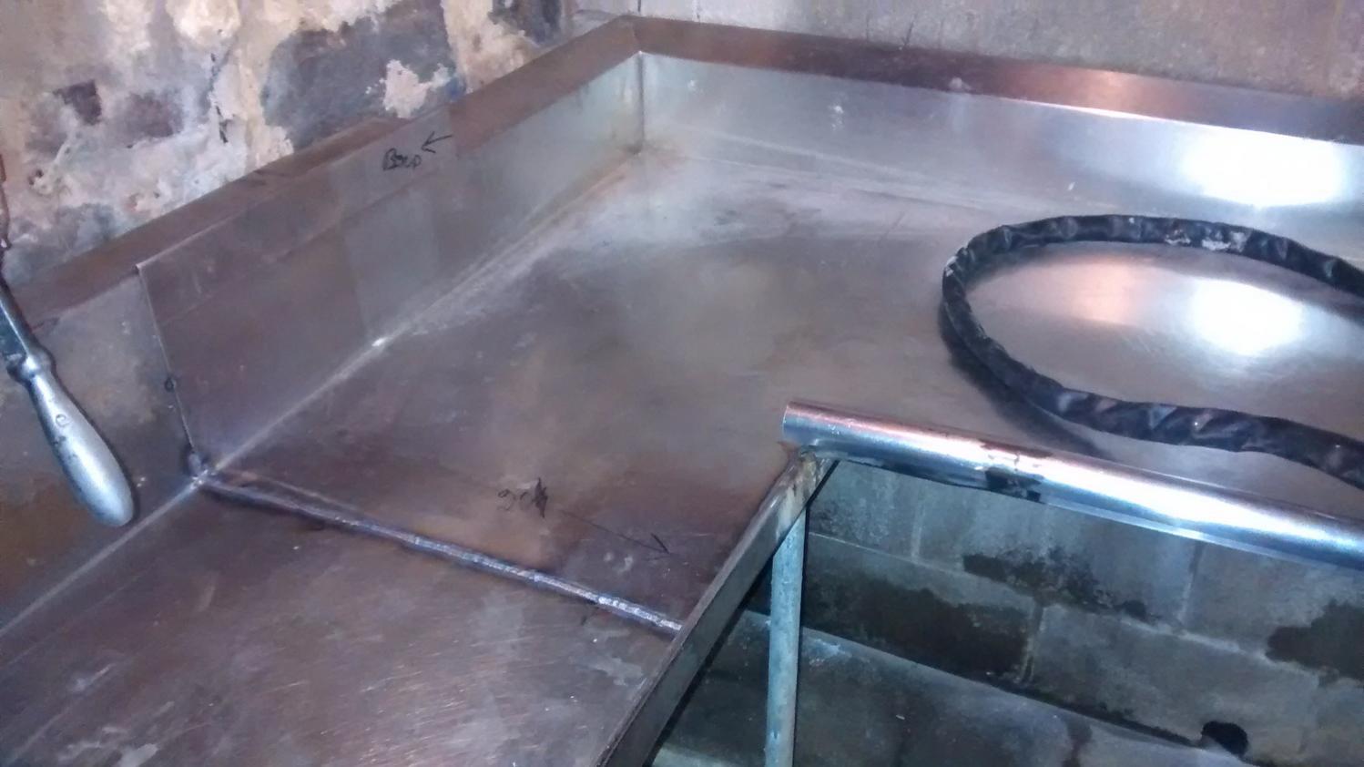

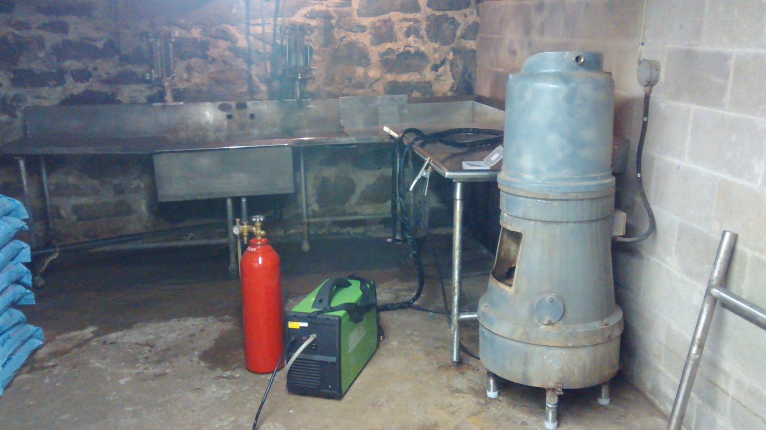

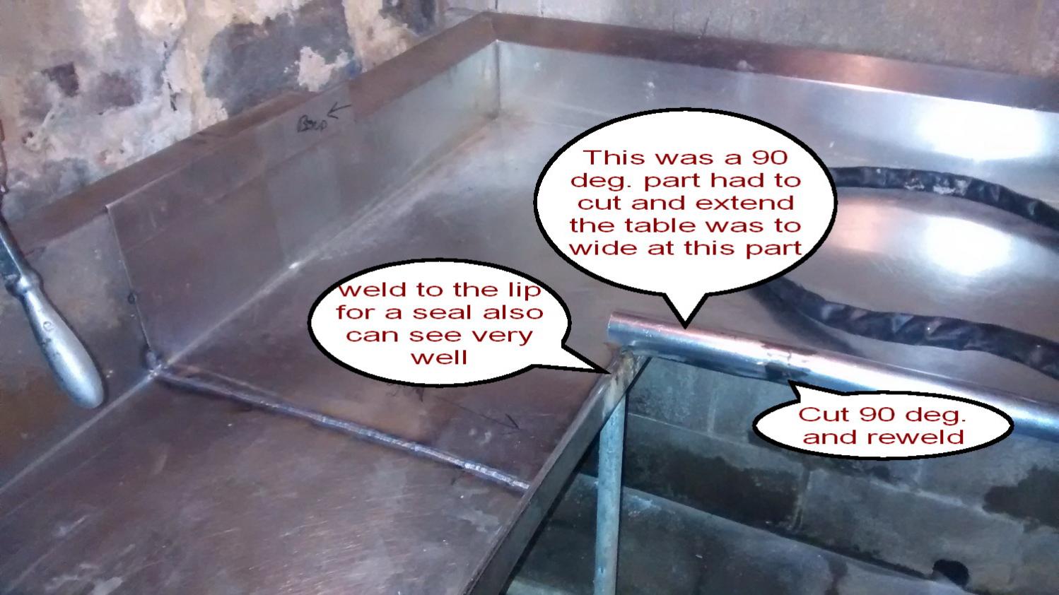

    My son took the pictures with his phone forgot my camera will go back some day and take them again. We had to take out a old wooden table with a galvanized top that fell apart after 27 years. the work was done in the basement with a 5 FT 6 inch head room the building was built in 1876 it is now a restaurant they wanted to fix the table by adding a table top from the kitchen when it was revamped. Got out my MTS250S and a small tank used the adapter I made to fit most anything to the dryer outlet and welded up the top to the other top added wall clips to hook under the splash lip to hold it to the block wall welded longer legs to the potato peeler they were very rusty cut the rusty part off and add some SST tube to it and plastic feet to sit on the floor.

    Did you tig weld the lap joint ?
    Looks Nice Kempy
    EverLast 140ST
    PowerPlasma 50
    No You Can't Use Them
    Yes I did to stop the water from running under the two tables tops. Had to weld the vertical part where the big lip is and in the corner were the two meet.

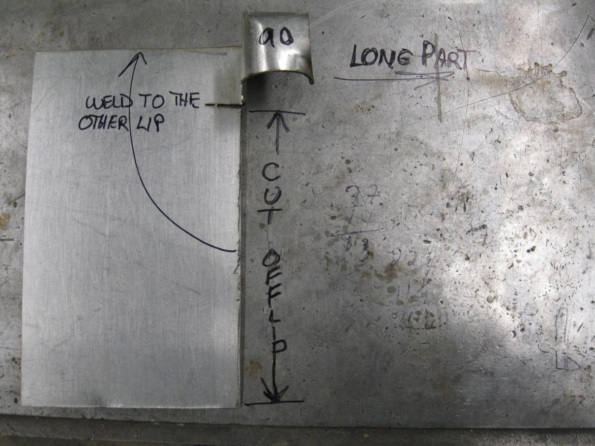

    This is the part I cut off and used part of the lip to extend the main part to fit to the other table.
