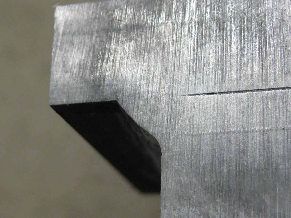

    Are you going to cut and etch it to check penetration ?
    this is the test piece cut with the saw.

    Thank you for sharing. What thickness is the steel and how do you rate the penetration ?

    Yes, that is shallow...not as good as it should be with a mix...

    I would add CO2. The depth is not the great. Marks like C18, but you need CO2 either way. We use Stargon or C25.
    It was 3/4" welded to 1 1/4" steel plate with no preheat or bevel cuts. I will try some mix gas I have 25% Co2 / 75% Argon in a small bottle.
    kempy, certainly not a 'sloppy' weld. As I've said, I'm not a steel guy but there is nothing inferior about a weld that has that kind of root penetration. Root penetration is root penetration. The AWS doesn't say much about it because it's not easily measurable like the leg or face of a weld.
    AWS D14.3-94, paragraph 2.3.1.1, reads as follows:“Design values based on depth of penetration or effective throat, or both, which are beyond the root of the joint shall only be used when the values have been determined from a significant number of cross-sectioned samples which reflect the range of materials, material thickness, and welding conditions.”
    Imagine a spec'd 1" fillet weld - it wouldn't have any more 'root penetration' because that would be accomplished on the first pass at the root!
    Of course, it is a 'good thing' to have adequate root penetration but not in the sacrifice of other things.

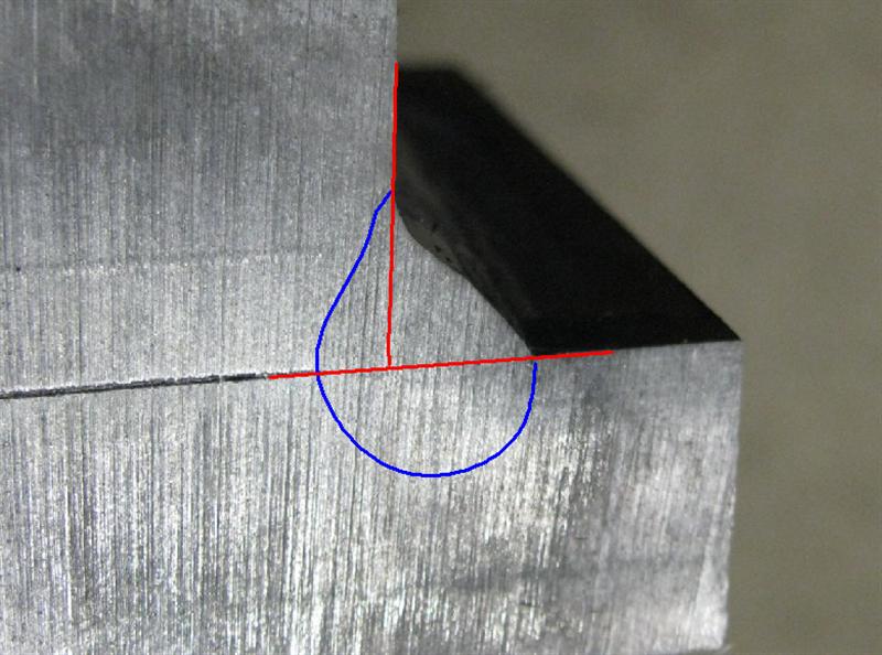

    Here is your weld that I drew over because the outline of the weld is fairly easy to see:

    YOU'RE HIRED! Nothing wrong with this weld! Everyone has a way of getting to an end. Obviously, you made a nice appearing and sound weld. You learned from the experience, that's something to build on and expand. Listening to people tell you 'the best way' to do things is in the end, limiting.

    You also need to learn to read what was said more accurately. I didn't say the weld was sloppy. I said when you spray weld with 100% Argon, the puddle is sloppy wet compared to a proper Argon mix designed for spray welding. This makes the weld uncontrollable and by comparison a shallow penetrating weld compared to standard spray. It makes a wider, more shallow weld. As one who makes spray welds on steel routinely and one not only has received informal and formal training in the process, I know the difference and have seen the difference trying not only pure argon, 75/25, 98/2, 90/10 and my favorite C/18. Due to the type of welding I do, about 75% of the time I am using a true spray transfer process.
    75/25 is NOT a true spray process. The voltage required to ionize the gas to create spray is too high and then you get issues. You can get a globular transfer, and/or a very uncontrollable spray that inconsistent and overly hot by comparison which creates a larger HAZ. People think it is spray until they use a real mix designed for it. The difference is significant.
