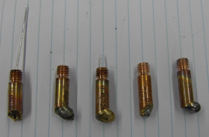

Name:	tips melted off volts too high.jpg
    This in synergic mode on the MTS250S the welds are in spray mode for aluminum and steel.

    If you use a higher Ar content, spray would be easier and more stable and controllable and you'd need less volts and with some fine tuning to inductance, you should be able to eliminate the tip melting issue. That means the wire is burning back faster than it is being fed...so increase wire speed, or reduce voltage. Inductance will change how fast the balls burn off the tip...or rather droplet size if I recall correctly. Threshold for true spray in steel is 80/20. I use a C18, which is 82/18 Ar/CO2. Most people recommend 85/15 or 90/10. I too don't have to turn my machine wide open. I have a 250 (270 amp max) esab and spray in the mid range with .035 with wire speed about 65%.

    Wowser! Something amiss by the looks of those tips for sure! When I look at the AL weld, it looks almost like too much wire for the volts. I am not a steel guy but that weld looks gorgeous. Are you welding the steel with the spool gun too? Are they both .035" wire? 4043 or 5356 filler on the AL? What flavor is the parent material in the AL?
    What happens when you turn off the synergic function (if you can)? FWIW, I never weld on anything above .250" AL without pre-heat unless I was in Arizona, outside, at noon, on a sunny day!
    I use .035 and .030 and some times .025 for thin to thicker steel, aluminum I use .030 and .035. .040 is just to heavy for the spool gun to push most of the time I use 4043 wire but with the Mig gun is will use 5356. If I do a lot of welding all over the place I will use the spool gun but heavy work I use the Mig gun it is a 15 foot one. Most of the aluminum I weld is .125 tubing and I use the spool gun when welding 1/4 up to 1/2 I use the spool gun also with 4043 .035 wire 95% argon 5% helium.
    Most of the time when the tips melt off the gun is getting very hot I need a bigger gun or a push pull.
    I do use the weld not in SYN mode but in Synergic mode it weld nicer it will adjust its self as you weld. I normal mode doing the same thickness of material it is OK.

    When I use higher argon mix the gun get very hot and burns the insulator out of the cup. I ordered a 26KD torch to see if that will help the 25AK is being push over its limit need to find a 300 Amp gun.

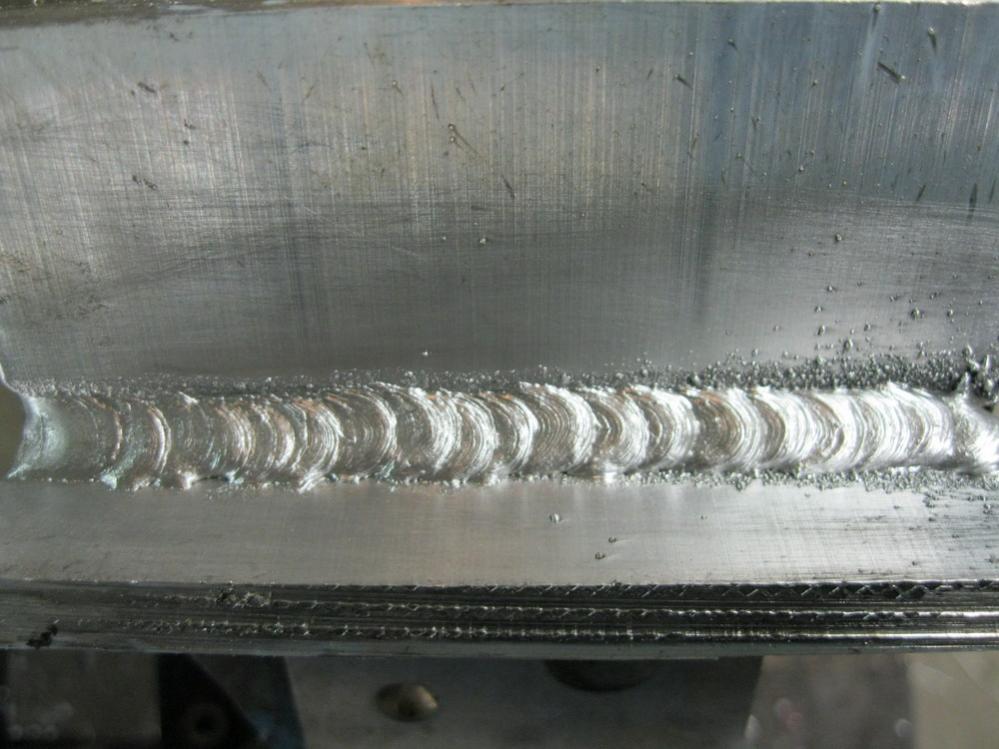

    Kempy, here is 3/8" 6061 done with the little welder. 22.5V, 210 wire. 3/64" wire, 5356 (it's the only filler alloy I ever use). I quit using mixed gas years ago as it wasn't worth the extra cost for the marginal benefit. For everyday frying I use 18- 20 cuft/hr 100% argon. The piece has been pre-heated to 200 degrees or so, to hot to touch but for a tap. I can't quite wrap my head around why your gun won't run .047 if it has that capability. The 30A has no problems running 1/16" wire. One thing I can tell you that the 30A won't do spray running .047" wire with an .052" tip. It will eventually burn back and weld to the tip if you're putting the stones to it, like doing a lot of thick material. Stepping up to a .061" tip solves that to a point. I think Push-pull would not solve the problem you have, with AL, anyway. The 30A is rated 100% @ 200A but one could never achieve that without water cooling. My point is, if you haven't already, try a big tip with .047" wire in your spool gun. Also, with the older so-called second generation 30A guns, one has the ability to adjust the tip stick-out. Thus on heavy stuff I stick her back inside to get more cooling from the gas shield around the tip. Not being familiar with your gun, I don't know if this applies.
    Another question I have is how many lin. feet of heavy AL do you weld before things go south?

    kempy, nothing unusual about the black soot (smut) when using 5356. It's from the magnesium in the wire that has a lower boiling point than aluminum; some of it it vaporizes out. It's worse on 6061-6063. You can crank up the Ar which will help. Also a little more radical 'push' angle helps too. When I look at the weld that was done (assuming preheat) at the settings I used it looks like too much wire and not enough volts. I'd go up a volt and down 5-10 on the wire and turn off the synergic function, maybe slow down a little and open up the weld. keep cranking down the wire until the edges thin out. That spatter is also something that's gonna happen more with 5356. That you can only go 1/4" before things get funky is not right.

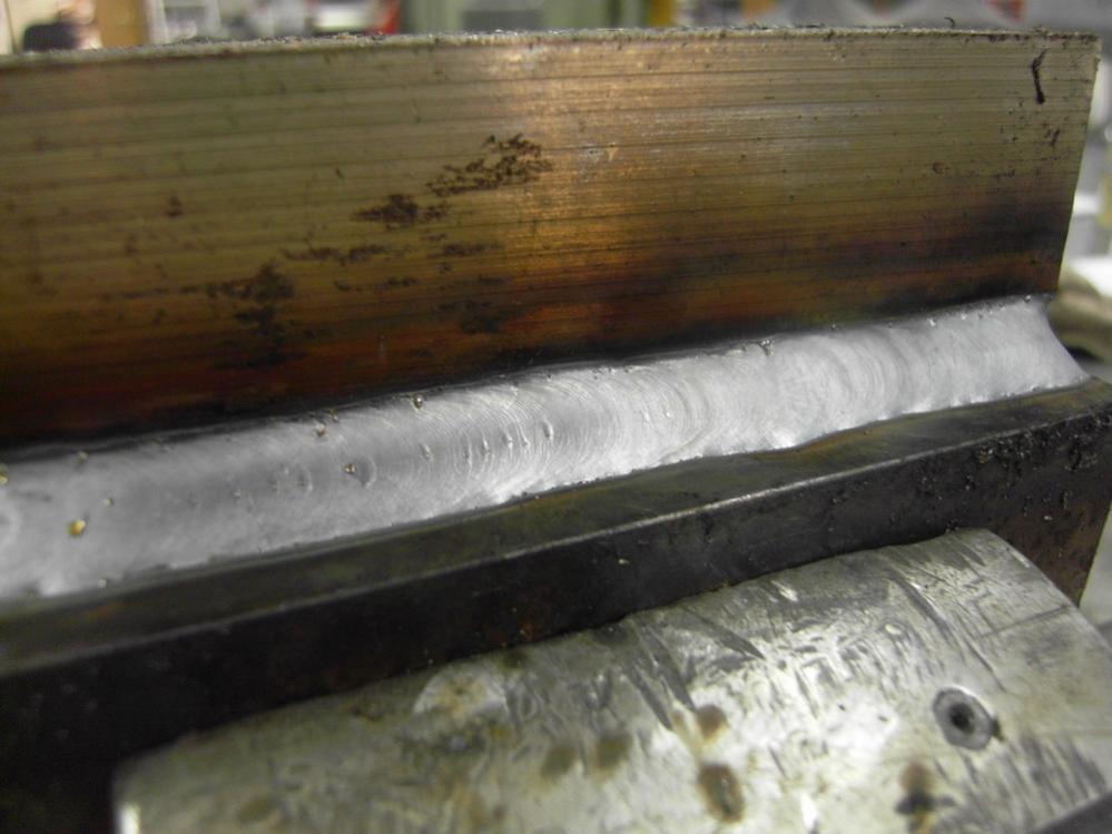

    Decided to try 100% argon and not mix gases like 25/75 or 15/85 or 10/90 just straight argon when weld steel with the MTS250S and it weld much better and it went into spray mode very easily using normal settings not SYN mode. Set to 23.5V , 212 wire and amps.

    Are you going to cut and etch it to check penetration ?
    Full Argon results in a wider, sloppier puddle and low penetration. That's why some CO2 or O2 is needed.
