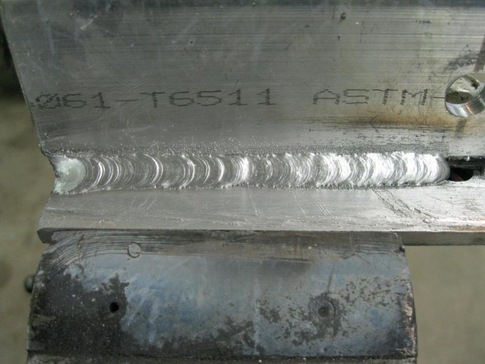

I tried 5356 .045 and the gun has a hard time with it I put in .035 5356 and had to put the setting up to 22.6V wire speed and amps 245 to get this weld but still black had to brush it.
Name:	5356 .035 wire.jpg
When using .035 4043 it will spray at the same settings but not be black, both using 100% Argon.
Name:	spray alum..jpg
When using .045 5356 same settings as yours it would work for about .25 of a inches and then slowed down then speed up making the weld not smooth.
