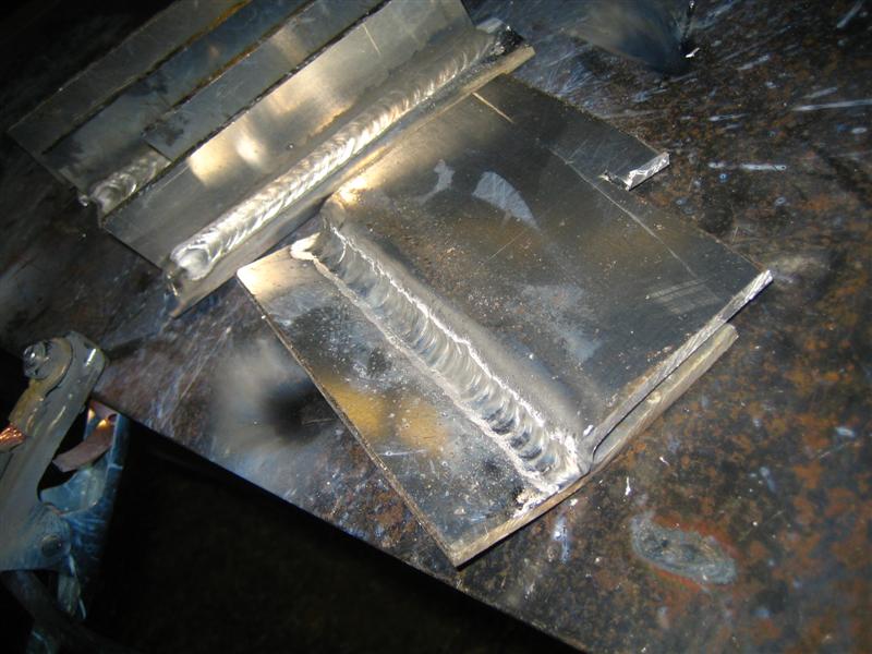

    So, after more messing around I came up with the minimums (for me) of what makes a reasonable weld with the little machine using the fewest resources. The first pic shows the weld with the machine set at 19.5 V and 185 mouse bites per minute on the wire and drawing between 146-151A, .047" 5356 wire on .190" material. The appearance isn't buttery, being short arc and therefore there are BB's and spatter but the puddle was nice and fluid, good cleaning, the penetration looked decent and the legs tied into the base material:
Name:	minimum (Medium).JPG
    Welded on one side only, I beat it over as far as I could on the anvil. The upper leg is just beginning to pull away from the base but under magnification it was tied in, it's not a cold lap. This is a pretty common failure you see in boats; the parent material alongside the weld (heat affected zone) lets go after uncontrolled flexures before the weld ever will. I'm pretty sure this was 5052, the scrap bin is not segregated but 5086 would have cracked more, I think. Anyway, the upsot is that I can live with the results and gain another 8-10% on the duty cycle, which is important. Notice the weld behind which was done at one and 1/2 more volt and 210 on the wire. Much nicer appearance but it drew up to 160+A.

    Looks very interesting. Could you measure the actual wire speed, just for a reference? Especially at the 210 setting, that looks really nice for times when you can spare the duty cycle, or on a wee bit larger machine.

    It will spray. At least mine will...but it is maxed out.
    Rambozo, I don't quite get your meaning of "measure actual wire speed"? As in pull the trigger, count to ten and measure the wire length? Yes, one can get some very nice appearing welds with this machine and it will certainly 'spray' but I have no attraction to spray per se because it is useless for what I'm trying to accomplish here. IMHO, this attraction to the Holy Grail of 'Spray Mode' is idiotic. One could certainly 'spray' the weld where a .125" deck intersects a .125" side plate on skiff but you would only do that once. The heat distortion would kill you. You wouldn't go 5' before you realized that you made a very, very big mistake. Not to mention the near impossibility of preventing some burn-through. Having said that, I have seen it done but only with a very fast no-weave weld that has dodgy penetration. At 65, arthritic and wearing trifocals, I ain't the machine I once was.
    You got it. I usually do a six second pull so I can multiply by 10 for inches per minute. I've never seen a machine with a true display for all circumstances, and with your mashup it would be nice to get a better feel for what the true wire speed you're using. Like you, I also usually add a voltmeter to get real output readings.
