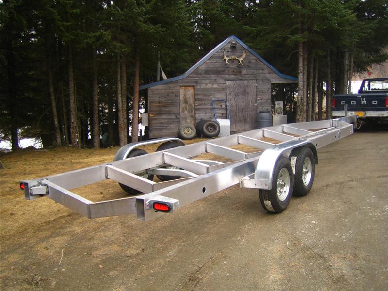

    I finished this trailer project for a friend that has a water taxi service:
Name:	bwolf (Medium).JPG
    The only interseting part of this project is that is the first time I've used torsion axles, provided by Pacific trailer, Chino, CA. The other I used the little bug sprayer unit some to get a better feel for it. Here is a series of welds that are completely acceptable to me:
Name:	vertup (Medium).JPG
    I didn't weld the whole of it with the Everlast, but given the weld sequence, I may have been able to. A good test is coming up soon. I have an interesting remodel on a power skiff next week which will be the first real test of the units abilities. I'll report.

    Yofish, that is a nice trailer you built and nice welding too is that the one you used the converted 30A to the Everlast welder on?
    Yes, the 30A. But only a little as I'm getting a feel for how far I can push the thing. It welds every bit as good as my Hobart. This was 1/4" wall tube material so I had the heat up, I'm sure at the upper limits of the machine. I didn't have anyone to read the amps. But when you think about it - you only have two 6" vert ups, a 3" flat and 3" overhead weld - the overhead done at a later time, not a lot of time spent per connection. The longest continuous weld was 44" where the tongue attaches; I'm sure it wouldn't have hacked that, done overhead in three shots per side stopping only to reposition. 88" total.

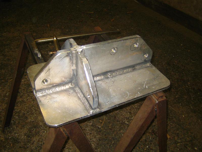

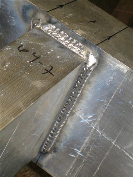

    For the heck of it, I tried the MiamiRatWelder on some heavy stuff. I tilted it once, the red light came on, so unless something else happens that would shut the machine off after a point, I guess one can assume that it cooks if you're not paying attention. This kind of welding is not the plan for the machine but I want to know its limits. This is a masthead out of 3/4" bar on 1/2" plate:
    Thanks for sharing...
    Were the edges beveled and did you pre-heat ?
    Did you weld it all in one go or were there breaks ?
    No bevel. As shown, the assembly is upside down and will socket into a mast that is slotted to receive it. YES! I nearly always pre-heat anything over 1/4" for starters. I did not time the welds but I did not 'go for it' and stopped in between. No weld was over 6" long. 23V and 230 rat bites per min. on the wire.
