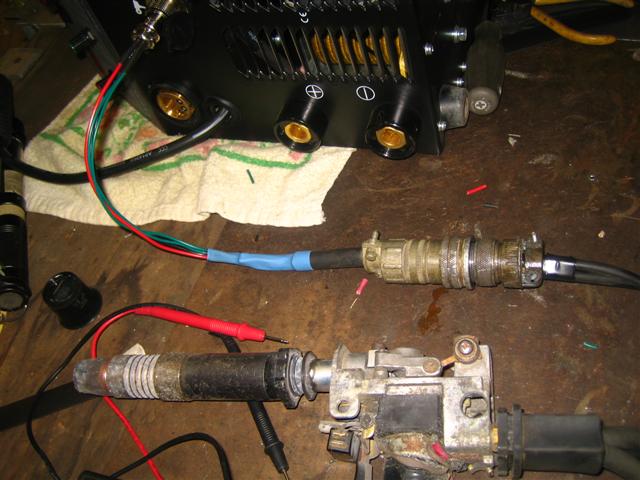

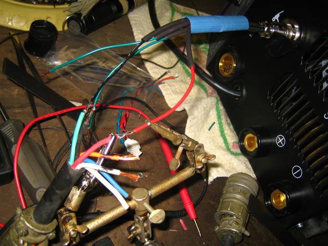

    So, I rethought a little and and after not finding the switch I wanted I decided to run what I brung. I have an Miller adaptor that made the so called 'second generation' XR gun work with the 1st generation XR feeder. I whacked it in half (gag) to make the connection between the 30A and the IMig pin connector. First, I removed the male connector from the IMig and removed all the wires and replaced them with 18ga wire to do the two functions of energizing the weld power and provide power to the drive motor. Only four lines needed.
Name:	plug (Small).JPG

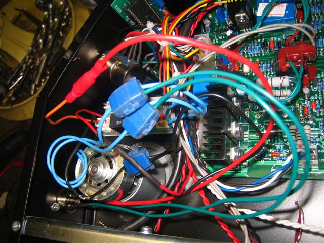

    After reinstalling it, I butt into various wires to make appropriate connects:
Name:	butts (Small).JPG
    Then I built the adapter. In my little burg there was no four conductor wire so I just used 18ga hook-up wire and helping hands:
Name:	hands (Small).JPG
    After soldering and heatshrink, we have the completed adapter. I'll wrap it later. Notice funky 30A; that is the very unit that went swimming in 1988. Pretty dodgy but still cranks wire, sort of:
Name:	adapt (Small).JPG

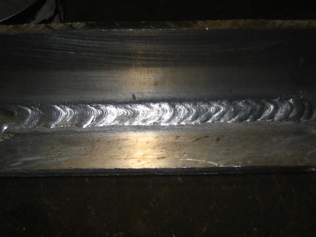

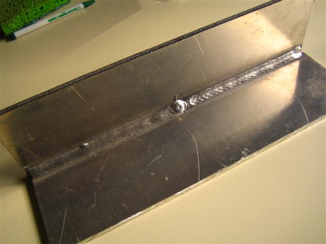

    And so here we have the 1st weld on .190" with .035" wire. Machine set @ 21.5V and I'm told it read between 140-150A. The only issue is that the wire speed is cranked almost full open. I was worried about that because I only got 15+ on the VOM and I know the Miller WC-24 puts out 24. But it works! If I'm not happy with the wire output, I can use a WC-24 and a PSA-2 that I have. I was wishfully hoping for an 'all-in-one' solution. Even with these additional appurtenances, it is still handier than anything I have.
Name:	1st (Small).JPG
    I'm pretty sure that I can make this work for what I intended. I'll play around with it tomorrow using .030, 3/64" and differing settings.
    I briefly looked at some of the later comments and will pass on commenting other than yes, salmon DO, indeed, swim upstream and I do love Alaska and all us hicks.

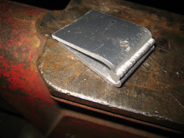

    BTW, is this a bend test?
Name:	bend (Small).JPG
    I build a lot of fuel tanks. Again, this is .100" (I thought 5052 but on bending it it looks more like 5086 by the stretch marks) welded the dreaded short arc method. Tomorrow I'll get out the 'scope and take some close-ups. Of course, if one could weld the inside you'd remove the hickie penetration but who welds the inside of a fuel tank when you can this root outside in? I've never had a weld on a tank fail. I wish I could say that about other welds.

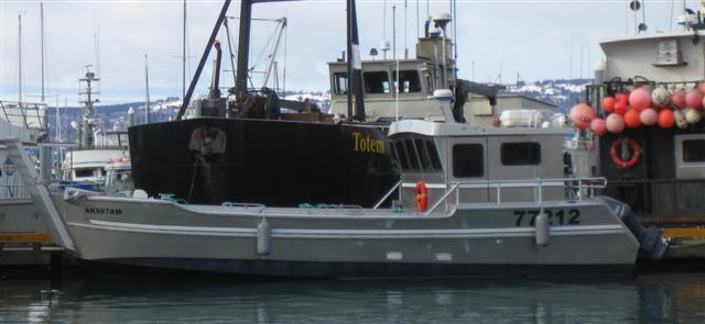

    kempy, I do mostly pretty good sized stuff. here is a pic of one of my latest completed projects - a 40' landingcraft:

    The hardest weld on boat like this in terms of the pressure put on the gun is the chine. You've got about 100' of corner-to-corner weld, in this case .190 against .250" material that once you start you don't want stop because you're heating the hull up nicely as you move along and want to take advantage of that blessed pre-heat energy. I can do about 12" before I'm too far out of position; I'll stop, cut out the end with a die grinder and a carbide burr then start again. When the gun overheats I stick the barrel in a coffee can full of water for about 5 seconds; remove and wait about 30 more secs then go. The trick is not to over do the dunk otherwise the residual moisture isn't too cool, to make a pun. Works like a charm, try it. And thanks for the kind comments.

    I do mostly pretty good sized stuff. Here is a pic of one of my latest completed projects - a 40' landingcraft:
    Did you build the entire boat or just modify/repair ?

    Thank you, zoama. I will dig up some other pics for you. I design my boats using ProSurf, a surface modeling program that is remarkable. All the major parts in this vessel were cut out on Alaskan Copper & Brasses' 50X10 ft router table. The bottom plates are continuous 38 ft long X 8 ft wide, two each. There is 11k pounds of aluminum and about a 140 pounds of wire in her. It was for a customer that does a lot of work with the local electric utility. I live in a marine environment and the grid is spread around a bay.

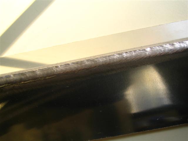

    On to the topic. I set up the machine with .047"wire and got much better results. The larger wire allows for lower wire speed. Here are two pics of an outside corner and inside fillet as I would do a chine, 12" long test:
Name:	outrernal (Small).JPG
ID:	11967Click image for larger version.
Name:	internal (Small).JPG
    They are not good pictures or particularly good welds but I'm thrilled by the results because both welds were done at the setting LOWER (20.5V out and 21.1V inside) than I use on my other equipment and are way hotter, too hot. That means I have more leeway. The upshot is that I think I've accomplished what I set out to achieve, just in time for a small job across the bay, boat only transport.

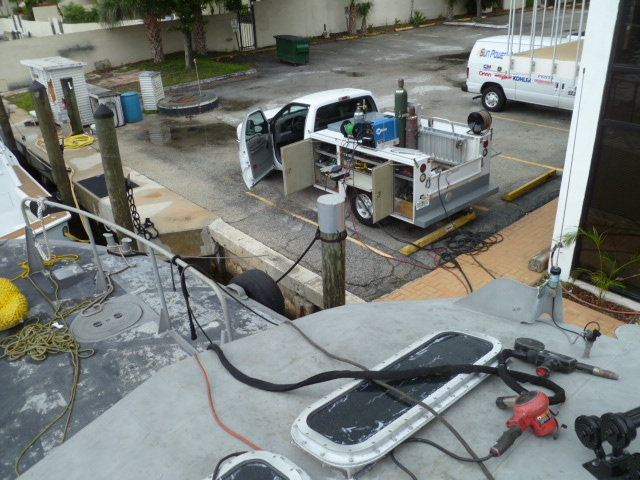

    here is a photo of the dockside setup I use when there is shore power which there nearly always is because most boats of size require it. (you don't want to go near the little ones...no money).
    I also have a complete rig on a trailer and a couple of inverters; 250EX being one. if you were to show up down here with that wacky setup you would be laughed off the job.

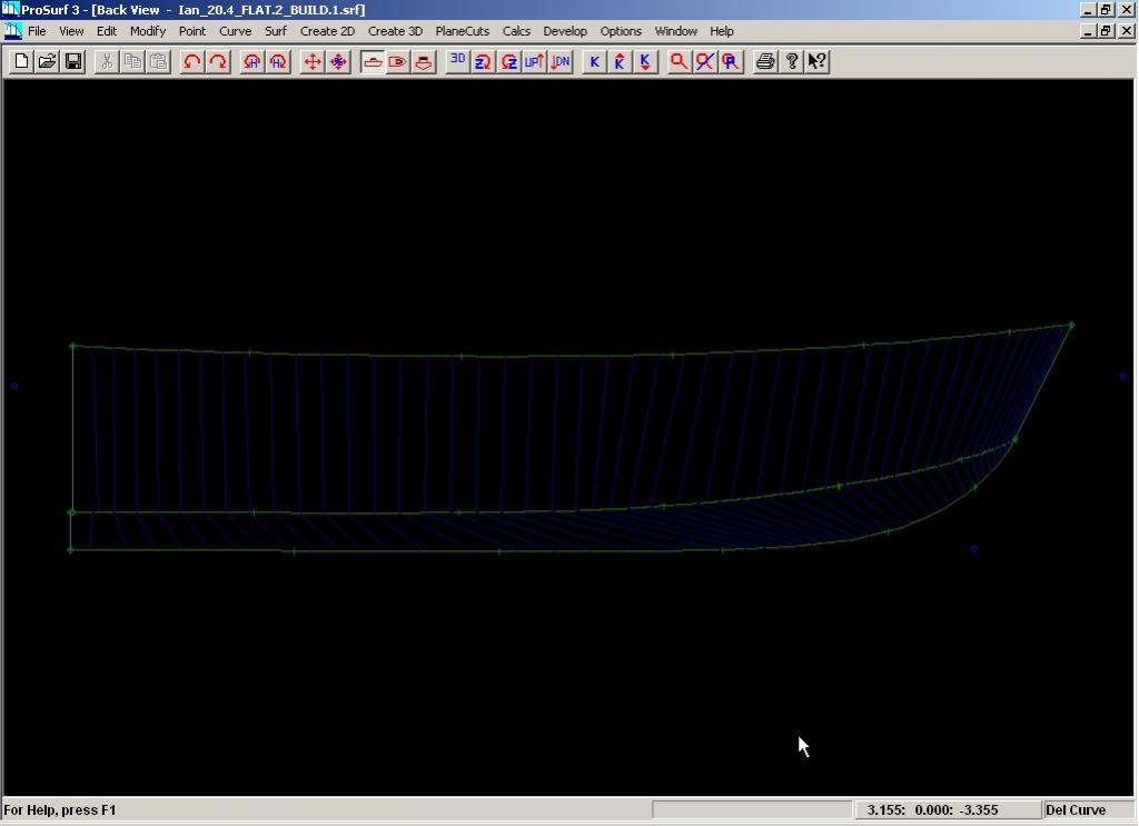

    Again, thanks for the comment. If you have any interest in boat design, I would encourage you to look at ProSurf. It is a marvelous program that is not hard to learn. For the builder, not only does it aid in shaping and fair lines and surfaces it 'unwraps' 3-D geometry so as to be cut. The following pic shows one aspect of my next project skiff in Prosurf. All the blue lines (called ruling lines) aid in making the surface developable, meaning that it has as little twist in it as possible. The more the lines resemble one another (try to not cross each other) the more developed it is and thus easier to build without boingers.

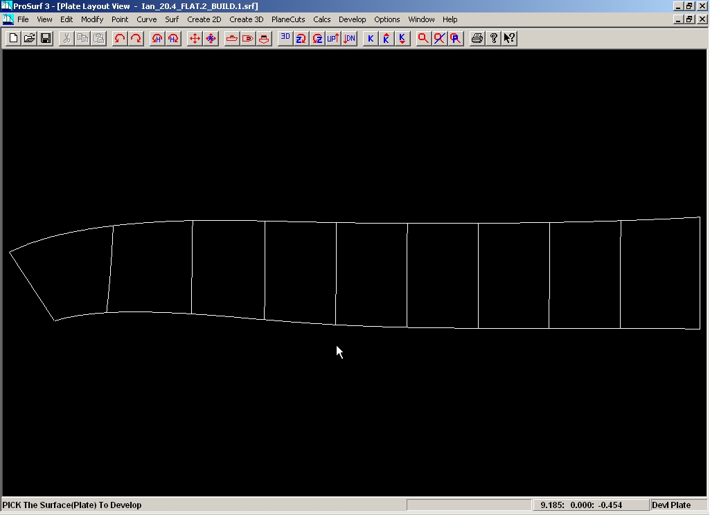

    Then when one is finished with the 3-D geometry the program will develop the plates in 2-D.
    This is the side of the skiff laid flat. This is the file that would be sent to the cutter. The lines within the perimeter represent framing stations and of course wouldn't be cut but would be marked by the cutter with felt marker. This leads to the next beautiful thing that this program does which is to slice and dice the model in any conceivable direction. Which is to say that it produces longitudinal, deck and athwart geometry for frame patterns. For example, here is the cut file ,nested on a 7'X20' plate, for 1/2 of the athwart framing in the 40' landing craft. In another more general purpose CAD program, the files are finished so as to show break lines and slotted where it intersects other framing.

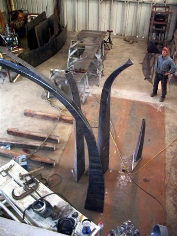

    This program can do many things! Here are pics of a sculpture that a friend of mine did. He built a model that we translated in ProSurf full scale, paper plotted it and transferred it to 10ga. steel plate. It's in a Downtown park in Anchorage. If you can't tell, I love what this program can do. It is truly one of the few pieces of software that changed my life and the way I go about things.
Name:	leo (Small).jpg
ID:	11979Click image for larger version.
Name:	06 (Small).jpg
