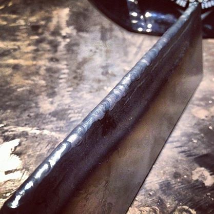

    First Project, probably 3 hours total torch time.
    Outside Corner, 14 gauge carbon steel. 1/16 1.5% lanthanated Tungsten with ER70s-2 1/16 filler

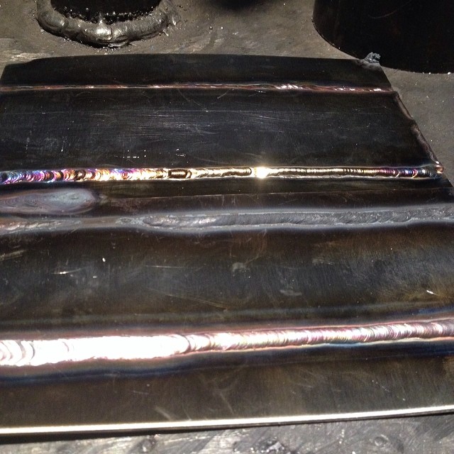

    This was one of my early lap joints.

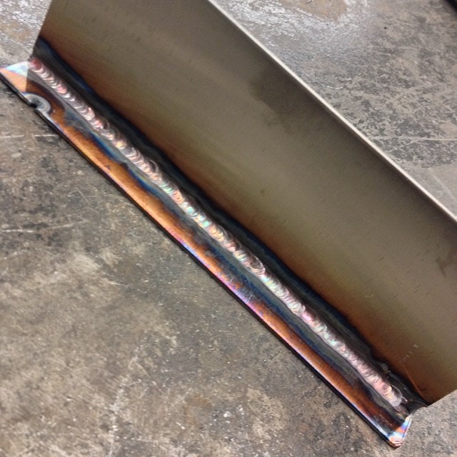

    This was my T Joint.
    Only had to do 2 of these projects, then on to Aluminum.

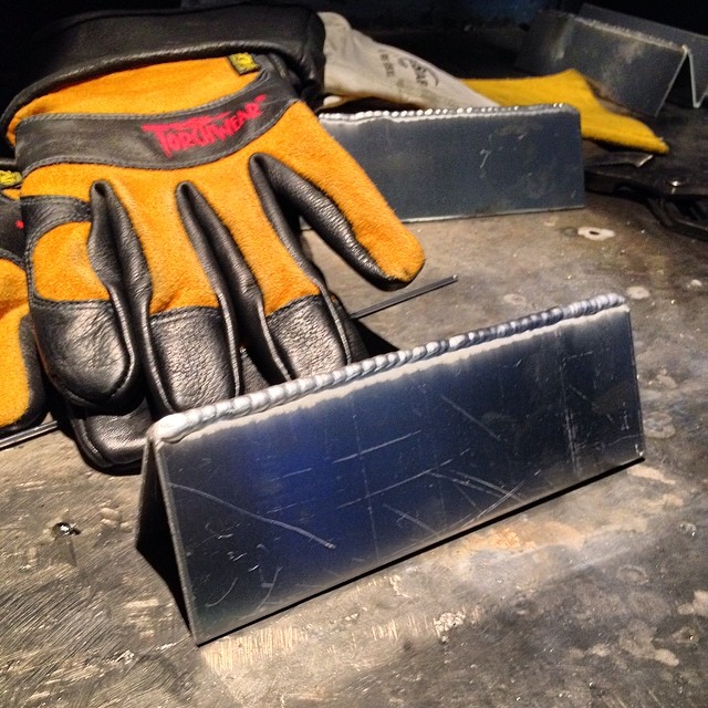

    This was the 3rd try at outside corner. Other then the end, and i skipped a beat twice in the weld, i got a pretty good grade for it.

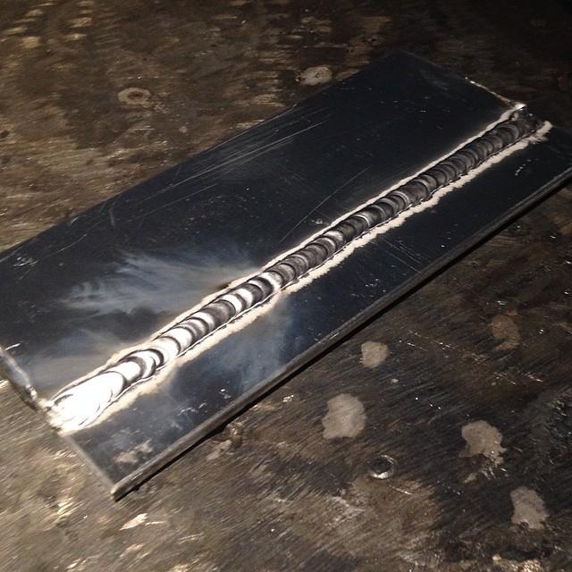

    This is my lap joint. You can see where i hit the tungsten with the filler. That and having some slight bead size inconsistency, this was still a decent grade.
    Again, had a couple days between this day and the Outside corner, so again i spent time on scrap to get a feel again. Had to re-find what i liked in the settings, because I didn't write it down, and the kids who use the machine on other days completely messed with it.
