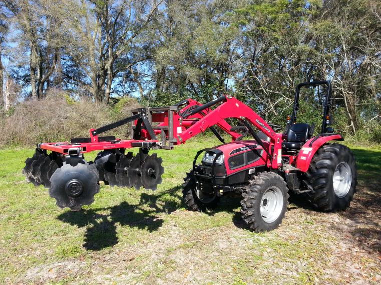

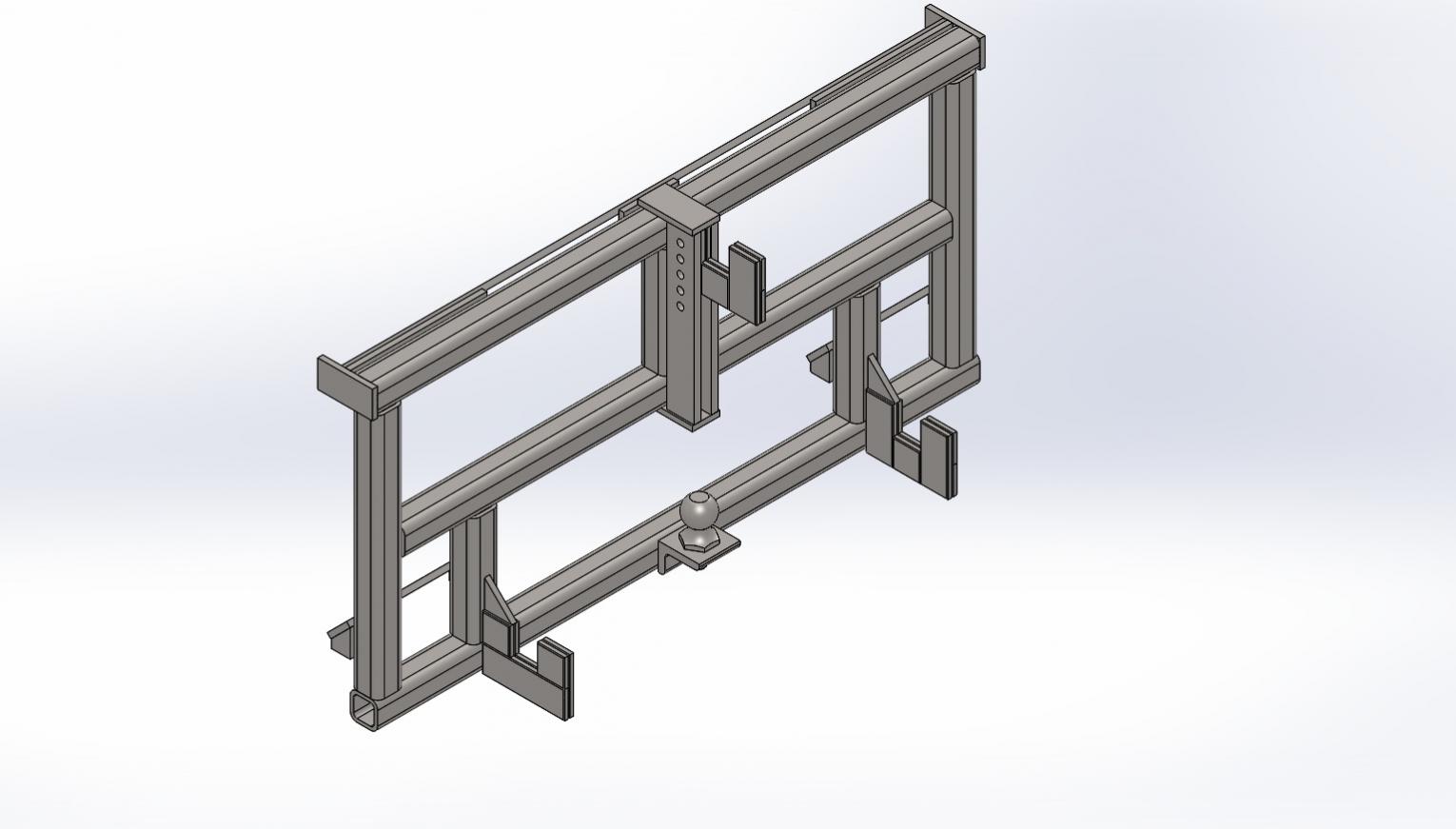

    Hello Forum. This is my third post and let me say first I am fairly new to my multi-process machine. I have been stick welding for ages on a tombstone. I design and fabricate my own tools and machines for use on my farm. As the manual is quite vague on its features I was hoping someone could shed some light. I did find some videos but they were also very vague or were about marketing. First is the wave form knob when selecting Mig. What does it do exactly. Set it to zero it will do this, set it at 50% it does this and what at 100%. I have laid some beads but don't see much of a change. I am just trying to understand from a technical point of view what these features do and how I can apply them. The same thing goes for Arc Force in stick mode. I have watched Jody do the stick review but he doesn't say the reasons he puts it at 77. Why would I change these? What are the pro's and con's? A video would be nice showing the features usage with an explanation of what happens when its set at minimum then maximum. I have attached an image of my first project with the MTS and the original design in Solidworks. This is an attachment for my FEL to move my implements in and out of my shop without having to hook up the 3PH. Works awesome. I can say I love this machine so far even though had a few bumps in the beginning.
    Thanks for your input and opinions.
