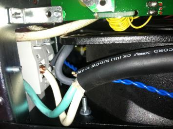

    Hello, I just received my new unit from Everlast this Friday. The machine is dated Jan 2014. I hooked it up and I can't get a puddle going. The machine seems to run fine. I read the manuals to the best of that ability. Here are my notes. This is my second TIG welder. Hobbyist.
    - the breaker in the back is not hot
    - my wall plug is not hot
    - it is connected to a 220v 30a
    - I get argon, no leaks at connection points, gas at 1300
    The instructions I have received contradict with what the online manual says about connecting +/-. So, I have tried both and it seems I get the same result. I first powered it up, set controls (1.0 pre flow, 10 start current, 150, 10 end current, 1.0 end gas) what I got was a very bright, burnt tungsten. Used torch hand control.
    - had just 2t, then pedal and 2t
    - hf tig
    - tig pulse off
    - metal was clean
    - grounded
    - tungsten grinded with new stones on grinder (2% Ceriated)
    I then tried foot control. Same control parameters, dropped 150-100, 10 slope up and down. What I got next was no real arc, it seemed the tungsten was glowing red about 10 mm up, and the metal got burned. Steel. Like what you would see on burnt paper. I then tried A/C and had the same problem. (pure tungsten electrode) The noise sounded like automatic gun fire.
    I haven't messed with the hidden controls. I am trying to find the post about someone else having a similar problem. There must be something I am missing. Any help would be appreciated but plan to call technical support Monday if this isn't resolved.

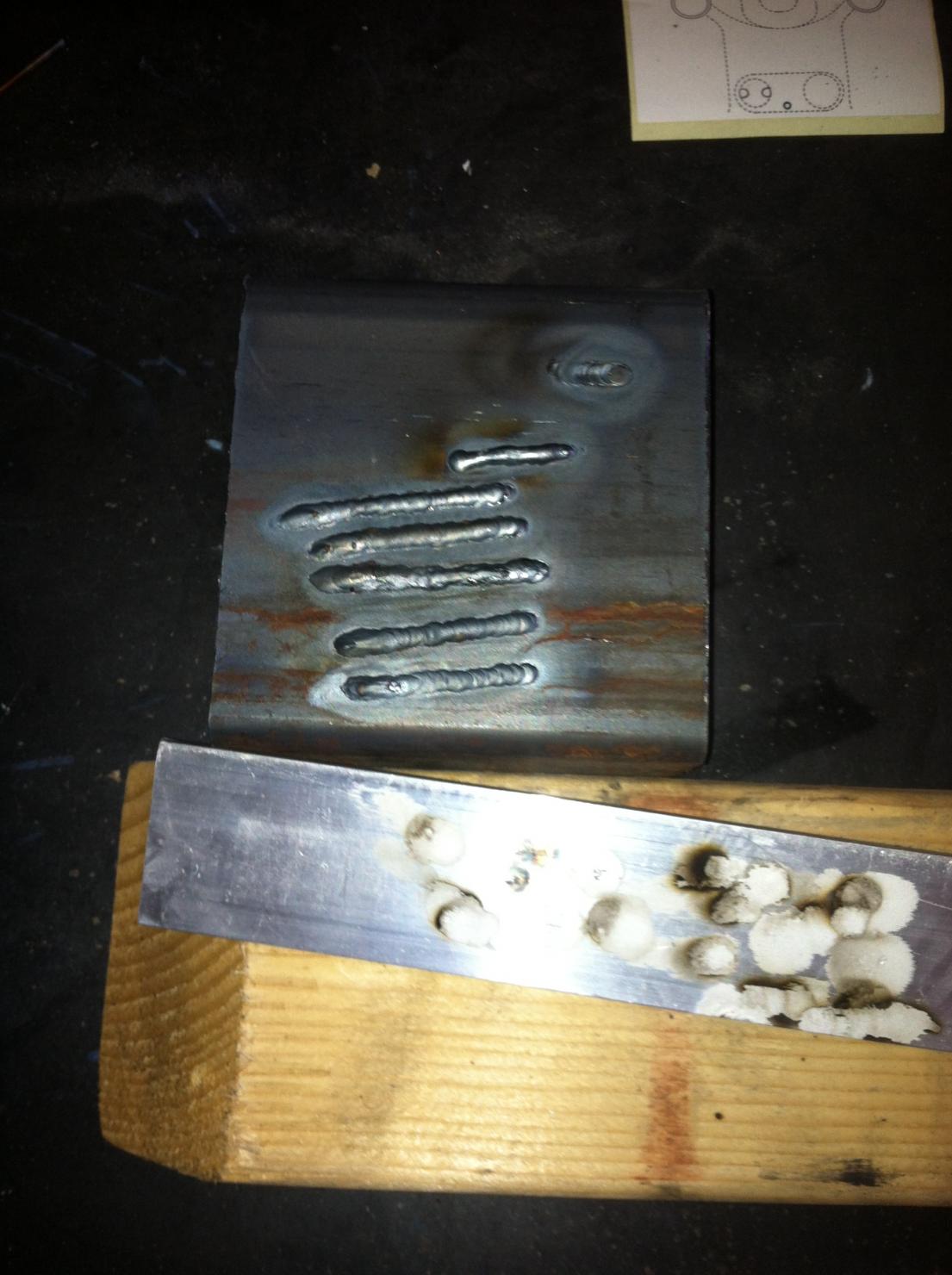

    Thanks guys for the responses. Hopefully I will answer them all.
    -yes to steel. Not ss, 1/8 thick, 3/32 Ceriated tungsten
    -everything on torch is tight
    -argon is set to 14, had 15
    -unsure how to do scratch start, will look it up here shortly
    -did not receive any parts for stick and have never attempted it
    -Ground is good, made a big welding table with last tig machine and used before I got rid of it. That's how I know argon is good and ground works on table
    -Rambozo, will try settings. Had slope at 0, changed to 5, up and down slope.
    RichardH, I think mine is a little different than yours.
    I'm fine taking panel off. Actually it is now. Noisey beast. Fan kicks ###. In Glendale, AZ.

    i believe the wire is correct, when i had the problems, went to local home depot and talked with the guy that had a badge that said master electrician. had talked to him before. he believes the wiring is correct hence the statement about the cable connections not being hot. nor the machine turning off.
    ground is on the right, and the torch is connected to that per the online manual. correct?

    I seem to be the guy that responds to his own post post.
    Anyway, the start up amps help. so check for the dc. ac. nope. so i am assuming its me again.
    The arc dances in a nickle style circle and no puddle.
    My last machine didnt have all these nice features so i am now going to read why they are important.
    Any ideas about the ac?

    Your torch should be in the right. Not the ground. This is likely most of the problem. Black and white wires are hot. Green is ground. It should have nema 6-50 plug.

    Good news, I think… I stopped by Matt's and we tinkered with his 210EXT for a while on both steel and aluminum, and I think we settled on some settings that work well on each. There definitely was some screwiness with the welder - not a physical defect, but the user interface has a "quirk".
    He's got the new "2014" one-knob model of 210EXT (I think it's the one they've been selling in Canada for a little while), and aside from the panel being different, the personality is a little different.
    Specifically, this version of the 210EXT has a new option for "Pedal", in addition to 2T/4T. Though I'm not sure how that's different from 2T. Second, it seems that the 4T settings were in effect for start/end amps and up/down slope, even when the welder was not in 4T mode - this was the root of the problem. Once we zeroed out the start/end amps and up/down slope, and set it to Pedal for good measure… then it started working as expected.
    On the 2013 version I have, you can't even set 4T options when the pedal is plugged in - it auto-selects 2T mode, and it works as you'd expect. In the case above, it seemed like the pedal and 4T were both battling for control, so the welder was stuck in arc-start mode for a really long time. It wouldn't be until after the 5.0sec upslope time (or even double that) that a steady arc would establish and we'd get a puddle. During that time, the amps on the display jumped all over the place.
    We didn't do a lot of problem isolation once we got to working settings, so I don't know if switching from 2T to Pedal fixed the problem, or if it's because we zeroed out the slopes. Either way, it probably shouldn't be doing 4T when it's not in 4T mode.
