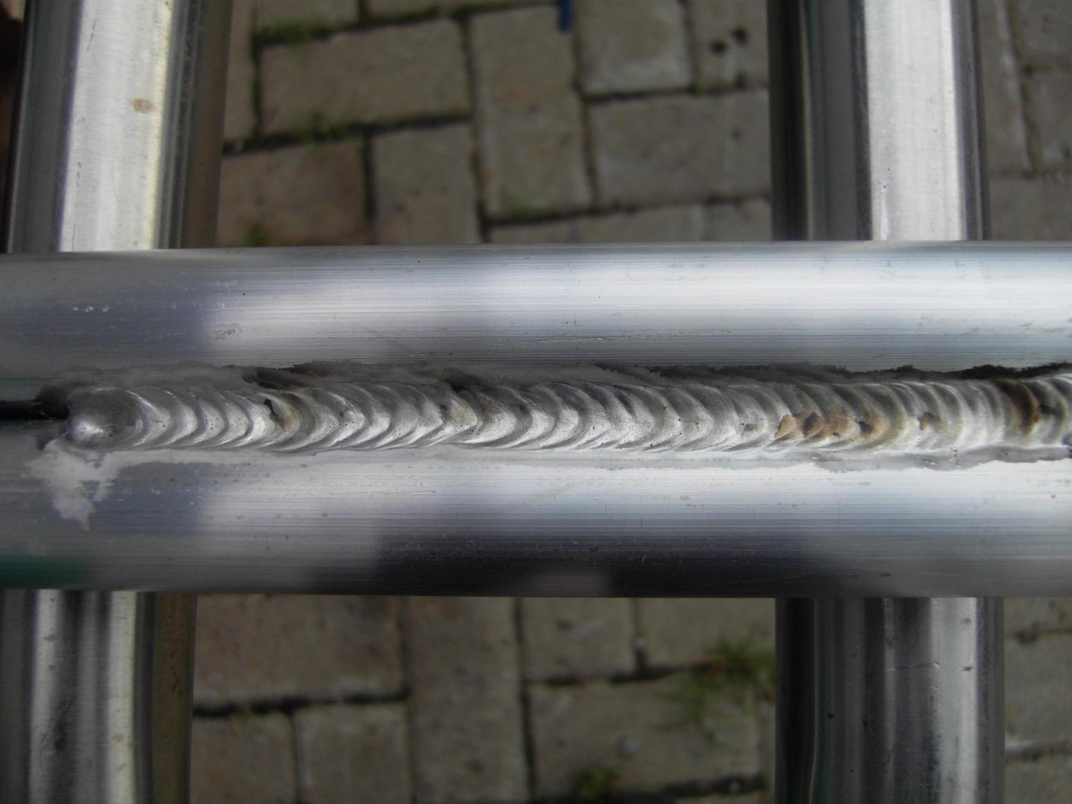

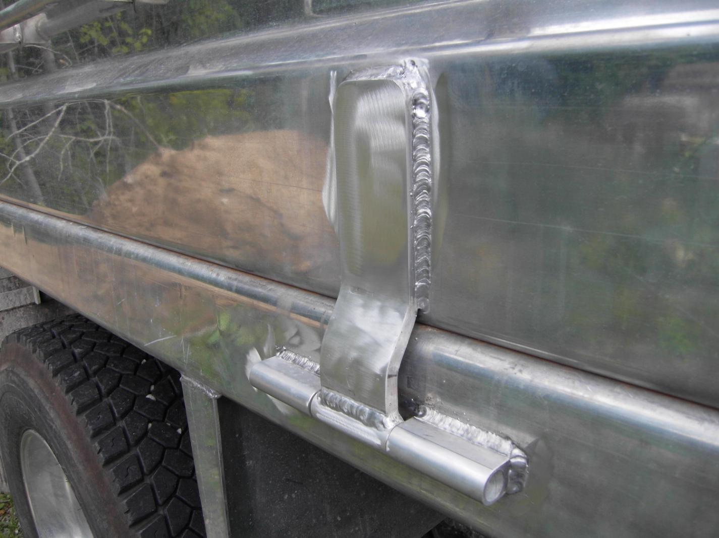

    I have a MTS250S got it with a Everlast spool gun SM 200-N and have done a lot of aluminum welding with it and it will hold .045 wire also but I used .035 and .040 4043 wire I tried 5356 but it was harder to get a good weld some day I will try it with helium and argon mix.
Name:	spool gun alum.jpg
    this one had some splatter
Name:	spoolgun alum 2.jpg
    used more argon flow and upped the volts by .6V on this one and got a better weld.
    All the welding are done with the Everlast spool gun SM 200-N the spool gun is 25 feet long not the 20' on the website.

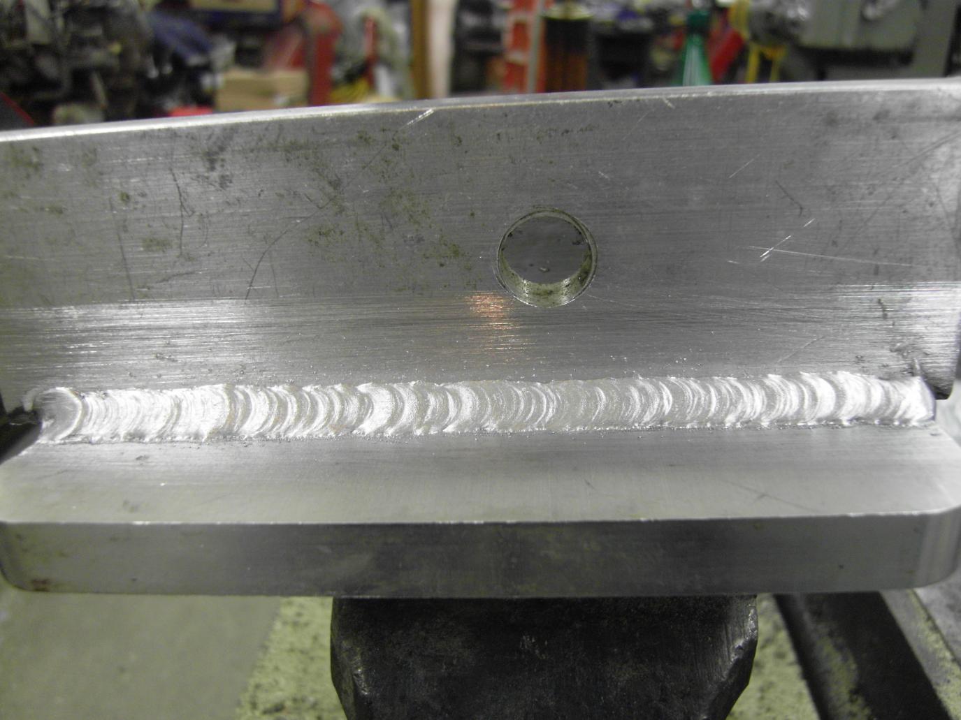

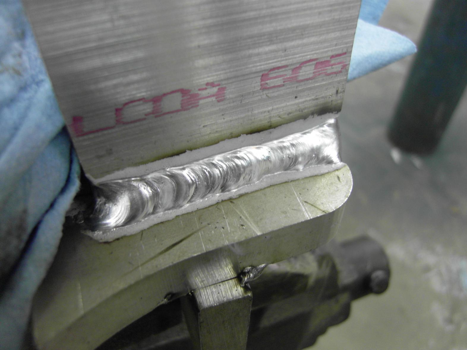

    What's the thinnest aluminum you can weld cleanly with this setup ?
    Kempy, thanks for the reply. So it seems you are happy with your machine. 3/64" aluminum wire is .047" diameter. Have you ever tried that? Does that gun take some standard tip or off-breed? I use an .060 tip. Can you get them that size? Nowhere can I find that info on the website.
    I like the cleaning action I see on the weld in the second picture. The first pic looks like it has been brushed afterwards. All the machines I have or have used like to run .047" at between 19.5-22V. What are you running at? Have you ever been able to outrun the machines duty cycle?

    I have only done 1/8th or 1/4 in most of the time but did 1/2 to 3/8 also.

    I tried .045 once to see how it worked only with 4043 never tried 5356 in .045 but did with .035 and .030 not to bad but black maybe it would work with a little helium added. Yes the first one I used the wire brush to remove the black smoke. After I got thing working the black smoke was almost 100% gone. Duty cycle I have not push it that far yet. Welded 1 inch round tube to 1 inch round tube 1/8th thick about 6 inches each time total of about 5 ft. for about 2 minutes and off then Tig the rest of the part around 15 minutes or less.
Name:	back and forth mig  alum.jpg

ID:	11891Click image for larger version.
    The tip are standard I have used Princess Auto, Binzel, Lincoln and Miller tips 6MM thread and inside diameter from .025 to .062 they are cheap to buy.
