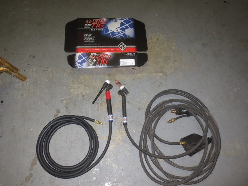

    this is an update on my comments about my CK flex loc tig torch. I emailed CK and asked if they would provide me with the part FLAF so that I could convert my WP-17 power cable to be used on my FL3 torch body.
    I dealt with Jeffrey k in customer service. told him about my problem. he said they would ship me the part but would I mind shipping him the cable. even though I was expecting nothing more than the part I sent it to them. I figured why not, I was going to have to pay someone shipping and wait for the part anyway so might as well do business direct.
    I had also, purchased on amazon, another CK1512 flex loc with valve to be setup with a quick connect for field use only. a situation where I was using scratch start. or I could run it off my inverter with a hundred feet of argon line. whatever.
    so I sent them the cable and at almost the same time they received mine I received theirs and in the box was a new 25' super flex power cable. I put it on the torch welded with it and it worked great, no over heating. hot after a while but not an issue.
    they did not have to do this, they did not sell me the original. it was a total surprise and I am grateful. the new one will be a dedicated torch for my units with solenoids, since the torch has no gas valve and the 12 footer will be for those situations where I might need to run out some cable. the twelve foot one can be used on an inverter as well.
    one happy camper here. thanks CK.
    PS. like I mentioned earlier if you are going to get one torch get one with a valve. you never know, I have blown out solenoids (actually just once) in the field. with the valve you can always work around the machine by running directly off the bottle. could save your axx.
