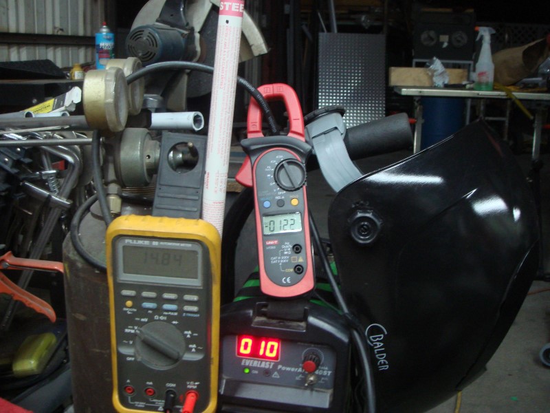

    OK, I checked again and here is what I found. Open circuit voltage is right at 69 volts and is bang on over the whole amp range. There is some thermal drift over time, but it's less than .1 volt and again is constant over the whole amp range. This is the same in stick mode and TIG mode, BTW.

    So clearly you have a problem with your machine and how far you want to dive into it is up to you. Very odd that you got two bad ones.
    Mine is very stable down to 10 amps on 240VAC sorry I forgot to check on 120VAC, but as I recall it will go down to 7 or 8 on 120VAC. The actual output is a little higher than what is displayed, and that is pretty consistent everywhere. Checking under load, the output is very stable with just a little droop at longer arc lengths. In the low range it can handle arc lengths up to about 15 volts before it cuts out. With the panel set to 10 amps, a short arc would yield 13.6 amps @ 11.5 volts, while a super long arc would be 12.2 amps @ 14.8 volts. At the 15 amp setting the results are about the same 18.9A @ 11.5V vs 18.0A @ 13.3V

    You answered my one other question about checking in stick mode. I frequently forget to flip the switch, and not only will the automatic hot start take it's toll on the tungsten, but the auto arc force also plays with the amperage and causes some of what you describe. I wonder if that is not being switched out on your machine? As the voltage goes down it will crank up the current but it is not reflected in the panel display reading.

    Thanks for taking the time do do the testing! I have inserted a high-wattage shunt (1 ohm) in series with the ground lead and measured the current under various conditions:
    Dial set to minimum (11A), with electrode touching work the current is 8.17A
    Dial set to 30, current measures 20.5A
    Dial set to 50, current measures 27A
    With dial set to 20 (the lowest setting that will establish an arc, current measures 9.7 to 10.1A
    In order to get 20 A of measured current, dial must be set to 40A
    Here's the interesting part- with the 1 ohm shunt in place, the variations in current and the flashing duty cycle lamp go away!
    Gotta think about this while waiting for CA to wake up....... Neil

    According to the phone tech. if the duty cycle/OT lamp lights it indicates an internal problem with the machine. Have another one on the way for the third and final test. A product review of the PA140 on Amazon related the exact same problem but the reviewer was so inexperienced that he thought it was just a normal characteristic of the machine. I'm learning things I probably should already know about price/performance expectations.
