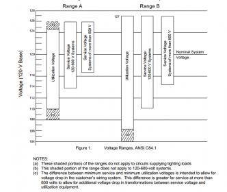

    I will say this....that 139 volts under load is too high of voltage for what the machine is rated for 120V +- 10%. This could be causing the issue with the over voltage light flashing on. Is this being supplied by a generator?
    Quote Originally Posted by NWD43 View Post
    It's absolutely not a mains issue, I can run anything I want to on this circuit without fail. Measures 139VAC under load.
    Holy cow! That's not normal. See below, from ANSI C84.1.

    You are at least 10 volts over the upper end of the normal range for 120v mains power.
    EDIT: Dang it. The forum resized my image so it's not readable. Here's the original link.
    http://www.pge.com/includes/docs/pdf..._tolerance.pdf
    To sum up, a nominal upper limit for 120v power is around 127 volts. I don't know what you have been running on that circuit "without fail," but you're lucky to not have destroyed it with over-voltage.

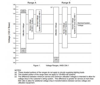

    Of course you're right!! My error, I meant to say 239VAC for the circuit. The 120V circuit is nominally 120V.
