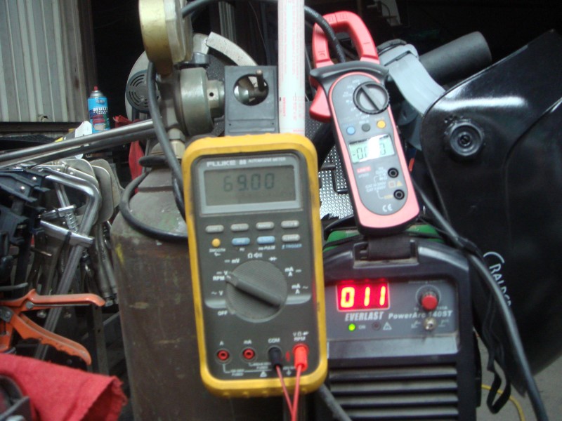

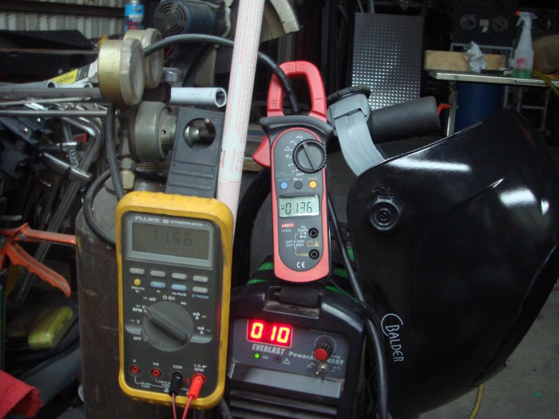

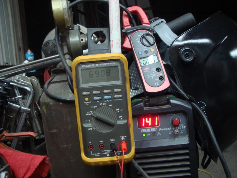

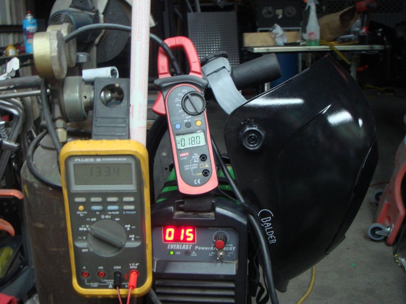

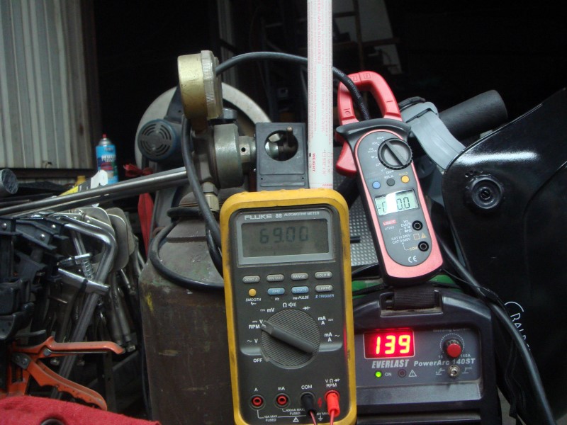

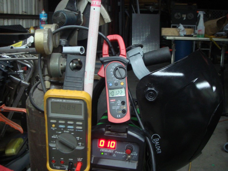

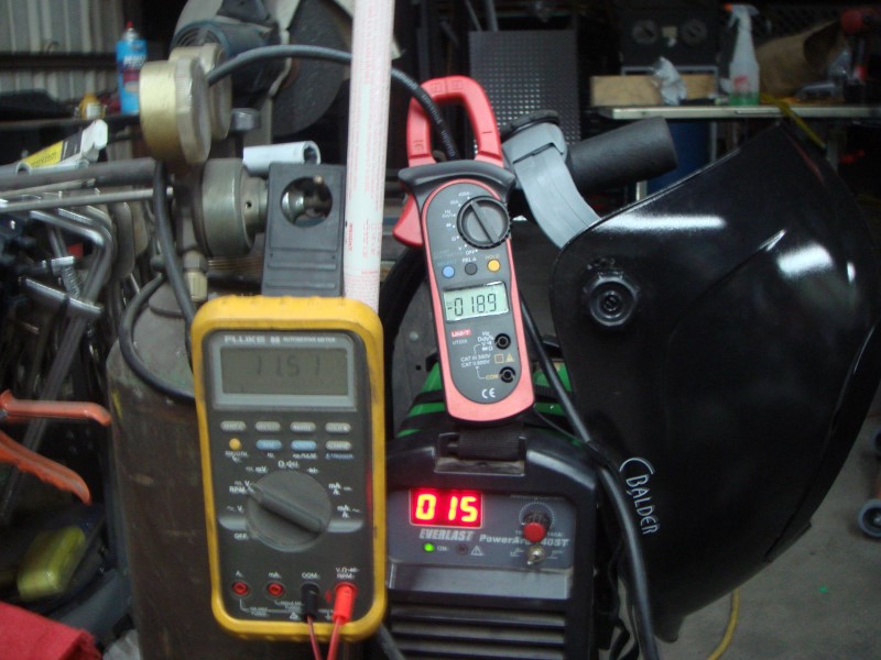

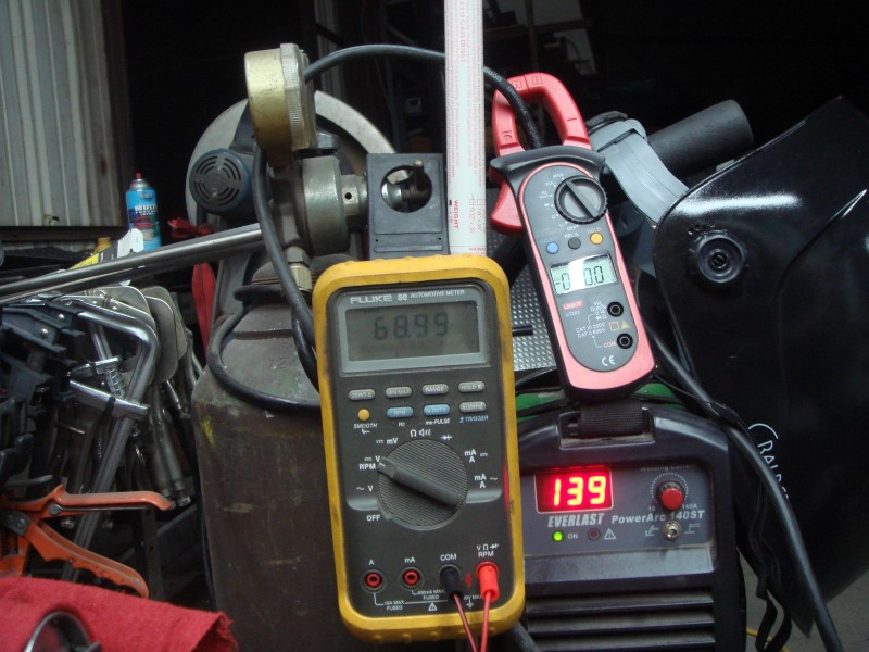

    OK, I checked again and here is what I found. Open circuit voltage is right at 69 volts and is bang on over the whole amp range. There is some thermal drift over time, but it's less than .1 volt and again is constant over the whole amp range. This is the same in stick mode and TIG mode, BTW.

    So clearly you have a problem with your machine and how far you want to dive into it is up to you. Very odd that you got two bad ones.

    Thanks for taking the time do do the testing! I have inserted a high-wattage shunt (1 ohm) in series with the ground lead and measured the current under various conditions:
    Dial set to minimum (11A), with electrode touching work the current is 8.17A
    Dial set to 30, current measures 20.5A
    Dial set to 50, current measures 27A
    With dial set to 20 (the lowest setting that will establish an arc, current measures 9.7 to 10.1A
    In order to get 20 A of measured current, dial must be set to 40A
    Here's the interesting part- with the 1 ohm shunt in place, the variations in current and the flashing duty cycle lamp go away!

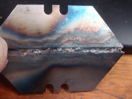

    You could compare it to a Lincoln, but only to something like an Invertech V155-S
    No one has ever mentioned the duty cycle lamp flashing, I do not think that is normal at all. Out of curiosity, have you tried it on 120 volts? I find that for real low amp work, it's much more controllable when running on low voltage. I have added a finger amptrol, and always light up at 10 amps and its very stable. I am wondering just what they changed in the new version. I wasn't expecting it to be a real low amp TIG unit as that is not what it was designed for, but I have been more than pleased with it's performance. On 120v the displayed current was 8 - 9 amps to do this with some .030 MIG wire for filler. Not a great job, but that's more my vision than the machine.

    It's not just a duty cycle light. It's a overcurrent light as well.
