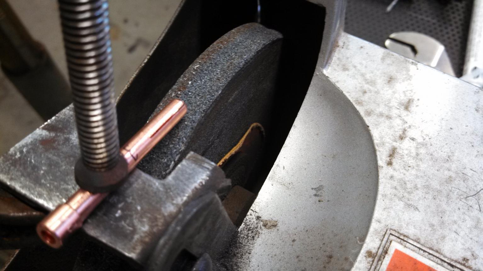

    My version of a 300.00 grinder. Just switch collets and adjust angle. Hmmmm...... am I very cheap(frugal), or inventive?

    Quote Originally Posted by ljdm1956 View Post
    The latter, and only because I thought of a similar idea. :-) But your execution is less Rube Goldberg than what I had in mind.
    Collets are naturally the right size, so why not use one to hold the tungsten at the grinder?

    Looks a little scary for me as most of my grinders have a slight vibration to them. And it will kick toward you to make sure it's tight.
    You mean without the C clamp? That would probably allow people using a bench grinder to get a little more consistent point.
    So far, no kickback. Consistent point angle, the c clamp holds it pretty well. Quick and easy to change the angle for different sizes. My grinder has A LOT of vibration to it, and no problem. It's an old, small, rickety almost useless grinder, so if I wanted to devote it just to tungstens it wouldn't bother me, but if I did need it for something else, its really easy to use it, and put the collet back on again
    Also - as far as kicking back (which it doesnt) the picture doesnt show it well - the collet is really pointing downward
    Yeah, it's an idea I'm still noodling, to create a grinder attachment that uses collets to hold the tungsten.
    Handheld, you could use the collet to hold a steady front hand while you turn the tungsten; this avoids wearing one spot on the wheel. But the collets don't lock without a tailcap applying pressure, so that's about all you could do handheld.
