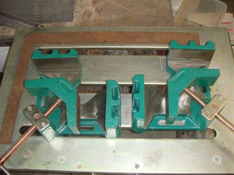

    Just got a pair of these NT corner clamps and thought I would give a quick first look review. They are on promotion for $39 for their holiday sale, if you get the email promos. They are cast iron and weigh just over 20 pounds a piece. The machining is fair, squareness seems good enough for what it's for. I have not swept them in with an indicator, so for now I'll just say they check pretty square. They seem rugged although the fit and finish is nothing to write home about. A little deburring with a file will help a lot. For the price, I'm totally happy. There are so many times where I have to hold things square to weld them, that I expect to get a lot of use out of them. The copper plating on the acme screws is thin to none, so be sure to spray them with anti-spatter for stick or MIG use. There is no push button quick release for the clamping screw, but at this price it would just be something to break. The acme threads look nice and well formed, and fit the nuts well. Just in case anyone is looking for something tougher than the typical aluminum cheapos, but can't justify spending over $150 for the Stronghand version.

    One thing I will probably do later, is add the holes for standoff bolts for holding angle iron, like the Stronghand versions have.
    I keep a bucket with Square Tubing cut-offs for clamping Angle like that, less complicated and I think applies more even pressure
    Quote Originally Posted by Blaster View Post
    True, I do the same to hold angle for miters in my chop saw, but finding the scrap I need, when I need it, can be an issue. Those little drops come in handy for all kinds of things.

    Looks like the same design, but smaller. With those being 11 lbs, and the Northern being 23 lbs. Not really a fair comparison. I guess you can ask if they can get the larger versions. I bet they all come from the same factory anyway.
