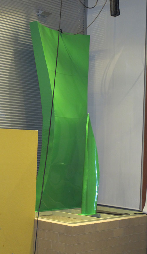

    But do yourself a favor now and get the water cooled torch and cooler now..
    Did a 16 foot tall by 6.5 foot wide sculpture out a aluminum and really liked having the cooler..http://www.kevincaron.com/art_detail/the_seed.html
    This is what it looked like when done.

    Kevin - I have to admit that you're a small part of my rationalization for a TIG welder. I'm mostly a utilitarian kind of guy and expect to use the welder for car/4x4 and building applications, but your work is truly inspiring. The fact that you let others see your process is commendable - Thank you! I am getting the water cooled torch as well. But…I'll probably just build a cooler at some point as that it the kind of thing I like to do.
