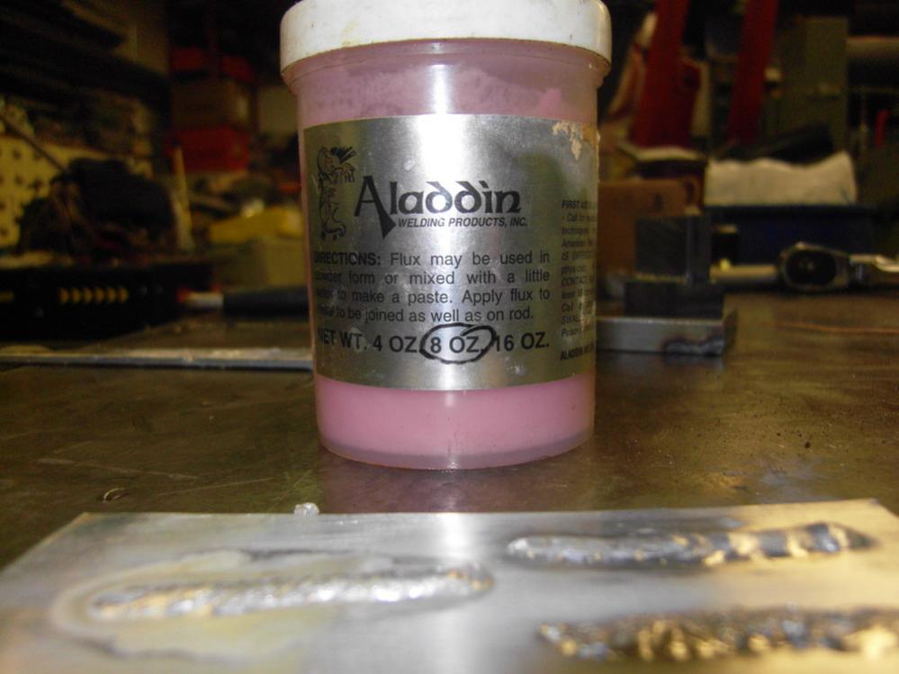

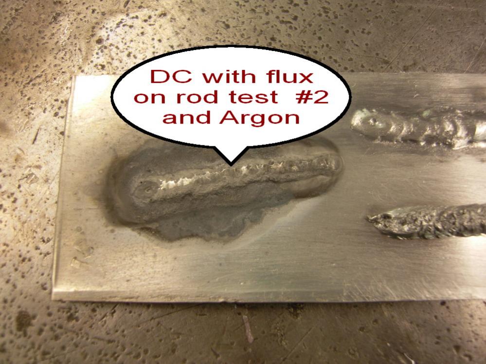

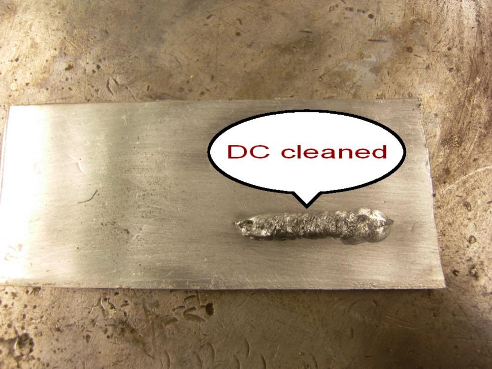

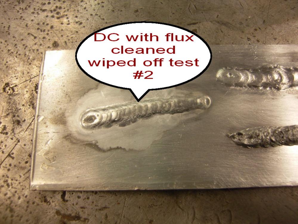

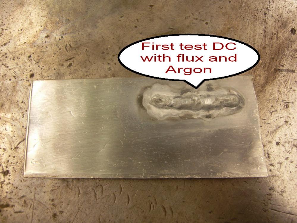

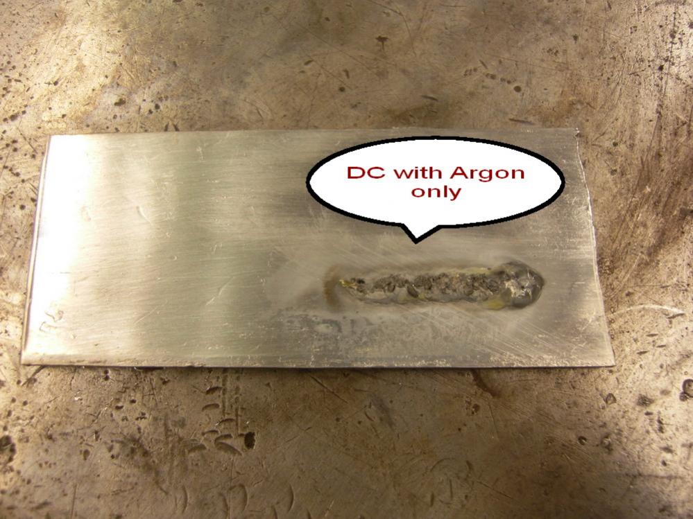

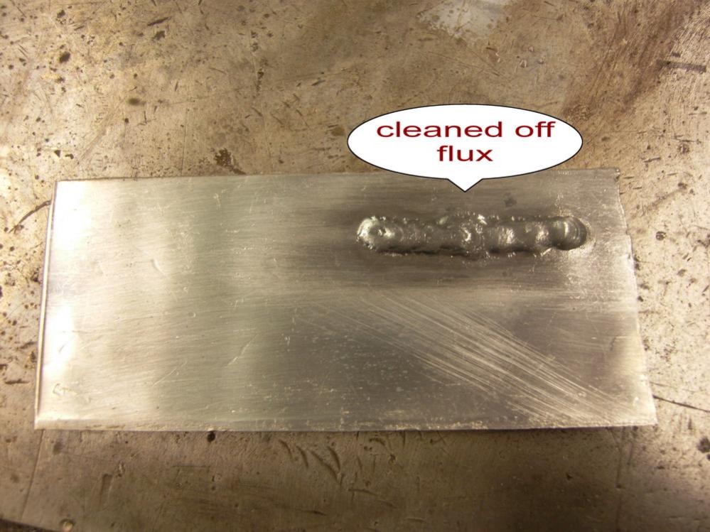

    I played around with DC welding aluminum with flux and with out flux both with Argon.

    I remembered when I gas welded aluminum it worked well with flux so I tried it and it is easer, next test is with different lens in the helmet so I can see the weld better.
    Then with Helium.
