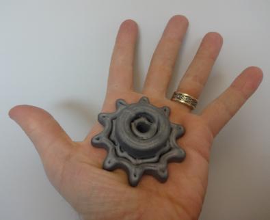

    The Rostock they used for the demo was kinda cheesy, but any accurate XYZ CNC transport or robot would do the job. The smallest feature size wasn't too bad. I would guess they use .023 wire. They did print a chain sprocket that was functional, with the system.
