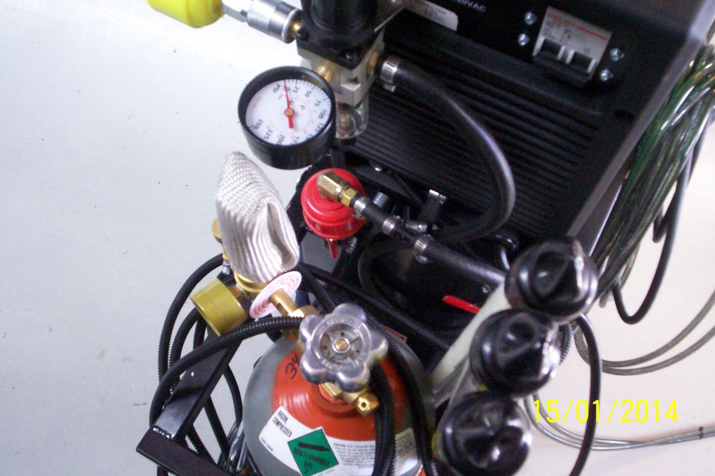

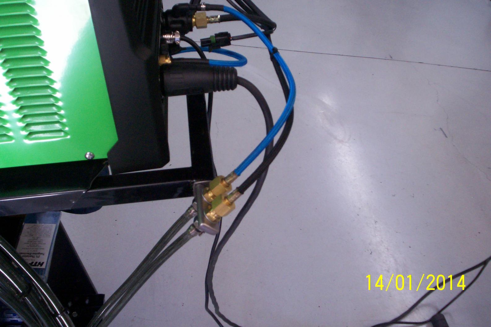

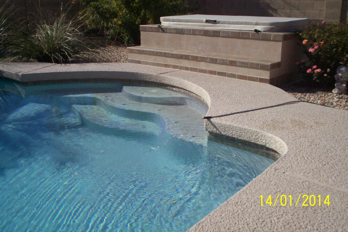

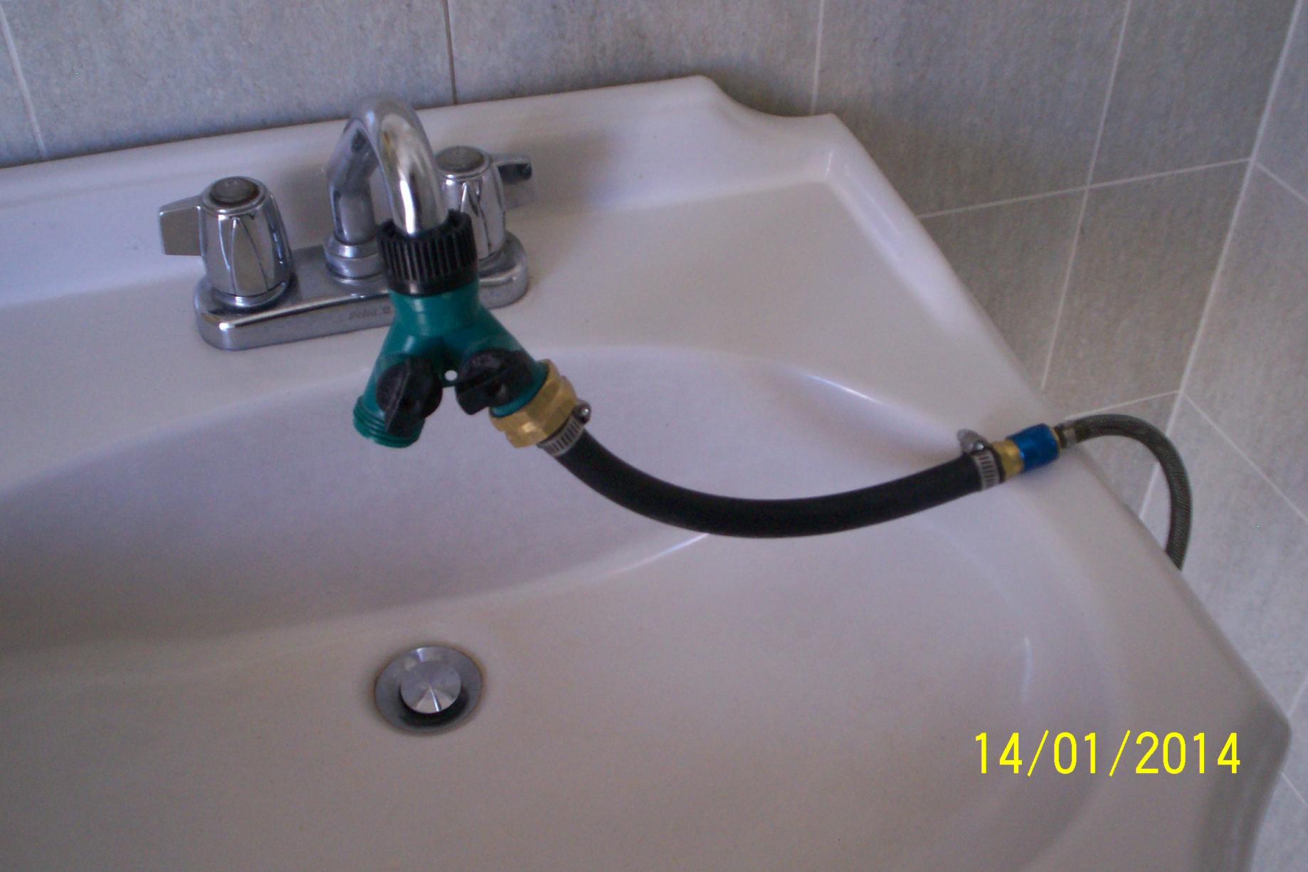

    Purchased a water cooled torch, not that I'll use it that much with the PP 205 but I really like how small the WP-20F is. Came up with my version of the tap water system that works great. Pics are of the welder connections, the shop sink water source, backyard drain and I threw in one of my tig finger holder. Someday maybe a real cooler but this is just fine for now. Click image for larger version.

    Nice...I like the drain.
    There you go.
    If nothing else you get a little heat in the pool too. Slick.
    Are you running argon through the water trap/pressure regulator on back of the machine ?.. It's looks that way in the pic. Argon should go from your flowmeter directly into the machine.

    Are you running argon through the water trap/pressure regulator on back of the machine ? Zoama, That only happens when I forget to turn that shutoff, there are 2.

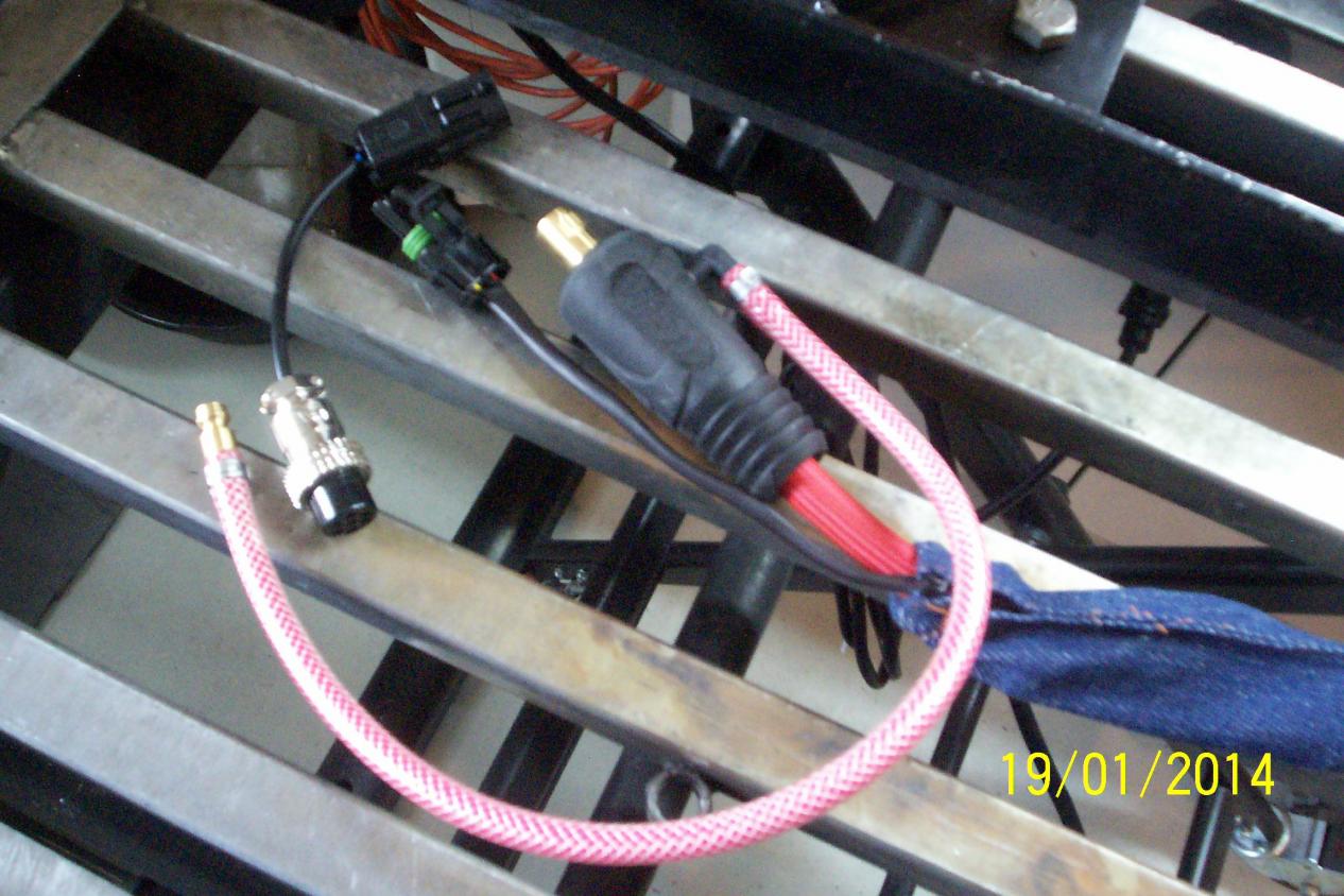

    I see you have a GM weather pack connector at the front of the machine looks like it is going to the control plug what is that for? Nice work on the plumbing.

Name:	2 pin connector.jpg
ID:	11728Kempy, I had some of these 2 pin weatherpac connectors and no 7 pin plugs for some new torches. I did the cheap way out for the new ones. It actually works just fine.
