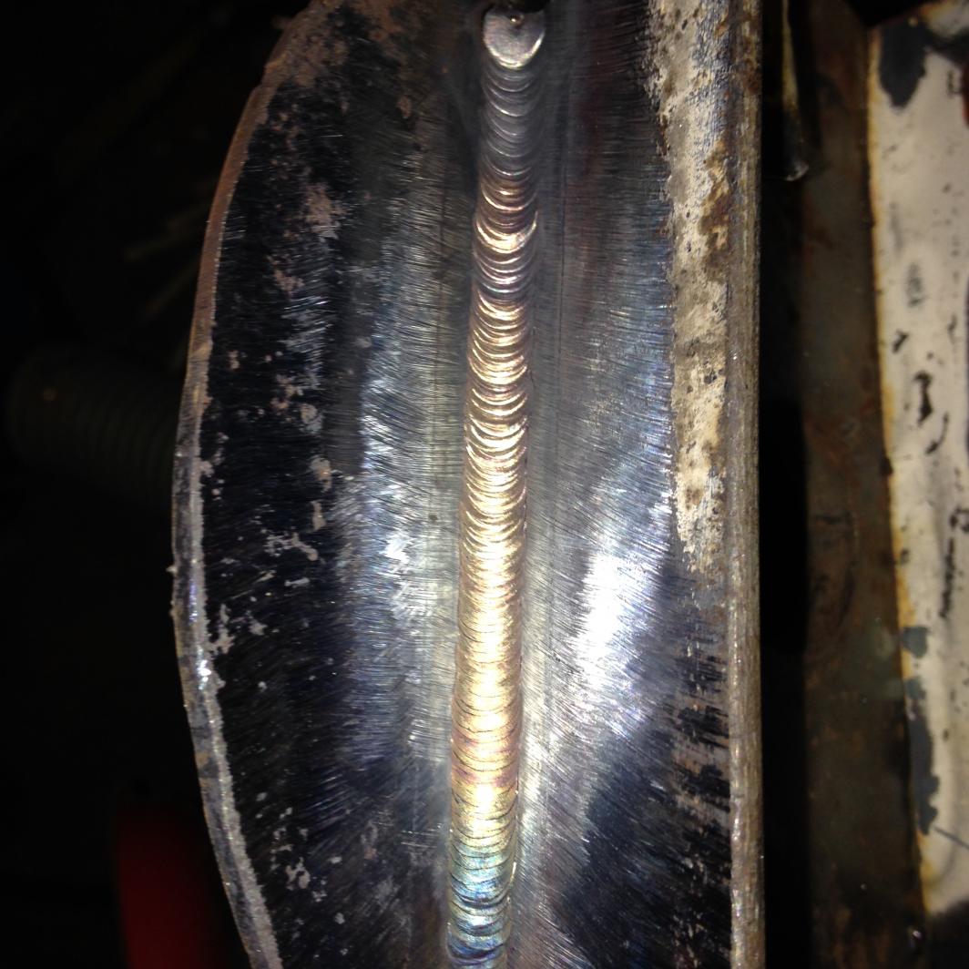

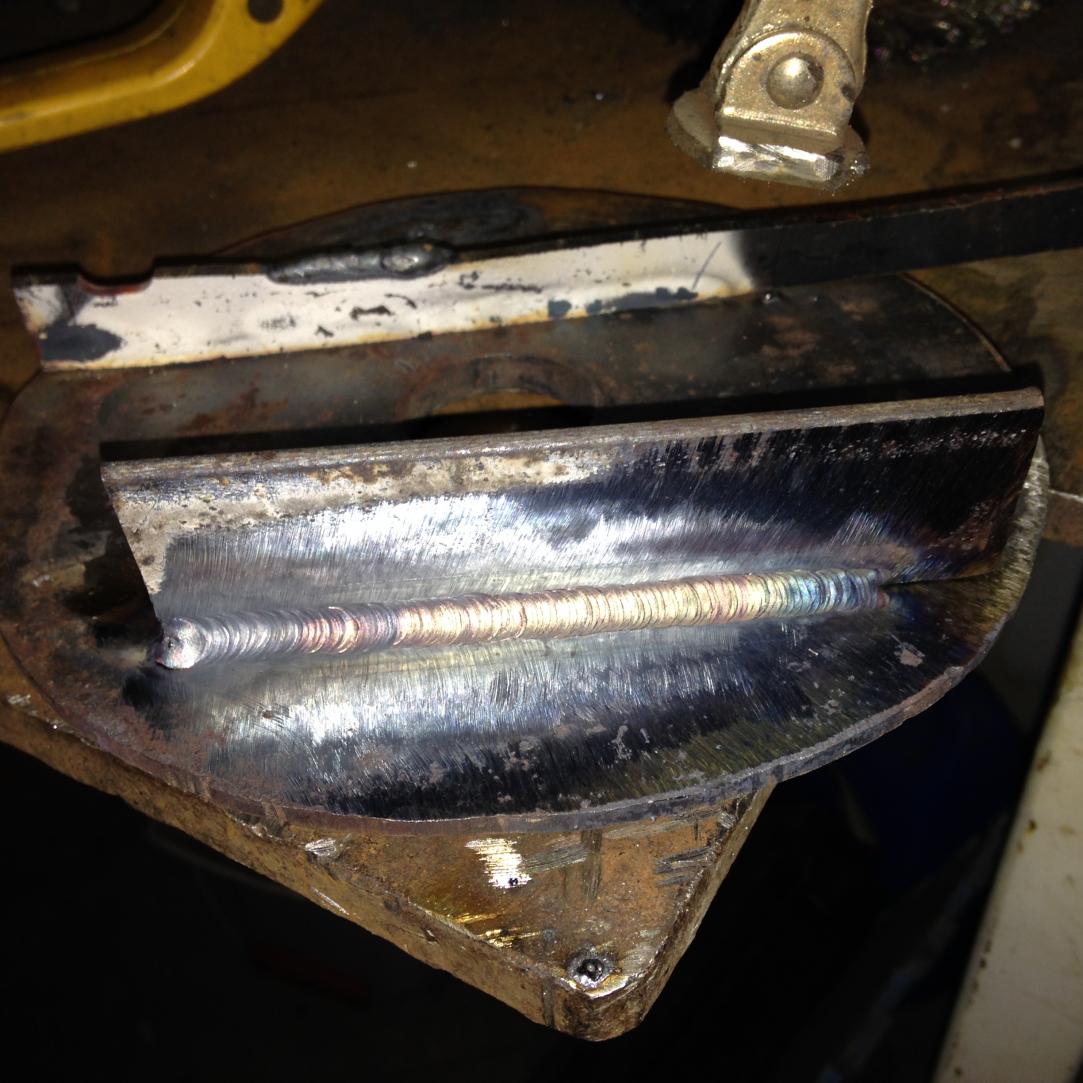

    Okay guys ignore the compressor, but click on the pics of the welds, and take a look at them, and tell me what you think. 135 amps, 3/32 2%thor tungsten, 3/32 309 tig rod, AND A EVERLAST POWERARC160STH!!!!!

    First looks a little over reinforced and slow. The vertical one looks spot on. It looks like you are dealing with 3/16" angle or 1/4" angle, not for sure. Definitely wider than 1/8". But even if it were one 1/8", it would, by the rule of thumb, require about 125 amps for adequate welding...so the welder seems to be operating right in this picture.
    As far as resale value, ????????? Resale value as a percent of original purchase is typically much higher than a Miller or Lincoln.
    What people think of as low resale value, is a total dollar amount, and that's not an adequate way of looking at it. IF you pay 450 dollars for a unit, and a year later you sell it for 350.00, you've lost a 100.00 and a little over 20% of it's value. However if you buy an equivalent miller maxstar for 1700.00 and a year later sell it for 1100.00 (which is not an uncommon scenario), yeah sure the resale value is higher, but you've lost 600.00 and 35% of its value. For the difference you could have bought an additional powerarc and saved a couple hundred more to boot.

    What I was saying with the pics, is the machine is tigging beautifely, it was'nt welding near this good before.
    Now its working great, I had it plugged into a weird outlet, it was screwing up machines, So I plugged it into a different outlet and Its welding perfect, Tomorrow I will get you some stick welding pictures.

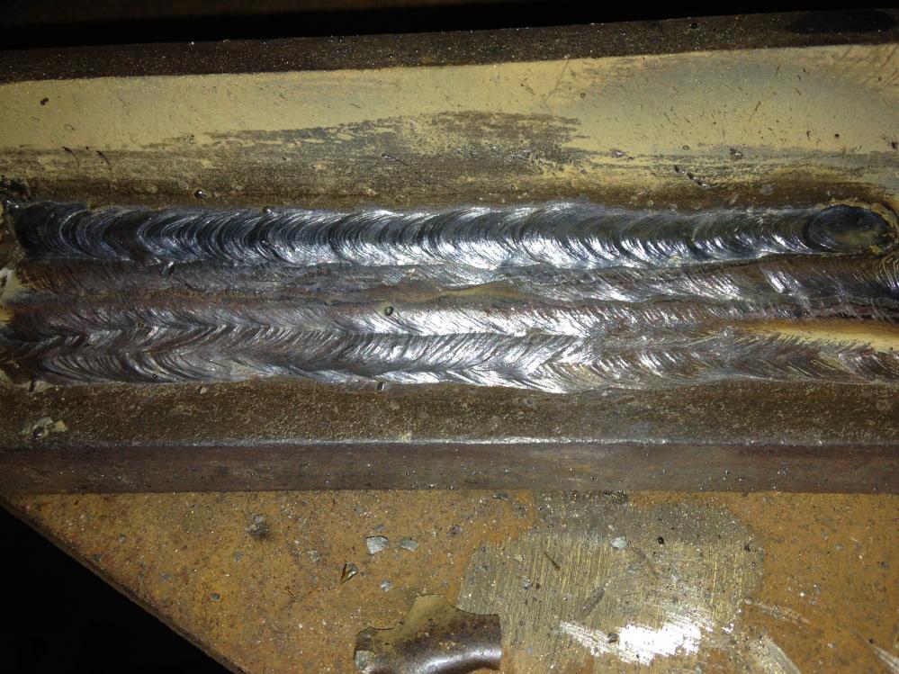

    1/8 7018 on 1/2 inch steel 127amps 7 passes

    the problem was the power was 208 1ph. not enough clean power. it was an old plum that had a twist lock plug on it, and we switched it to a 6-50r, I was having some trouble with it on other machines.
    I took it to another outlet that had been tested 230volt and its running much better.
