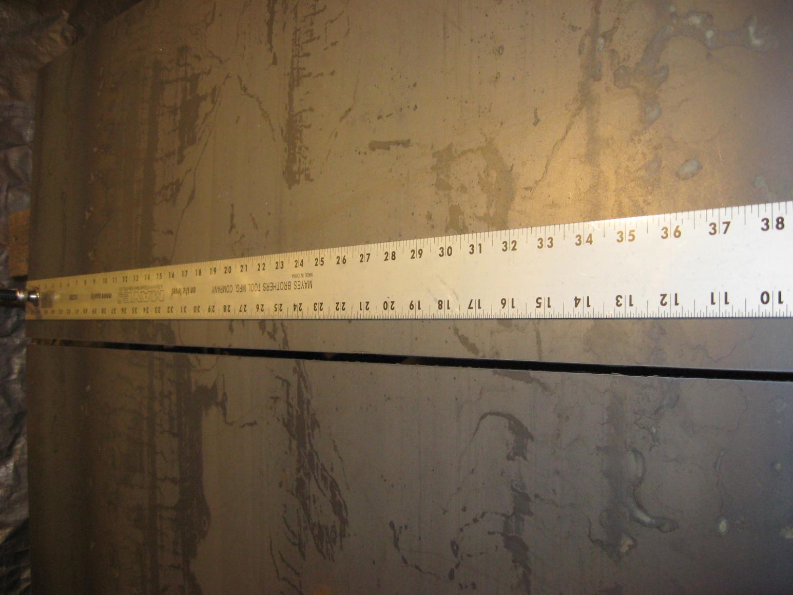

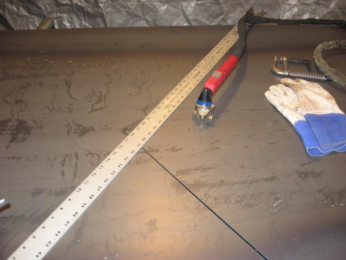

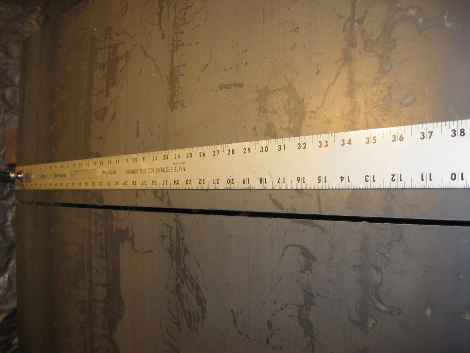

    It's a simple tough torch and the consumables last a long time with proper use and dry air. The roller guide is really nice to have because you can get super clean cuts with a straight edge. Click image for larger version.

    Everlast sells these as well.
    Edit: the P80 will only work on older high frequency machines.

    Keep a little pressure against your straight edge with the roller guide, allways make a dry run first before cutting and cut as fast as possible without skipping.
