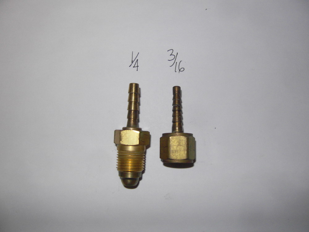

    Hello,
    Apologize if this has been covered on here before and I have searched the forum on this but not finding a clear solution.
    Bought a 140ST and having some problems figuring out how to hook the 3/16th line to an ARGON regulator.
    Mark made me aware of the youtube video on the 5/8 CGA conversion but not sure how that applies to the 140ST.
    Been to welding equipment suppliers, auto parts stores, propane gas suppliers, Lowes and cannot find a 3/16 barb fitting or the parts to make a suitable connection.
    One place offered to make me a new line to the torch with a larger fitting but after looking at the torch not sure that is an option.
    Do you just add lube and force the line over the supplied 1/4 fitting on the regulator?
    Thank you in advance,
    Don

    3/16 is a standard fitting for welding with small torches 1/4 is most common but I have all kinds for 3/16 internal, external LH or RH ones.
Name:	3-16 barb and 1-4.jpg
    It appears to be 1/4 on the regulator I have, looks just like the 1/4 you show in the photo.
    Right now it appears Richard's idea may be the easiest as I could not find the smaller fitting that would fit the regulator, could find the 3/16 barb union i guess you could call it.
    Will try and gather some white poly and the fitting tomorrow and see if we can make it work.

    What I did was take my regulator in to my LWS and hand it to them, then shrug my shoulders and put my wallet on the counter. They found the right fitting and it only cost a dollar or so. I bought some other torch parts and stuff while I was there to thank them.

    FWIW, the flowmeter outlet seems to be a "B" fitting - 9/16-18, non-tapered thread. I.e., not something you're going to find at a home improvement store. More likely an industrial hose store like Parker (or a LWS as Joshua suggests).

    That's consistent with my experience. I took the regulator to a hardware store first, assuming it was a standard pipe fitting, but no dice. Only the LWS had it. Apparently, compressed gasses use their own fittings. The hardware store had a barb that was almost right, but as far as I could tell, it had tapered threads, and the ones on the regulator were straight.

    Yup. And to confirm your K.I.S.S. solution, I took my regulator to the LWS and they matched it to a 3/16" hose barb with the proper thread. Didn't even charge me for it, since I'd just bought a tank and a bunch of consumables.
