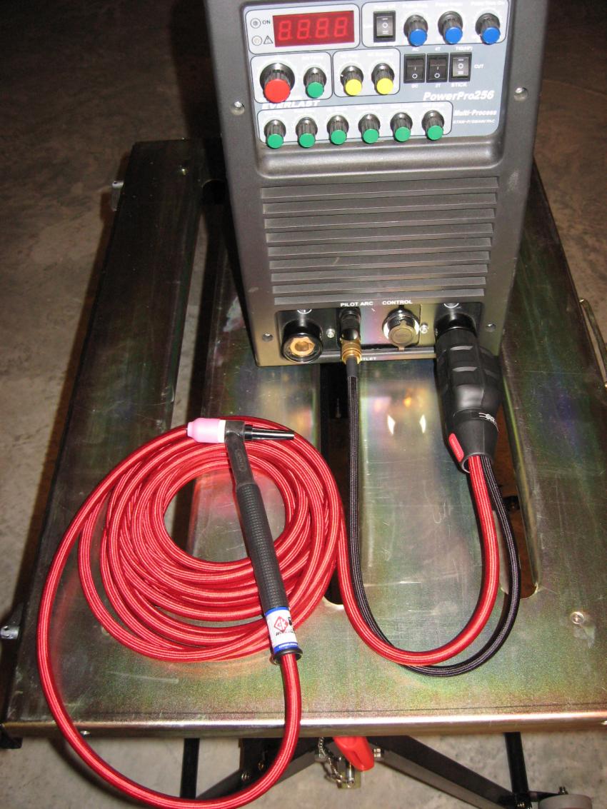

    Hey all was wondering where i can buy a new torch my my welder. it cam with a wp26, and also i dont like the thick bulky cable it came with. im looking for something really small. maybe like a 9. would also like to get a more flexible cable for it. I live in toronto. was wondering if any one had some suggestions where to get one . i would prefer it had the same conncetion on it to fit my welder so i can still use it with out having to take it apart.
    Everlast US sells the full CK line of torches but you'll have to call someone in sales. 877-755-9353
    The CK 130 is a 9 size and rated at 130 amps, 100% duty cycle in AC and DC but can take 150 amps at a slightly lower duty cycle with ease. The superflex cable is light and limp.

ID:	11530<this is my 130 but if you're willing to spend a few more bucks, the 130 flex-loc version would be my choice>Click image for larger version.

    Got this one from weldfabulous. Ck17 flex head with superflex hose. You should be able to see the part numbers as well.
