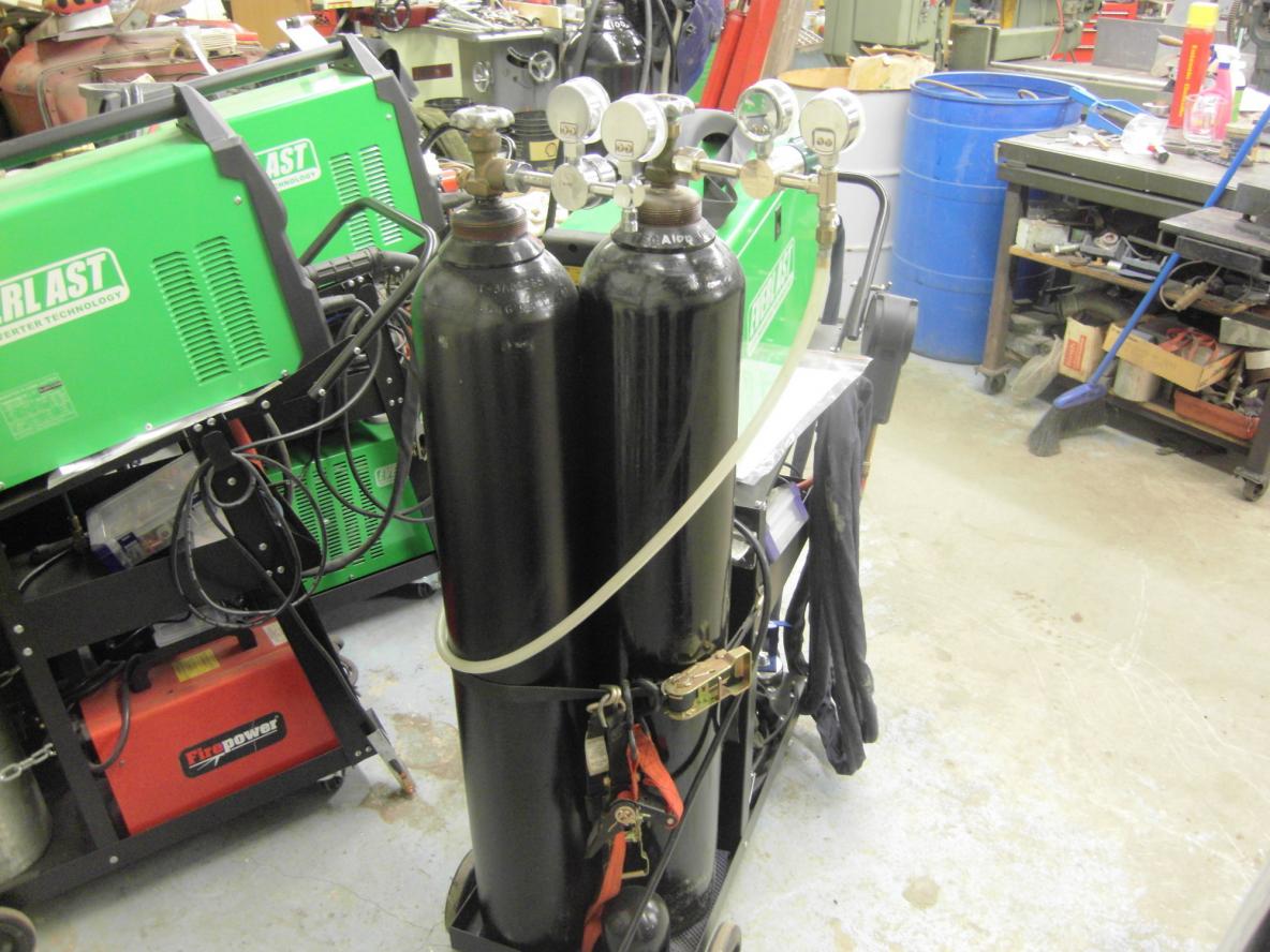

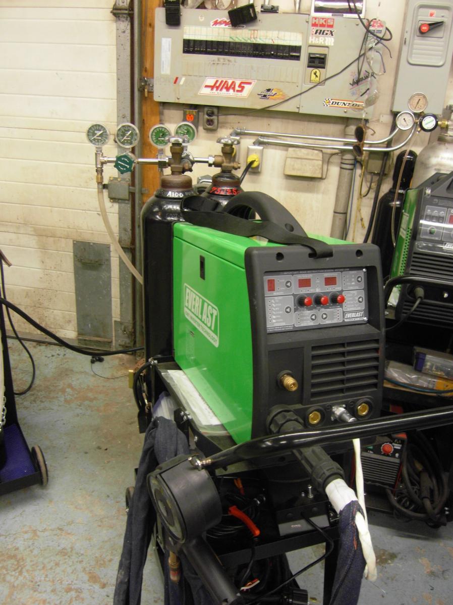

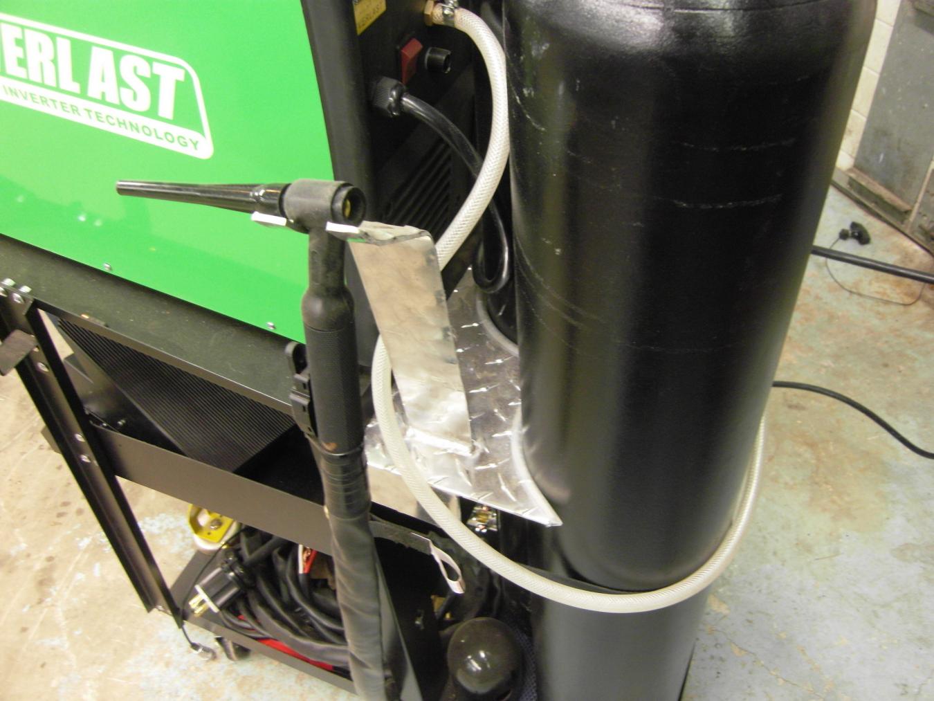

    How much welding do you plan on doing?
    I'd bet you will have way more headaches with a hard plumbed system than just having local bottles.
    The only places I have ever seen hard plumbed welding gasses are large manufacturing facilities that have argon stored as refrigerated liquid in a central location.
    If you are the only user and you aren't welding 8 hrs every day, I don;t see the benefits. Just opens you up for way more potential gas issues.
    PEX-AL-PEX is rated for air and works great, except it is not UV stable, so it must be covered when used outside. It should even be covered under fluorescent lights, but no one does. The damage would take a very long time to be a problem, inside. Maybe if you have lots of HID lights you would have an issue after years and years. But outside in AZ, I would not give it much time at all. The sun is crazy in the desert, especially at altitude, does all kinds of strange stuff to materials that last fine anywhere else.
    Your right it is not UV stable but most plastic are not UV resistant but up in the now cold part of the world copper pipe outside with water in it will split but the PEX will not. With this ice storm we are having and power out for a week the PEX will hold up but anyone with copper pipe will be calling the plumber. I still like the cart and the bottle with it, some of my carts I put two bottles one 25/75 and one 100% Argon.
