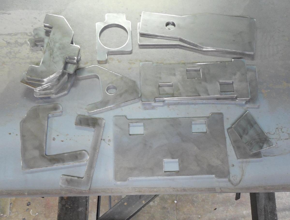

    I ordered the plans from Tom and for the $20 you get that just in cd's. Lots of pictures and enough drawings to get'er done. Unless you have lots of time I would suggest getting the pre-cut parts. Took me several days to figure out a wood pattern to cut some of the parts. The rest were rough cut and then finished in a mill.....aka a bit slower then full plasma cut parts. There are a few changes I would make if I did it again but they are just nit picky things like a 1/4" more here or a slight shift of part there.
    Ordered the plans mid Dec., base is done, x and y mounted, and electronics test wired and running on my desk. Surplus center is slow so today I will work on the Y drive and maybe the z lead screw.
    as of 2/25/14 69 sets of plans have been sold with 11 buying the cut steel parts with the plans. Change of shipping for the parts (Post Office went up) is $18.00
    have fun
    Tom

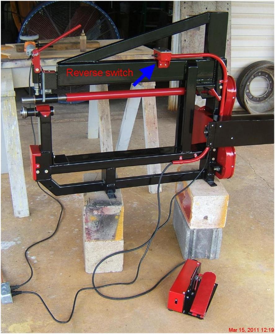

    Glad to hear you are making a few bucks here and there to help out with the hobbies. I work with a guy who developed a fairly extensive set of build/fab plans for some personal tracked vehicles that he sells on ebay. He makes out pretty well with them.
    It helps I'm retired and 70 I have another set of plans for a bead roller that I have sold 225 sets in 13 countries.
    there are sll kinds of plans out there and the web has made them easy to fine and enjoy.
    have fun
    Tom
