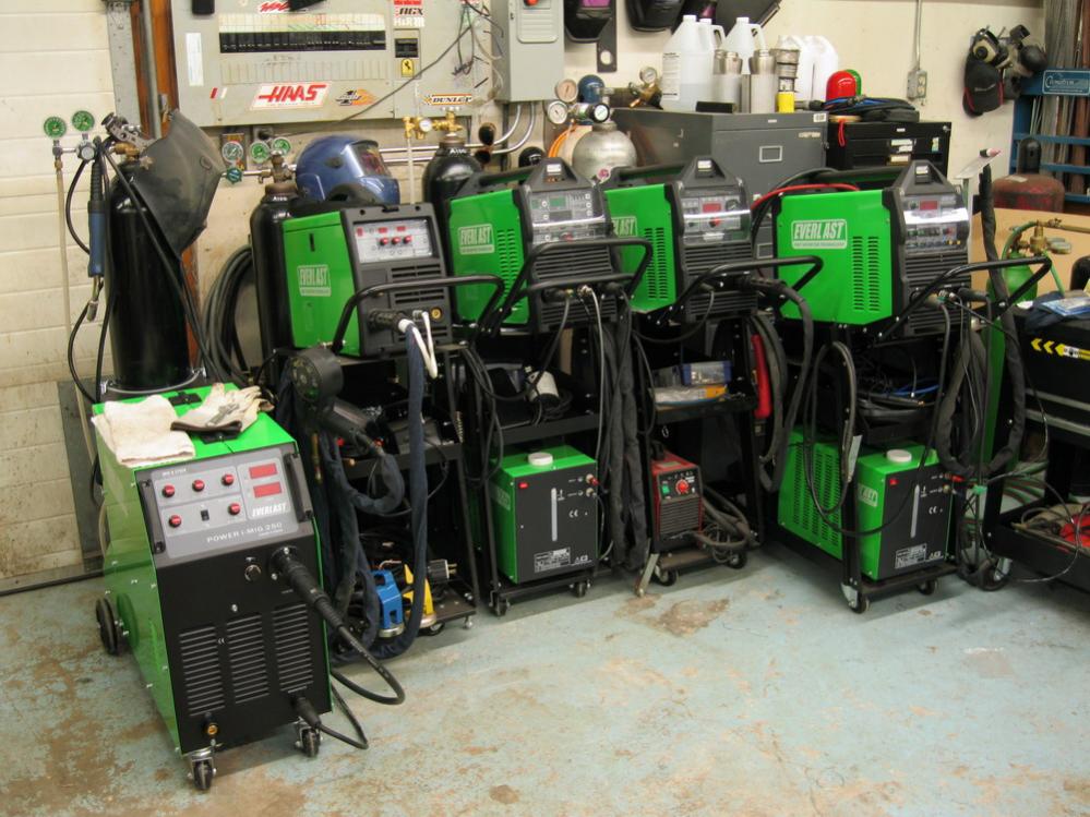

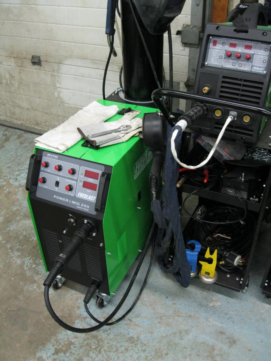

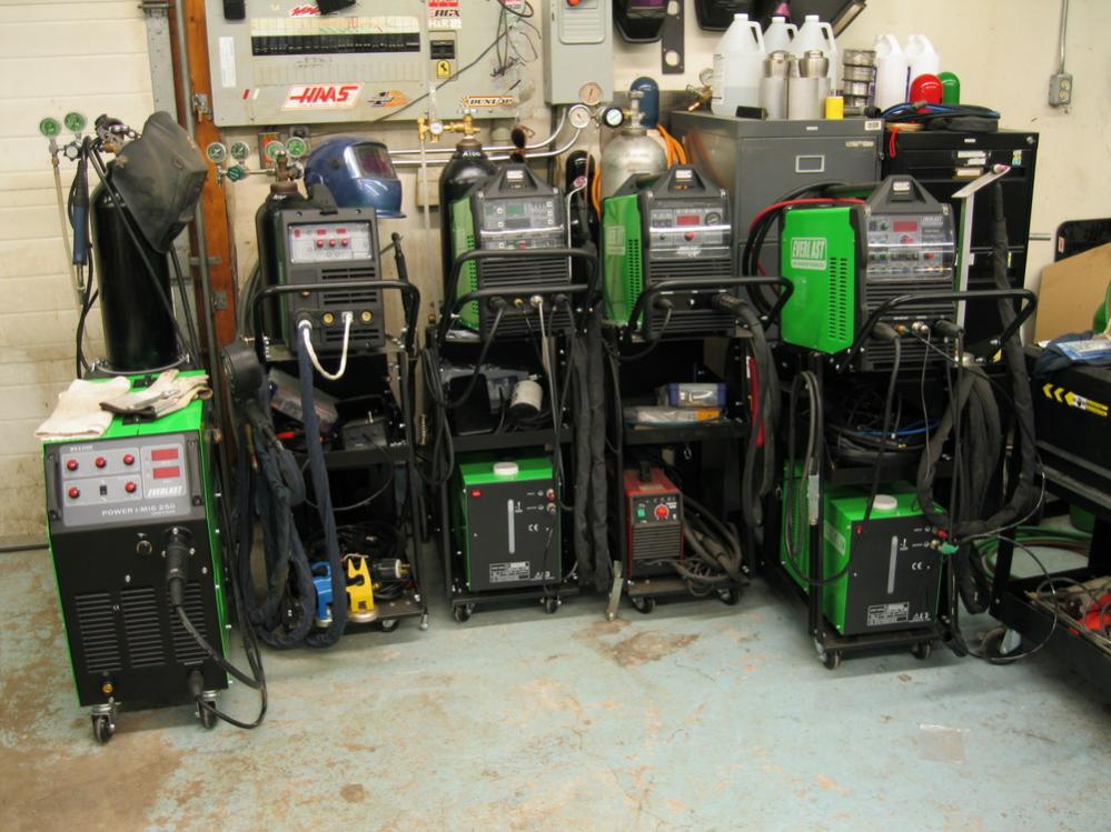

    I have both 250EX and 255EXT the 255 is still my favorite so far just find the setting and save it, then go to it anytime no switches or knobs to adjust just push the memory button till all the little lights light up on the one I see I want i don't try to memorize the number just the settings AC, DC, Pulse or just easy setup. Plasma cutter is separate and always ready to go. I just got the I Mig250 to see if I need a none portable machine and I like it now I have a big collection of Everlast Machines and having a hard time deciding on which one to sell probably the 250EX but I do like it. What ever machine or machines you buy you will like them.
    GOOD LUCK
