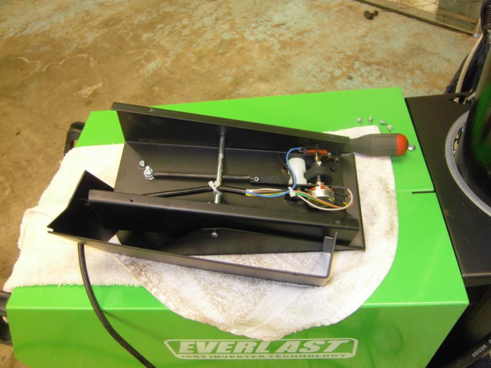

    Can someone post pics of the New Everlast Foot Pedal vrs the Old Everlast Foot Pedal. Oleg said it is a much better pedal than their original. I would love to see pics of the outside and the inside if anyone has one. Also, it is supposed to come with their new superflex cable and the handle is a CK style. The 17SR is the model number he gave me. I ordered mine with the foot pedal, so I think it comes with the foot pedal and the torch switch since the base model is a torch switch (correct?)
    Same, I would love to see pics of the old and new torches as well as the switch.

    Hi Glenn, I believe I have the new style foot pedal but haven't taken it apart yet. I can take a picture and post up later. From the ~2 hours or so I've been using my 250EX, all I can say so far is that the first bit of travel on the pedal activates the start switch and then the adjustment pot engages.

    This is two types I have they, both work very well.

    Thank you very much for the pic and even the inside pics. That's awesome. The new pedal is deff an improvement on the old. No belt and cog system, so it should be more robust and only be able to slip if damaged.
    Glenn
    Here is the new pedal and the new 17 Torch SR 17 is the model number of the Torch, the pedal is exactly like the new one posted above. No gear and belt system.
