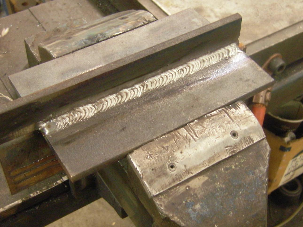

    Got my Power-i-Mig 250 test it out using standard setting of the MTS250S but tried the stitch weld see what it would do.
    Setting:
    Stitch Weld - Lowest
    Spot Weld - number 2 the first weld and number 3 second the weld
    Arc Force - 6
    Volts - 22.1
    Amps - 254

    Is this the iMig 250 or the iMig 250P? Spot weld on a filet?
    Quote Originally Posted by John71a View Post
    iMig 250 with spot and stitch welding.
