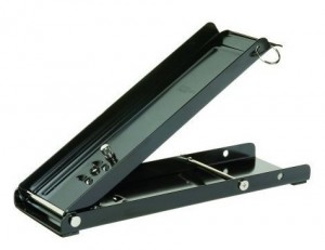

    What about something like this?
    You could even use a shorter power stroke with a ratcheting function for more leverage/power
    I've got nothing, maybe I will google, but I know I will have to have one. Harbor Freight sells one like the above, will not handle a steel can though..
    For a simple lever type unit your math also needs to take into account the angle of the lever over the travel range you want. Unless you have a ratchet type system or something else to reset the stroke length, your 1" fulcrum will not give you very much travel. Once you get to serious power, the time it takes to operate will go up to make it unpractical for lots of cycles. You can't buck physics, you have to supply all the power, so a hydraulic or screw system will give plenty of advantage, but it will be pretty slow. How about thinking more of something wall mounted, but foot operated? Then you can apply quite a bit of force and you won't need to multiply it quite as much.

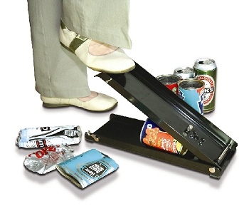

    I really like the crusher that I already have but it's limited to aluminum only. I've had such a hard time coming up with a workable solution that is aesthetically pleasing and I keep coming back to this compound nut cracker idea. But it too has problems. Auto eject will be an issue and so will the varying pressures over total mechanical travel, but it doesn't get any more simplistic then a nut cracker and it can definitely provide at least the initial crushing forces I'm trying to achieve. So I've been scouring the web and wouldn't ya know, somebody already makes pretty much what I'm thinking. Check this out:

    Apparently this thing can do steel cans and that works for me! It's no more hideous looking than my current can crusher and I can build this to be wall mounted and waist high while still being foot operated. The auto eject would be an issue but not the end of my world. I could crush every can I have with this, so this is what I'm leaning towards. What are your thoughts?
    Thanks guys,
    t3t4
    I think you should wear a more manly pair of shoes... But other than that, looks good!
    Father, all the cans are crushed and I am off to the ballet.
    Does the one shoe have a grounding strap? I imagine the open end of the can goes toward the hinge joint for people under 200 lbs hahaha..
    Sometimes fast and simple ain't everything. http://www.youtube.com/watch?feature...&v=VelCfJK77Cc

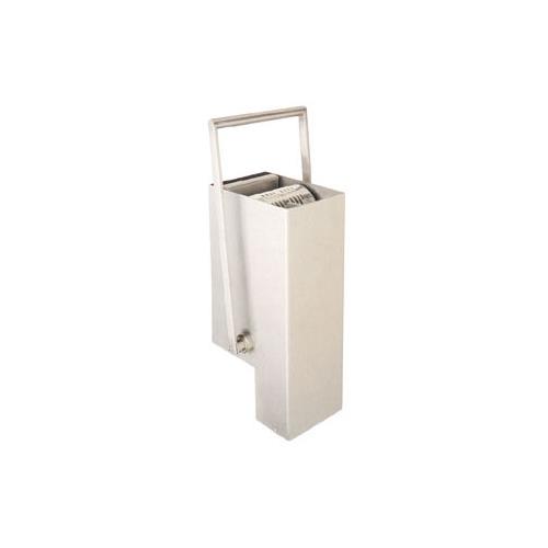

    Now picture this crusher in the vertical position and wall/stud mounted about waist high with a long lever extending down towards the floor. The long lever will operate a cam or eccentric wheel that closes the nut cracker simply by stepping on it or pushing it with your foot. That's where I'm thinking when I say a "compounded nut cracker". It's force multiplied and simple, and too with the thing mounted vertical like the letter "V", once you step off the foot plate it should auto eject.
    Picture this being foot operated below:
    That's about what I'm thinkin though and compounding the levers should make this thing very easy to operate. A 7 yr old child should have no problem crushing a soup can.

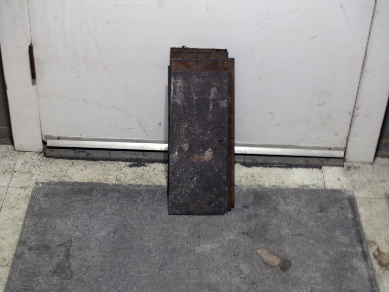

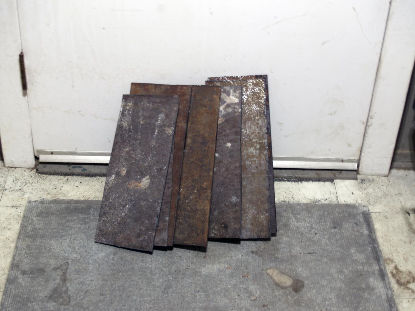

    Quick update on the can crusher:
    I'm having issues with my hosting site right about now, so this will look different and be a bit more cumbersome for you guys/gals, but you still see what I see. This is how the can crusher begins....
ID:	11775Click image for larger version.
    I plasma cut enough to build 2 can crushers. I did so because I'm confident that I will screw up at least one of them, so I have material in excess to compensate.
    I'll keep ya's posted.
