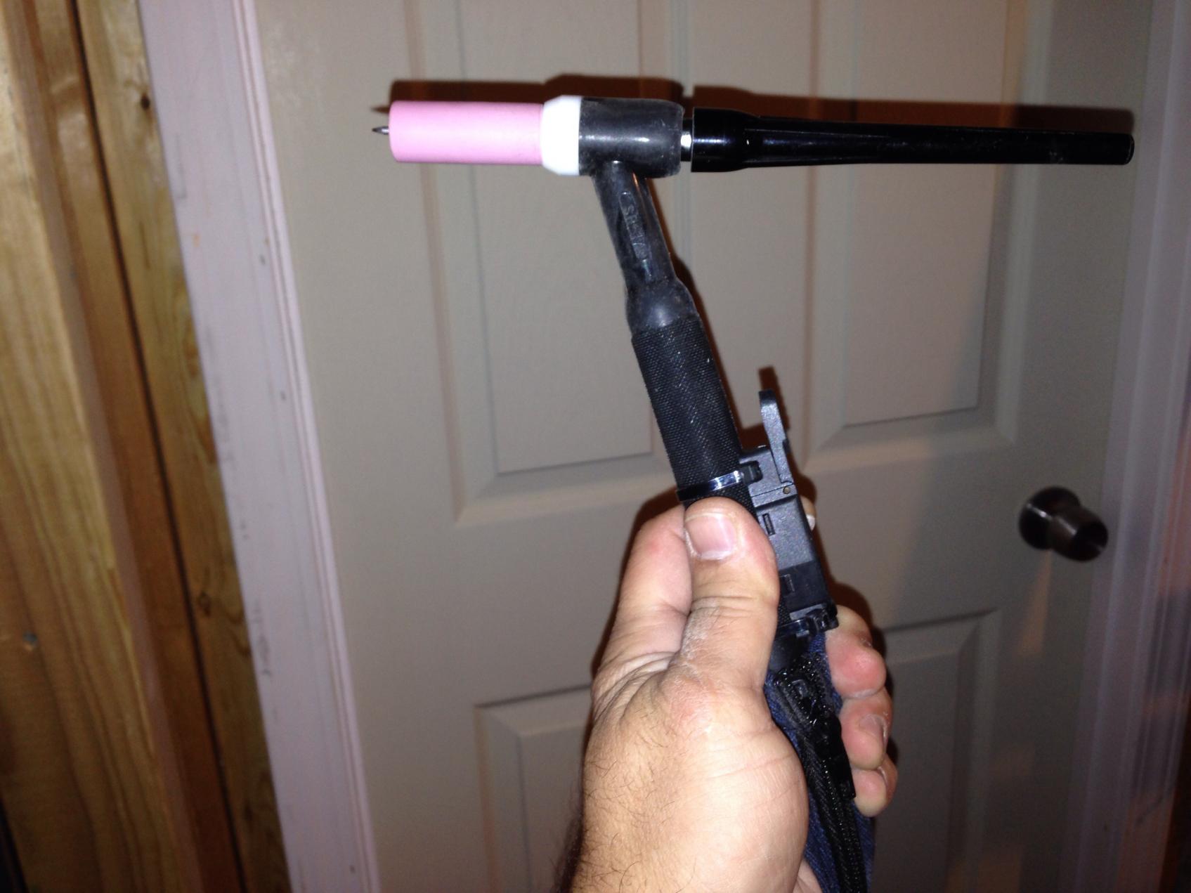

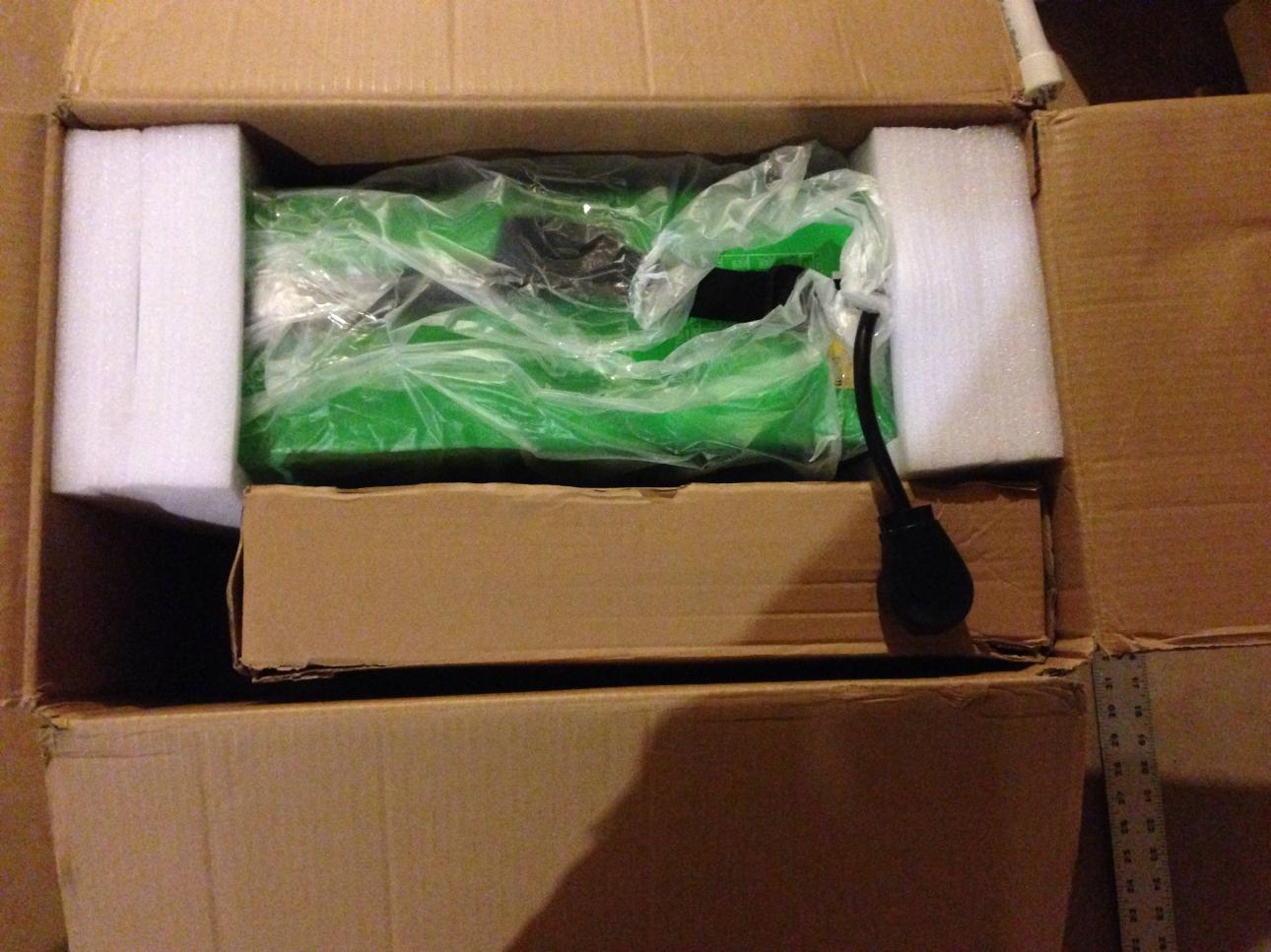

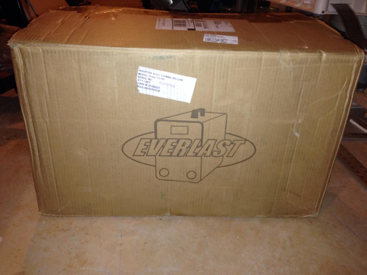

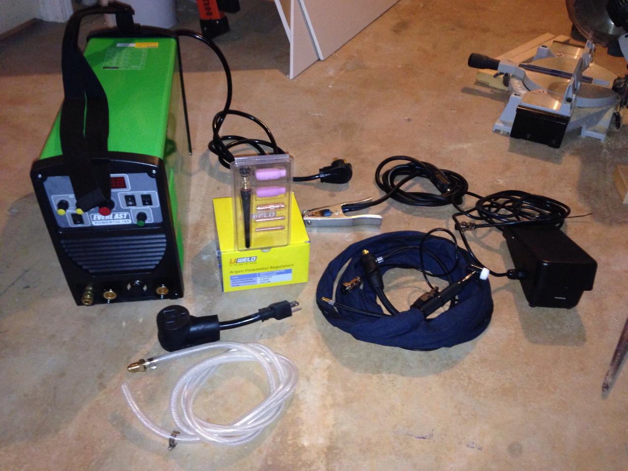

ID:	11491Ok, unit arrived today safe and sound. UPS did not break it. Packed very well in a sturdy box with foam inserts to protect the main unit. Everything else is inside another box.

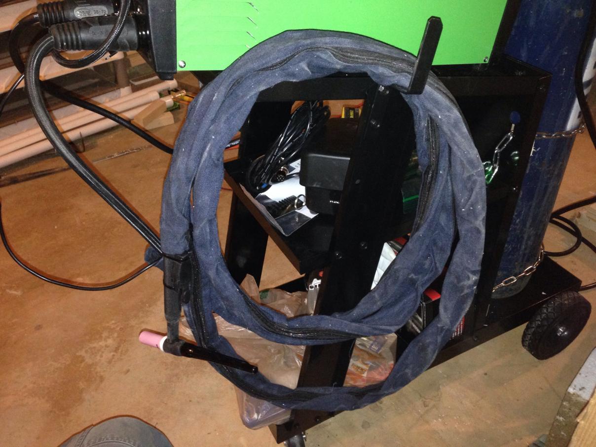

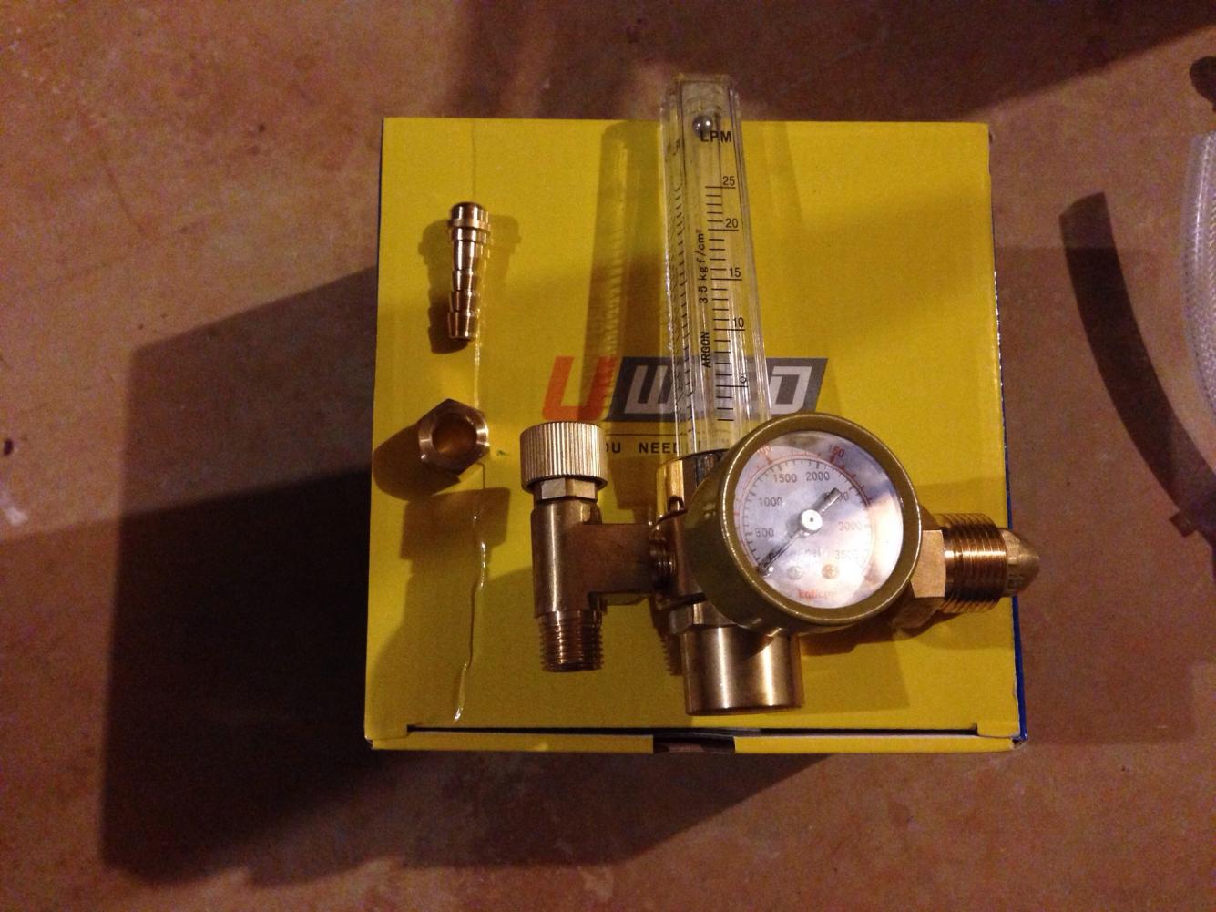

    New regulator is all brass and deff seems on par with the affordable regs at my local supply. New SR17 torch is nice and flexible. Has the switch attached at the bottom via some zip ties. Simple and works. Comes in a denim like zip up cover to keep from abrading the lines. It's 12' long and feels just as good as the Weldcraft 17 torch. New foot pedal is smaller, smoother and with the 2013 Powertig 185 it maxes out where the amperage knob is set. Great new feature on this model. I was told the older ones did not do this. That the pedal over road the knob.

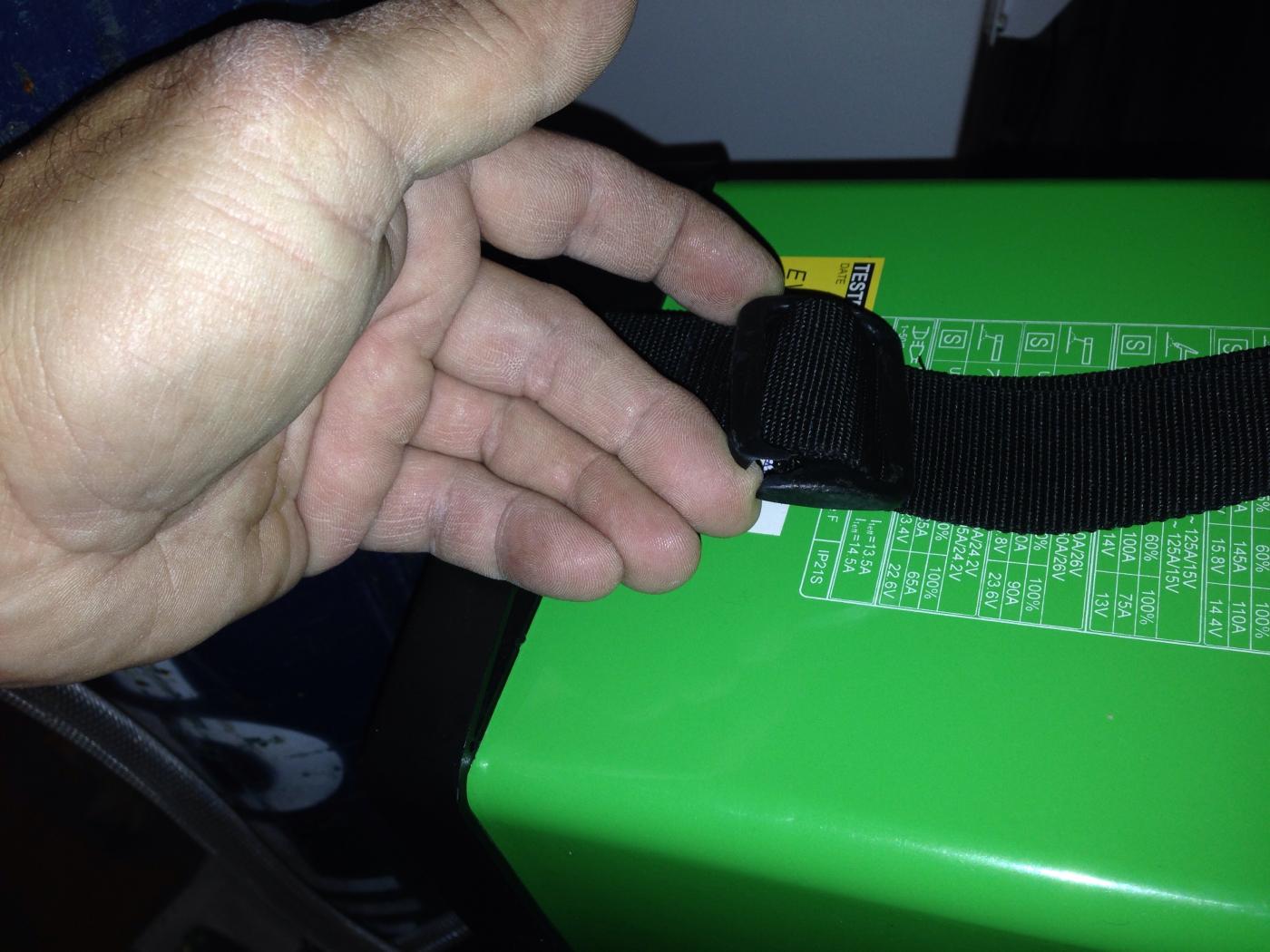

    Only thing broken is the buckle on the carry strap. No big deal.

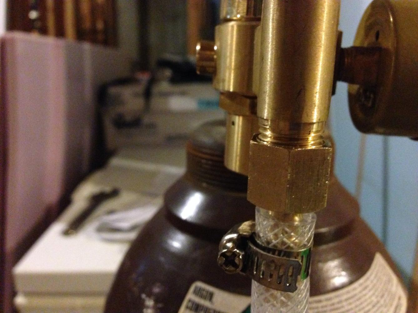

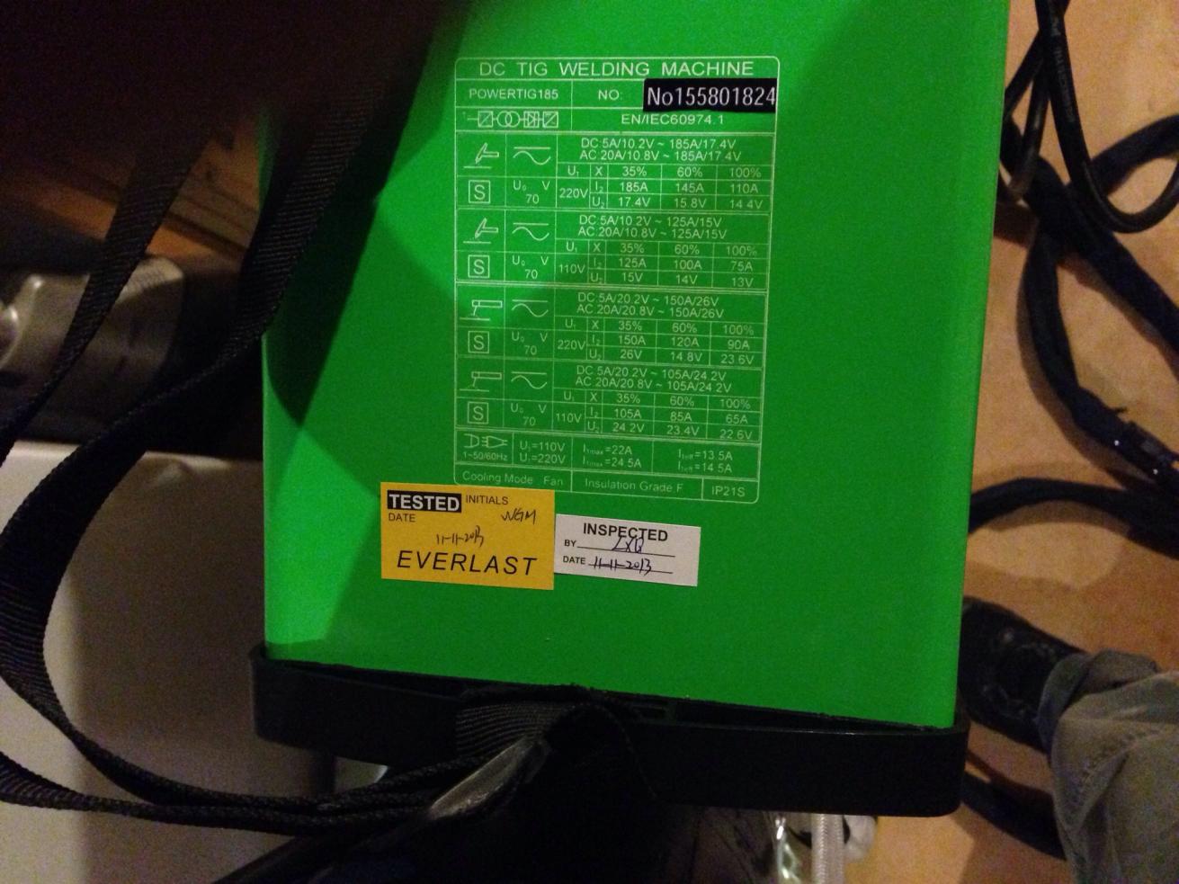

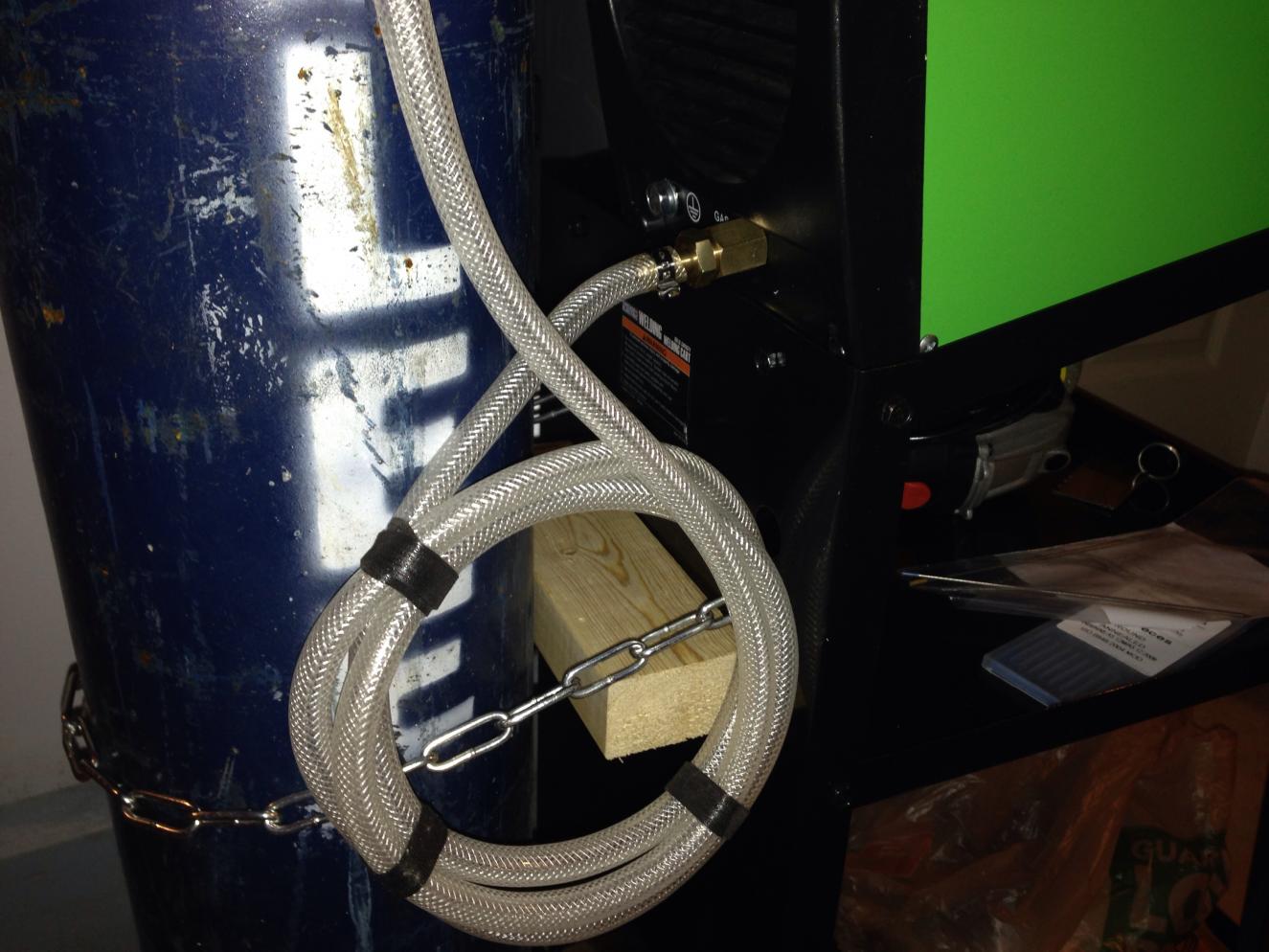

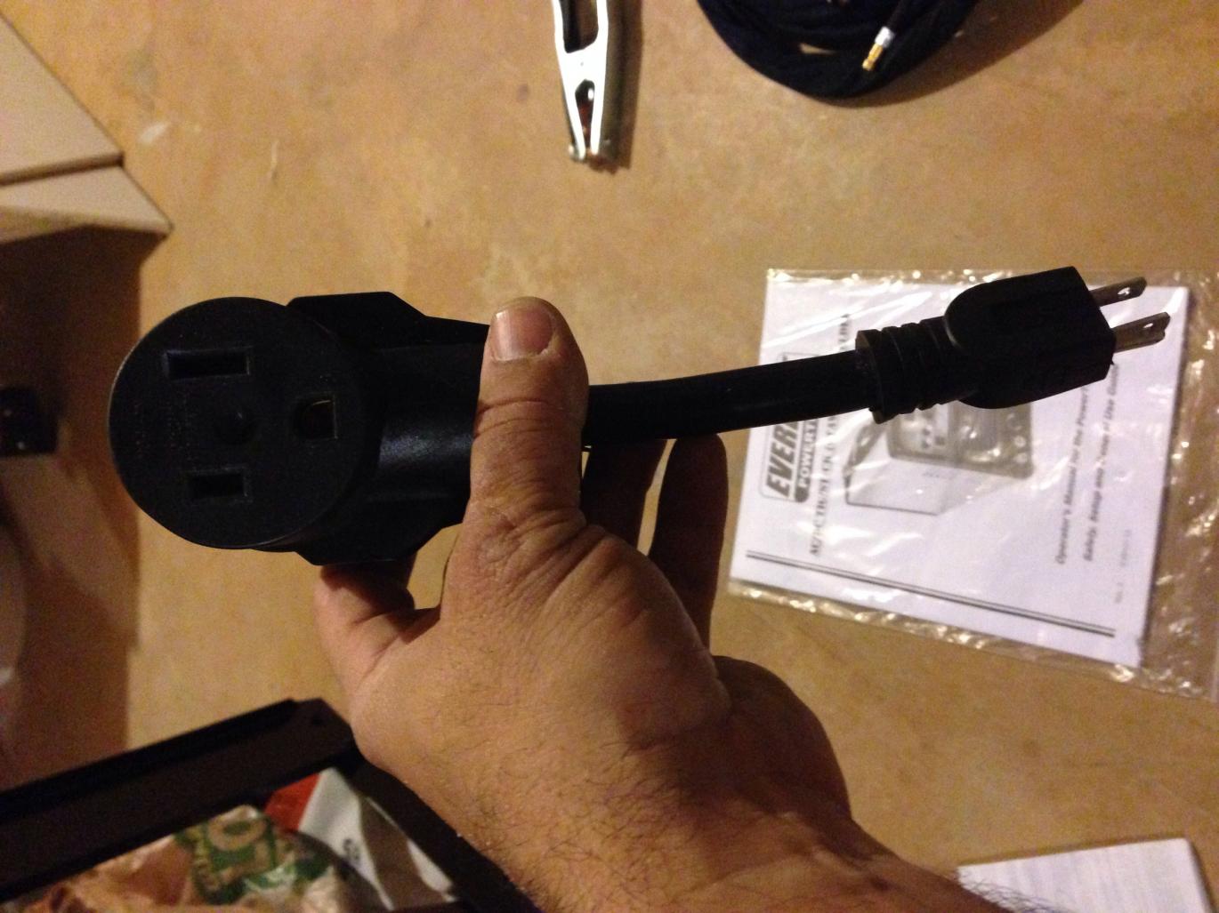

    The only hickup in setting it up was the clamp to hold the argon hose to the barbed fitting on the regulator. It came with a standard hose clamp and I could not get it to stop leaking. I swapped it out for a fuel injection clamp and that stopped the leak. Plugged the 110 adapter into the 220 pigtail, plugged that in the wall and powered it up. Unit went through a power up and power check sequence, it realized it was powered by 110 and set itself. Max amps shown on my unit on 110 was 130.
    Test and inspection stickers on the back of the top cover.

    Nice to see your successful setup and first weld. That new style regulator looks like a copy of a TIGmaster, right down to the square flowmeter. Does it have different graduations on each side?
    I'm pretty sure it's the same LPM on all 4 sides. I'll check it when I get home and let you know.
    Glenn
    Look more like the HTP Argon reg.
    Glenn

    Went down and looked at the regulator again. Front has graduations for Argon, right side for co2. Both in LPH
