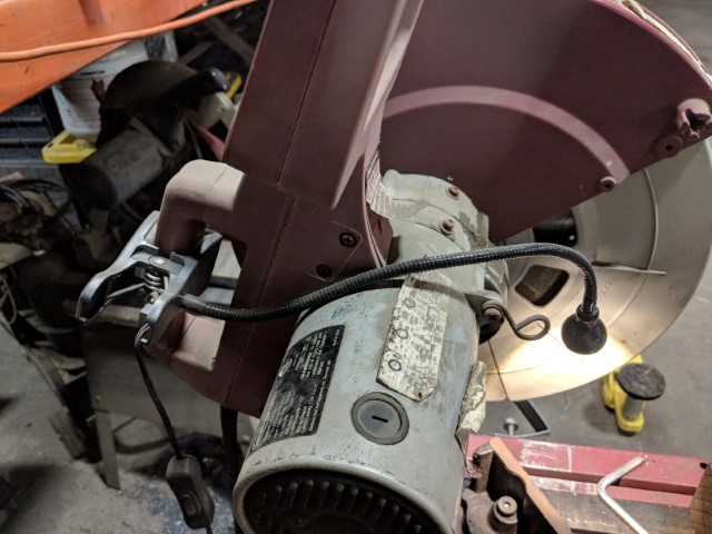

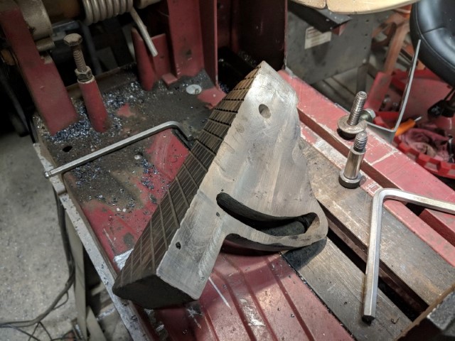

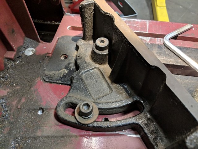

    Here are some of the changes I made to the saw.
    The fixed vise jaw was not quite square to the table so I re-machined the base perpendicular to the face and bored the pivot hole parallel to the face and a close fit to a shoulder bolt. This way it pivots with no slop, so I can someday add a stop for 90 and 45. For now I just set it with a speed square.
    Added a gooseneck clamp LED light from IKEA, and a cast iron handle from McMaster Carr.
    It's too bad they stopped selling this saw. The current version looks bogus with many parts now made from pressed sheet metal instead of cast iron.
