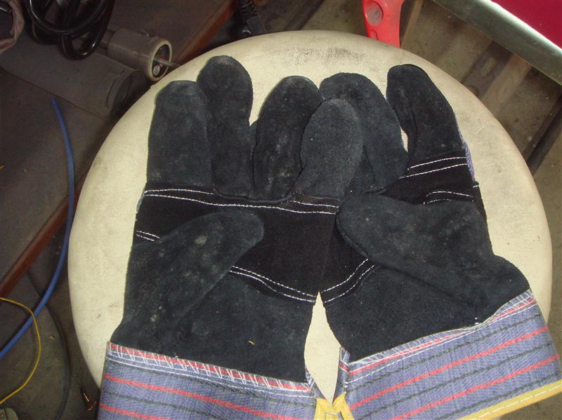

    There is a pair of gloves in the box with the saw, an man do they STINK, Hung mine out in the garage for the winter

    Like Gerry, I also got a set of slightly moldy gloves in the box. Don't know whether that goes in the plus or minus column.

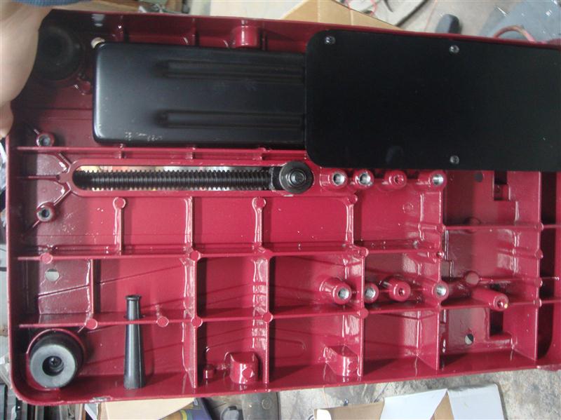

    My initial take on the saw is that it's going to work out fine for me. First the good. The base is a die cast aluminum not a stamping, but it is pretty thin. The vise jaws are cast iron with machined faces. With a few holes for different locations, including one set that isn't drilled and tapped. There are also angle graduations at two locations, with an adjustable pointer.

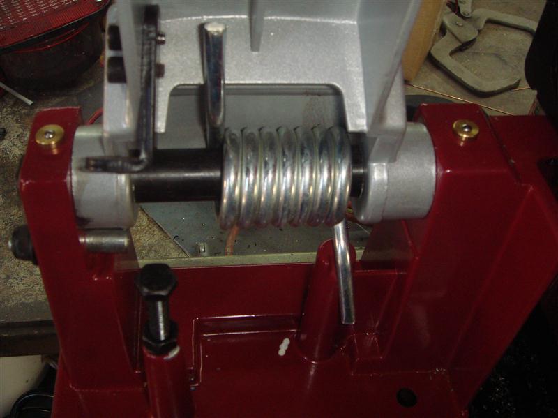

    There are lubrication ports for the pivot.

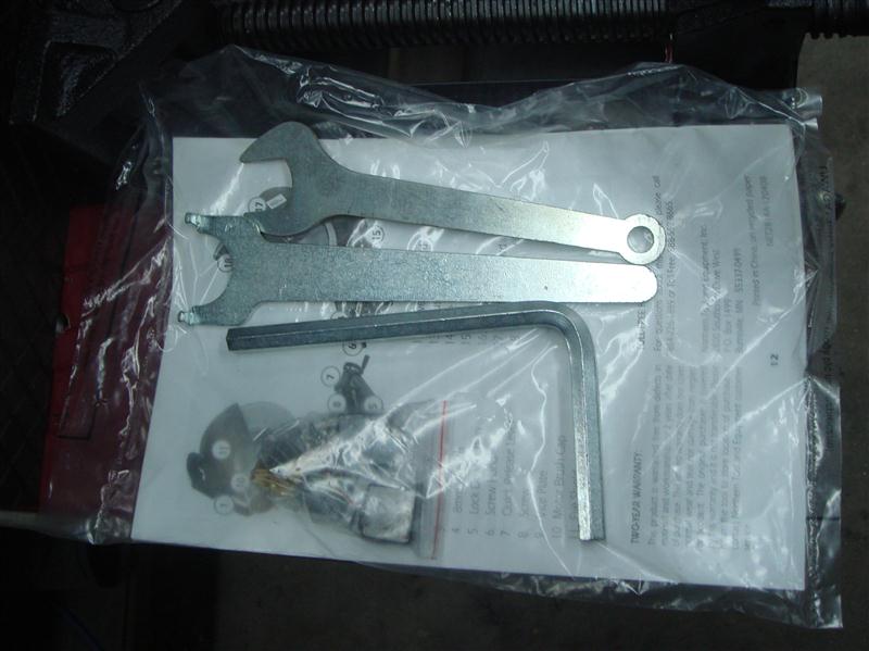

    Came with an extra set of brushes. I have a drawer full of them from many tools over the years, but have never needed any. Also there is a nice hex key that is long on both sides for the vise and the blade retainer.

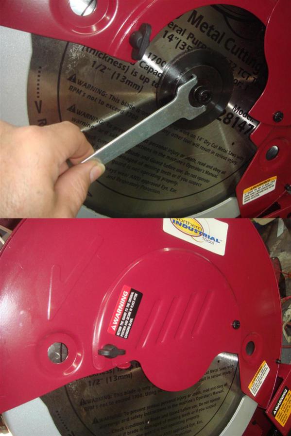

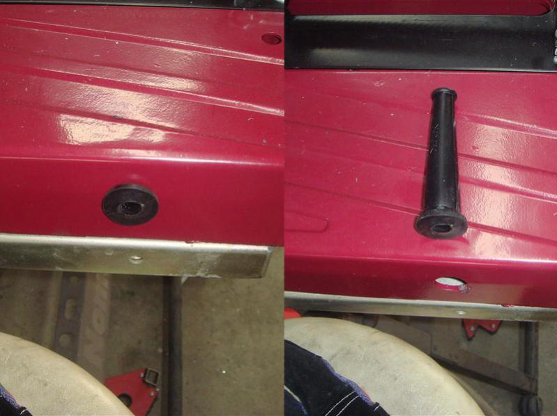

    The blade wrench storage grommet is also a spare cord strain relief.

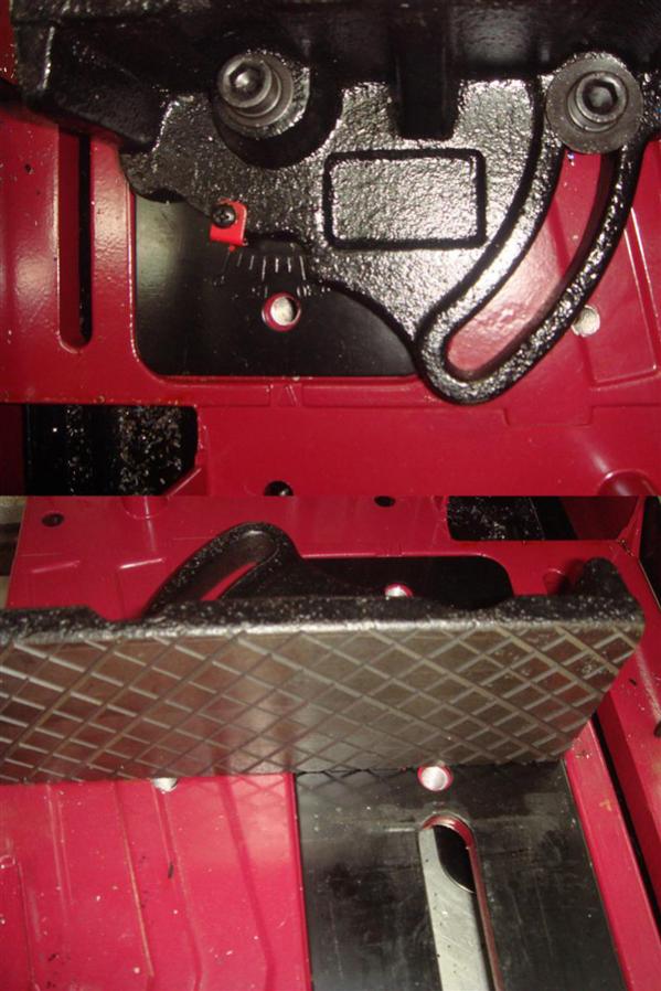

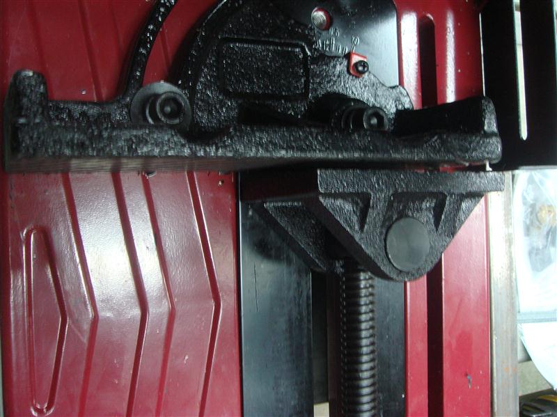

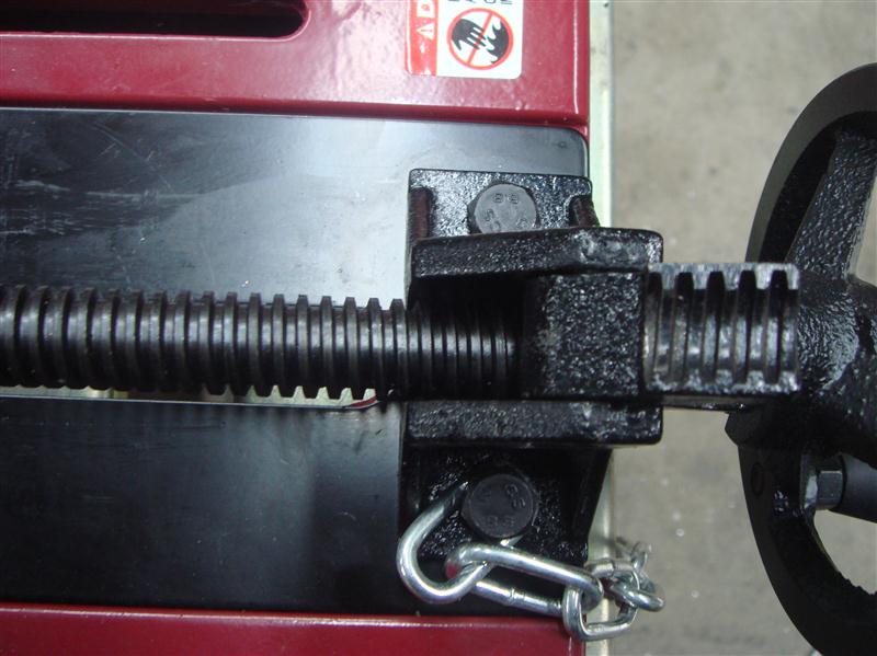

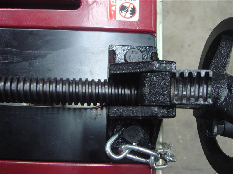

    The acme threads on the vise are crisp and well formed, and the moving jaw rides on a steel plate to reduce wear on the base casting. The vise handle is cast iron, as well.

    No spindle lock, so you have a pin spanner to hold it when you change blades. I notice that several brands of these saws have blade vibration dampers in the guard, this one has holes for some, but none are installed.

    The halfnut for the vise is more like a quarter nut or a third nut. Since the threads are good I think it will hold up. Only time will tell. Also in the standard position the jaws only close to about 3/16" or so. Not so good for cutting 1/8" flat bar. Would it have broke the bank to make the screw a little longer?

    No bushings for the pivots, the shaft rides right in the aluminum casting. If well lubed it should last pretty good, and I can bore for bushings if it ever gets too sloppy.
    The hole in the vice for the pivot is a little oversize, that combined with the poor fit of the threds for the pivot bolt makes the vice pivot too sloppy to use with index stops. I belive there is a fix for this, as I would really like to have 90° and 45° stops and there is an area in the vise jaw that looks like it was made for a stop pin to ride in. Either a shoulder bolt or better yet a shoulder stud can replace the pivot bolt. The thread fit bothers me, but often it is the bolt that is undersize and that's easy to fix. I haven't measured anything yet to confirm. The cast bosses are a bit small to fix with a thread insert or a larger bolt. These are all pretty small gripes.

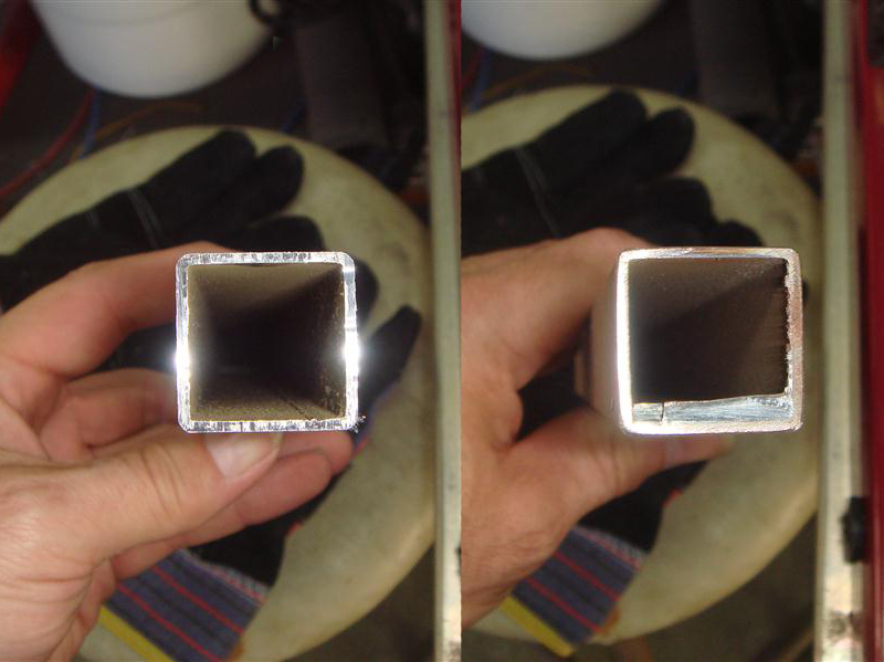

    Here is the first cut compared to an abrasive chop saw. While not burr free like a cold saw, the burr is only a few thou, nothing like the chop saw cut, on the right. I still have to square everything up and see how accurate the pivot is to the base. I am very pleased with everything so far. For the money this looks like it will more than do the job for me. I've had more than enough of breathing that chop saw dust or cleaning up all the grit. Now I just need some of those diamond grinding discs, for angle grinders, that Jody showed a while back, to rid myself of the other abrasive grit generators.

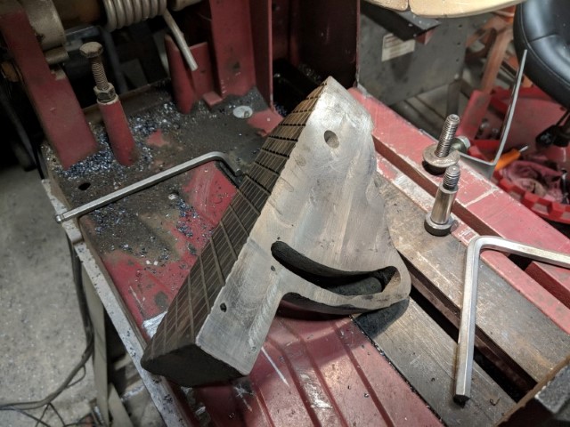

    I bought the same saw when it went on sale locally and I couldn't be happier. I've cut a ton of 3/4", 1", 1 1/2", and 2" tubing with it and it's still cutting like new. The only thing I don't like (beside the rough castings) is that the saw throws small hot shavings back at you sometimes and I've actually had a couple of them put little burn marks on my neck. For $200 I'd buy it again.

    After using it more, I really like it. Initially the blade did have some vibration that effected the cuts a little, but that has gone away now and it cuts very smooth. Maybe due to some breaking in and some operator practice. I expected it to be great on tube, but wasn't sure how it would do on thicker items. Well it is fantastic on the thick stuff that gives an abrasive wheel fits. I cut a bunch of 3/8" wall mechanical tubing and 1/2" plate slick as can be, then tackled a 2" solid steel bar with no trouble. I put a little Saw Stick dry lubricant on the blade to extend the life and keep aluminum from grabbing or welding to the blade. Of course it goes through aluminum fine, too. Because it's handy, I imagine I will be cutting all kinds of stuff, just because it's right there. I used it to cut some 2" PVC pipe, and there was no chipping. I know it requires a different blade for stainless, but so far I do so little of that, I doubt I will get one until I have a job that requires it, to bill it against. Still haven't made a stand. The one I have for my chop saw isn't made anymore. I bought something like it, but I will either have to modify it a bunch or just start from scratch to get what I want. I know getting it down lower will also help the hot chip issue that was mentioned. As long as you stand out of the plane of the blade (good safety practice anyway) it's not really that bad, but you'll still catch the occasional hot one.
