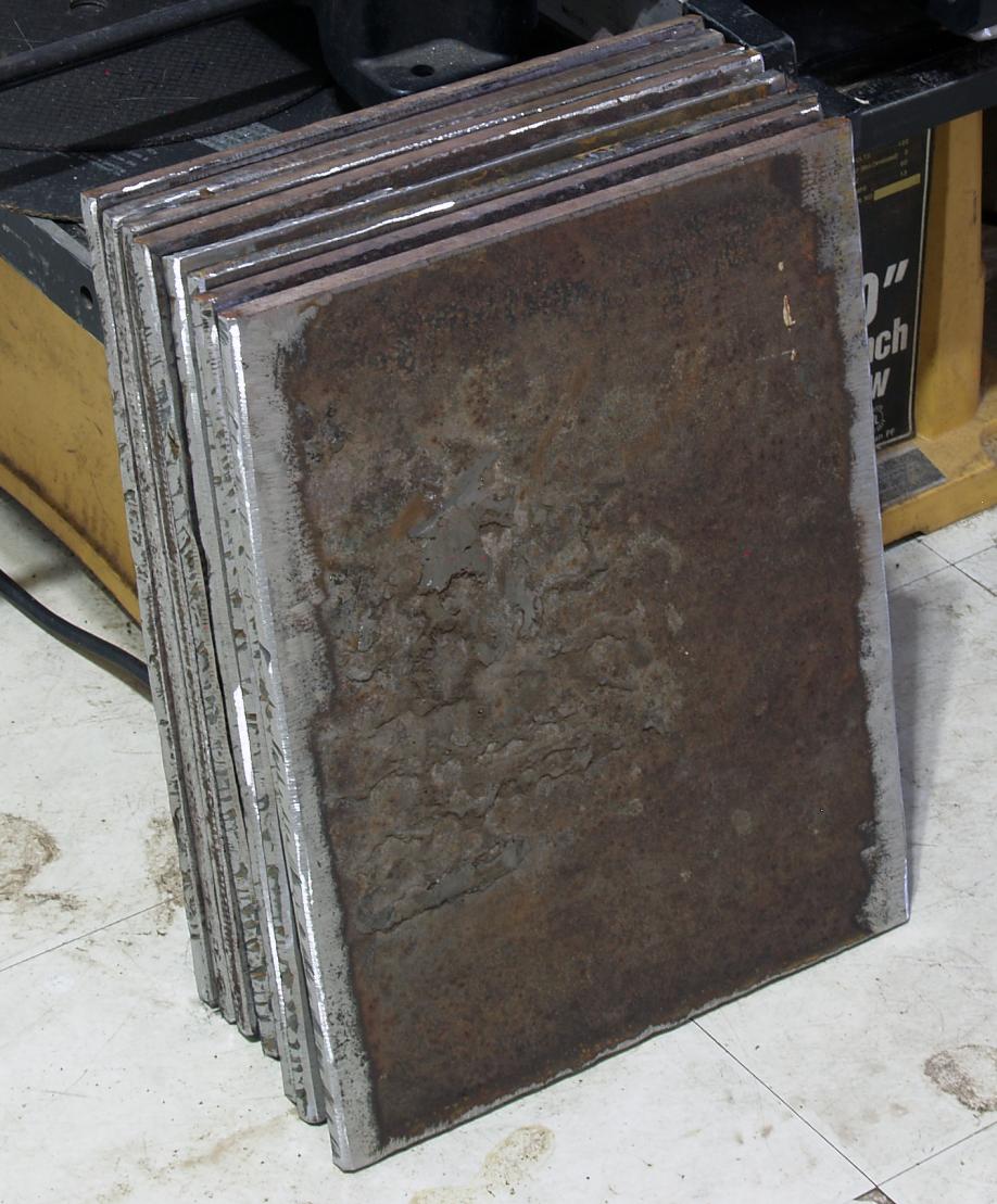

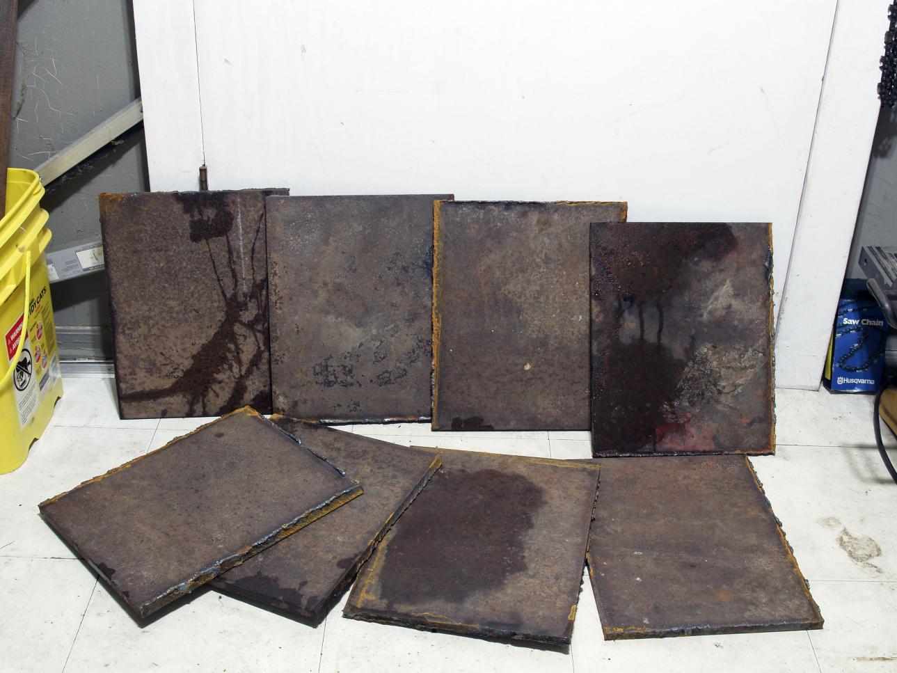

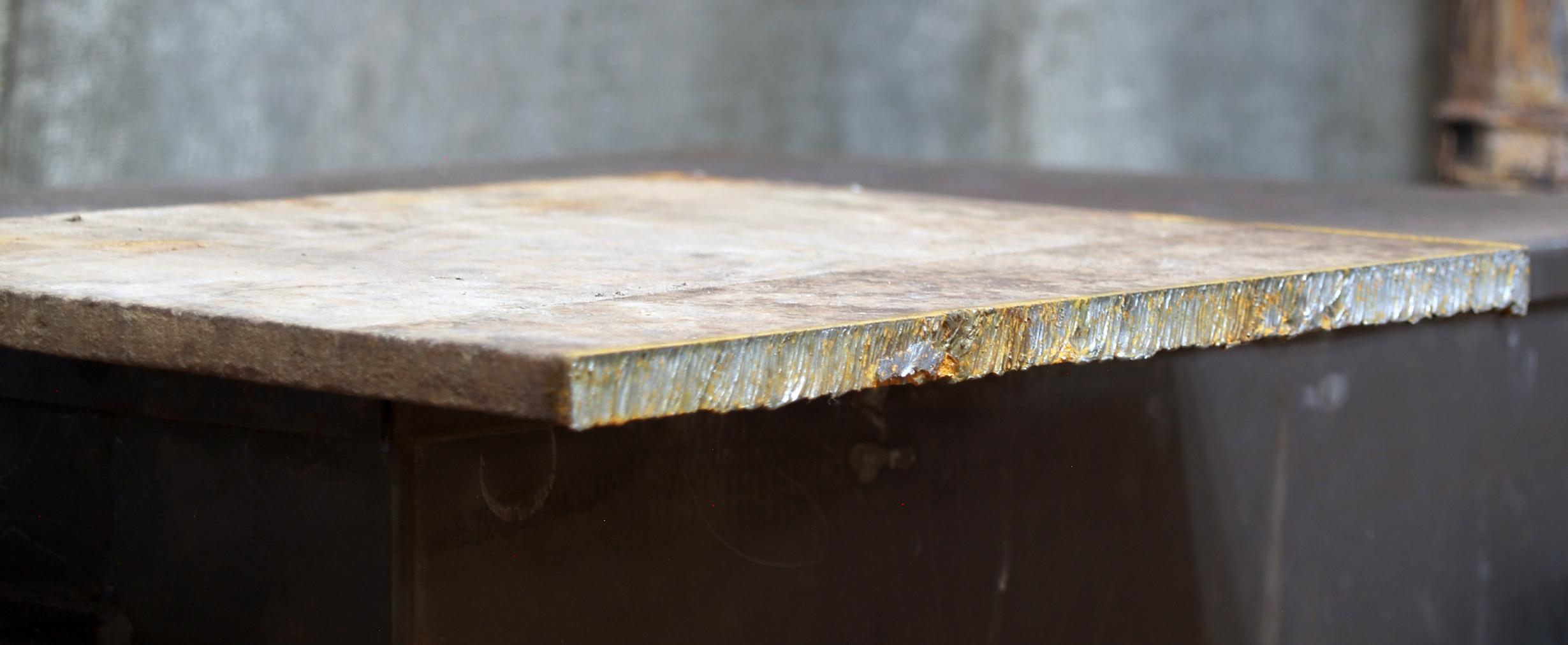

    This stuff cut like crap! I know my way around a plasma cutter and the machine I used to cut this should have no problem what-so-ever. I had new consumables and a good ground, but I'm here to tell ya I fought like hell to blow through this stuff! So what the hell is it? Some kind of steel of coarse, but it's like nothing I've cut before and I could barely move at 2" per min. I'm using a Thermal Dynamics 80 series plasma cutter which can do 1-1/4" severance and that's what it felt like I was cutting!
    You can do this above if you move slow enough. But who want's to cut at 1" per min? Hell, you can see twice where I stopped and took a break over a 14" cut!

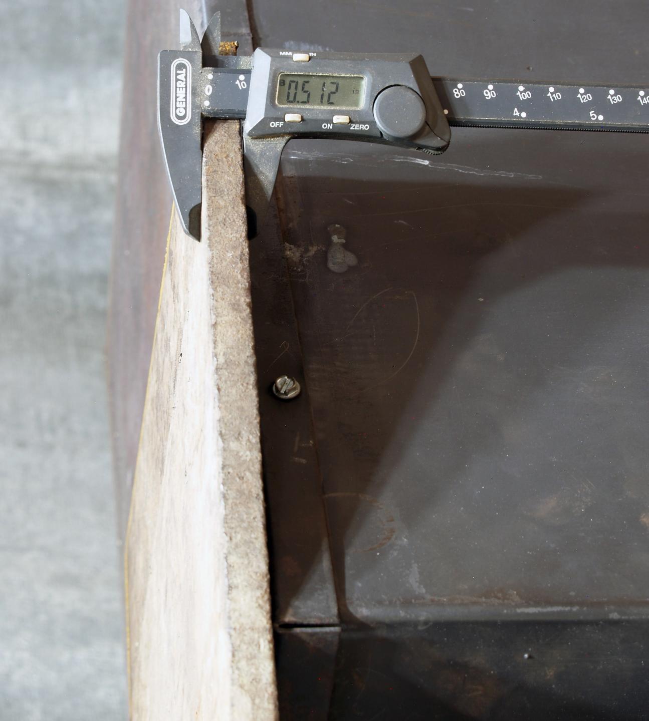

    See, it's not even half of the capacity for this machine but I was still maxed out. So what the hell is this stuff?

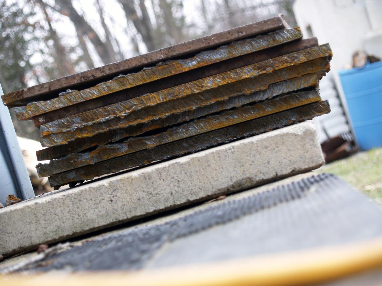

    Ehhh, something like that I guess. It's the last fire pit I'll ever have to build and that is what it's going to be, however, I still don't know what it is! I've never cut anything this hard so I can only wonder about how it welds. I'll use some 6011 rods and arc weld this, or at least I'll try!
    So now I'll just do my clean up work and get this thing together. But this is some old-school American steel that was sitting in my fathers driveway for about 20 years until I picked it up. It has surface rust at best, hell, we all used to drive on it when we were kids. But this stuff has been out in mother nature for so long, so many years, and this is all it has to show for rust?

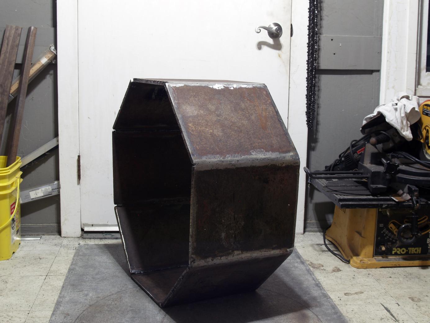

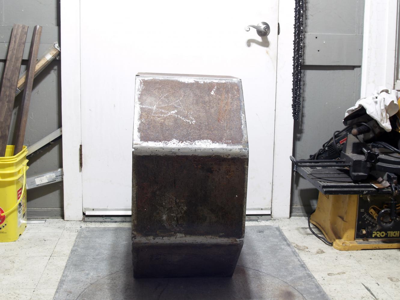

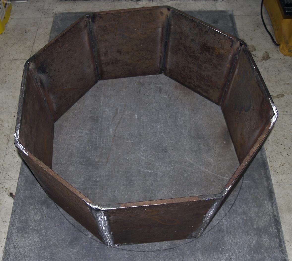

    Did some clean up work and wound up with this below:

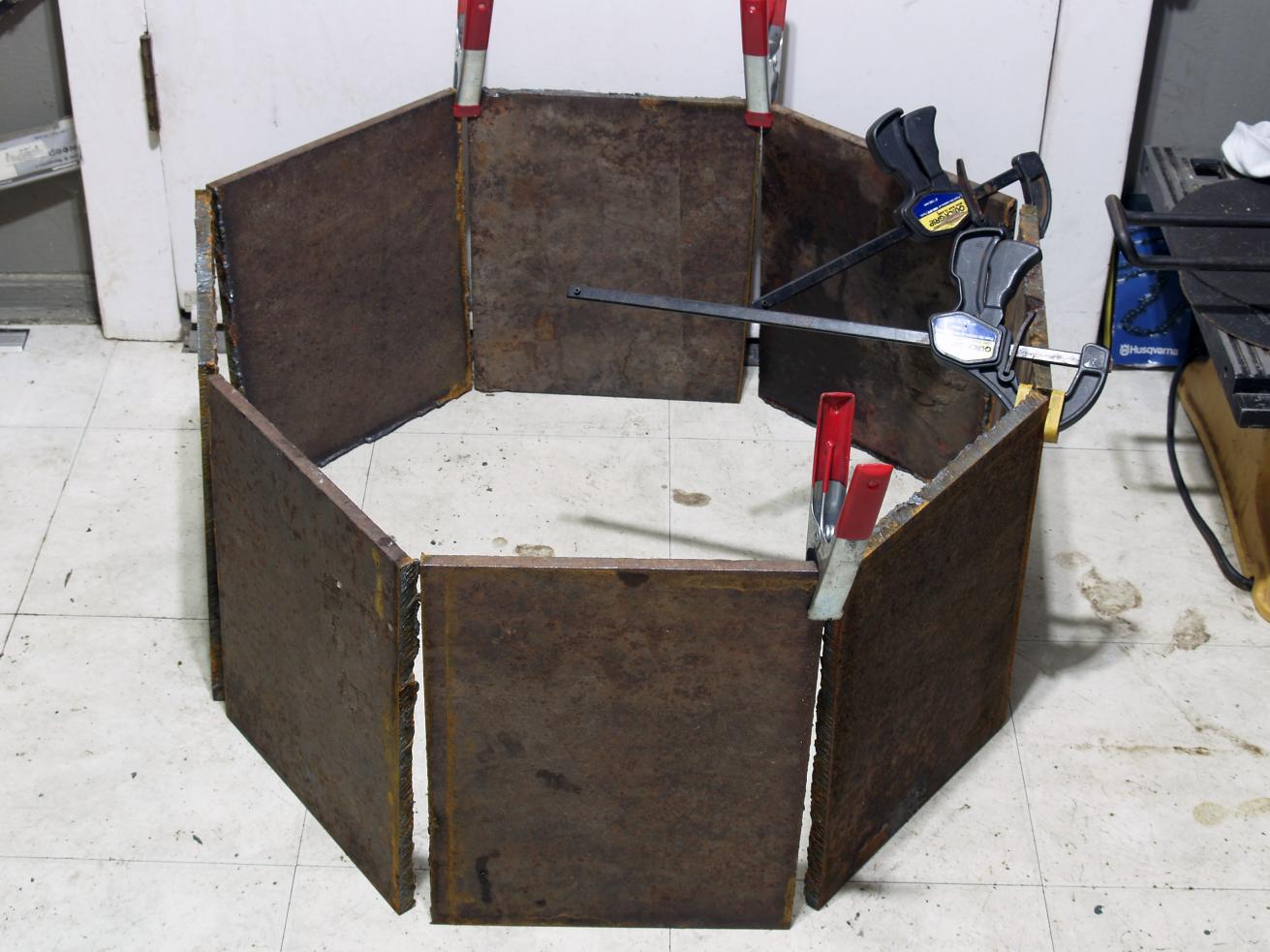

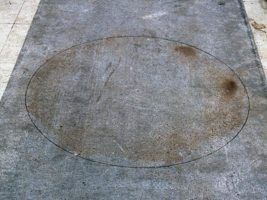

    I have a template that I made for my fire pit, I drew the whole thing on aluminum foil because I knew I would be setting on and welding upon but I always need to see the lines and I do not want hot sparks to catch paper on fire. So, aluminum seemed like a good choice. Yeah, in theory maybe! Just so you know, that idea doesn't work when you have 8 plates and only 2 hands, one of which I need to hold a stinger/gun! The plates fell over so many times they tor threw the foil and wrinkled it to the point of inaccuracy. I was just about pissed off and ready to kick something when suddenly I realized I was going about this all wrong! I took a break, I drank some coffee and smoked some cigarettes, then went onto the worst part of this build, tac welds....
    Why are tac welds the worst part? Simple, because that's where you get straight true and plumb, everything else is just melting metal and filling groves. I have no good way to hold 8 plates parallel with only one hand, but I can hold 2 plates on a flat surface! And so that is what I did, 1 plate x 1 plate tac welds. Oh I had to push and stretch and pull some, but I can do that with tac welds. So it looks like this below:

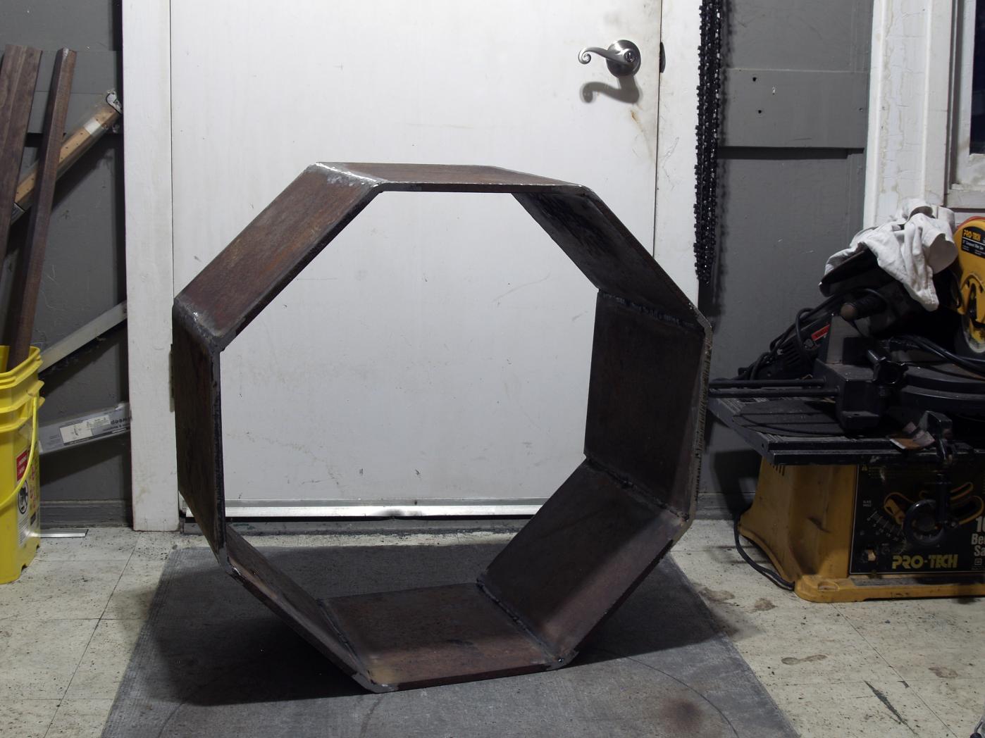

    So now the hard part is done, I'm close enough to where I need to be and ready to lay some heavy beads. My focus is on the inside right now, when I have full length beads run there I'll move to the outside. Sorry for the blurry pic above, I didn't know until it was too late. But whatever, it's damn close to plumb and most of the plates are dead plumb, you'll see.

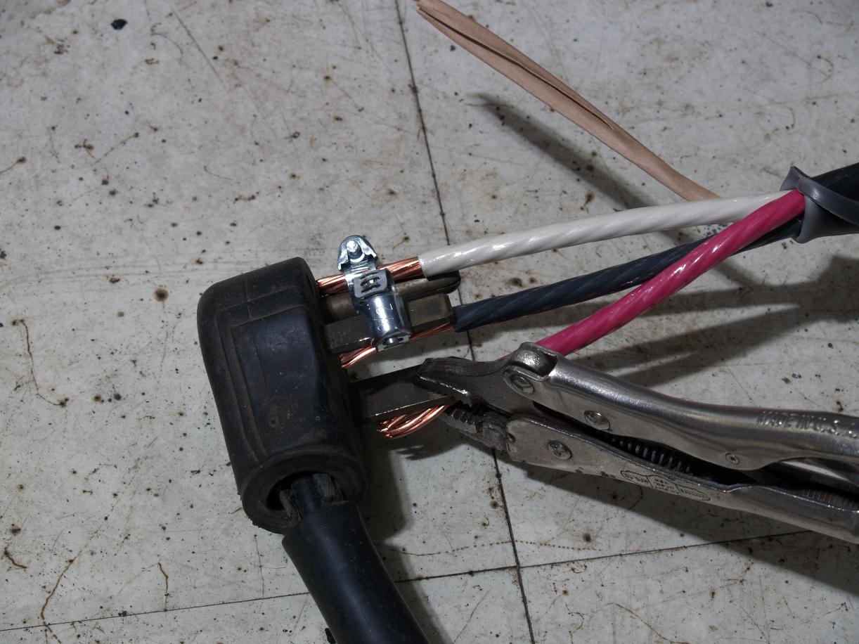

    But I had another issue before I can weld this. I planned to use my little mig welder for tac welds and my arc welder then to send it home. Well, I didn't realize at the time that I cannot power this thing below:
    I don't have 2 identical 220 vac outlets in this house, let alone a female receptacle for a 50 amp welder! Why the hell can't 220 be an industry standard? There must be 15 some odd possibilities for a 220 receptacle, no joke, I've looked! The problem is, I didn't look soon enough and when it came time to do what I had planned, well, I couldn't! Oh sure I could rig something to work, but this was supposed to plug and play according to my game plan. And you know what they say bout best laid plans,,,,,,screw it, there ain't nothing to but to do it! And so I did it with plan B:

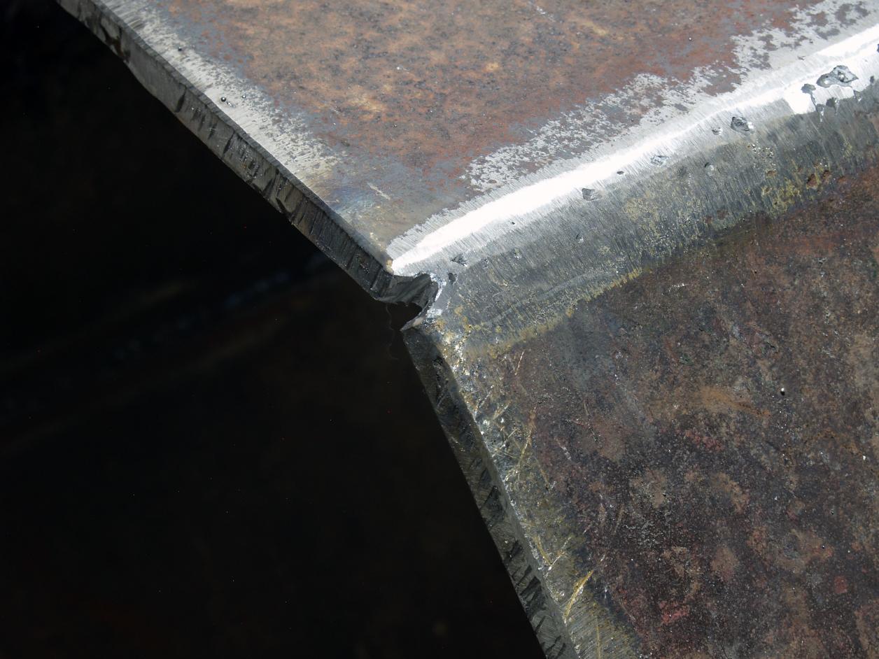

    I made a recent modification which breathed some new life into this old machine. Note the quad receptacle on the side of this little mig welder, and too, note the dual pig tails hanging towards the caster wheels. That is my modification, and that is what it took for me to stop tripping 20 amp breakers! What I did was created a branch circuit by pairing two 20 amp circuits together via extension cords. Different breakers on the same side of the main panel but shared or tandem. All I can say is; since I made this modification 2 weeks ago, I have not tripped a breaker since and my little mig has full power again. But this Franken-Smoker Companion build would be the perfect test, so let's use plan B and put it to the test. This is/was a great little welder, but it's got issues and I try my best to apply band-aids. But I can tell you straight and true, this simple mod lets me run at max capacity as long as I am mindful of the duty cycle which is only 20%. I've never before tried to weld something this thick with my little mig.
    This welder is rated to do 1/4" in a single pass, so how am I doing 1/2" with it? Easy, bevel the edges and use lots of pre-heat and weld at the speed of smell. Oh yeah, it burns in! But will it hold and do I trust it?
    Yeah I trust it!
    So far so good, it holds my arrogant 180 lbs. But I'm just saying, if you want to weld big with a little machine then be ready to pre-heat and watch it meld. My tac's were done cold, no pre-heat which shows in the pic below:
    Hmmm, I needed 8 hands and only had 1 available, I call it good enough for a fire pit! It's not finished yet, I have a lot more welding to do and then grinding because I want the outside corners rounded. Yes, apparently I like pain. It was fun in the beginning, I thought I knew it all (plan wise) and could just make it happen, but situations taught me otherwise. At least old school still works! But now I'm getting tired of it and I need the darn thing already! Just want it done so I can us it, I've decided to hard wire my arc welder so I don't waste so much time to preheat. @ 125 amps with my arc welder using 3/32 rods, I'll melt the electrode quicker than I can melt the steel, so I can power the welder from this location, but I hate what I have to do to make that happen!

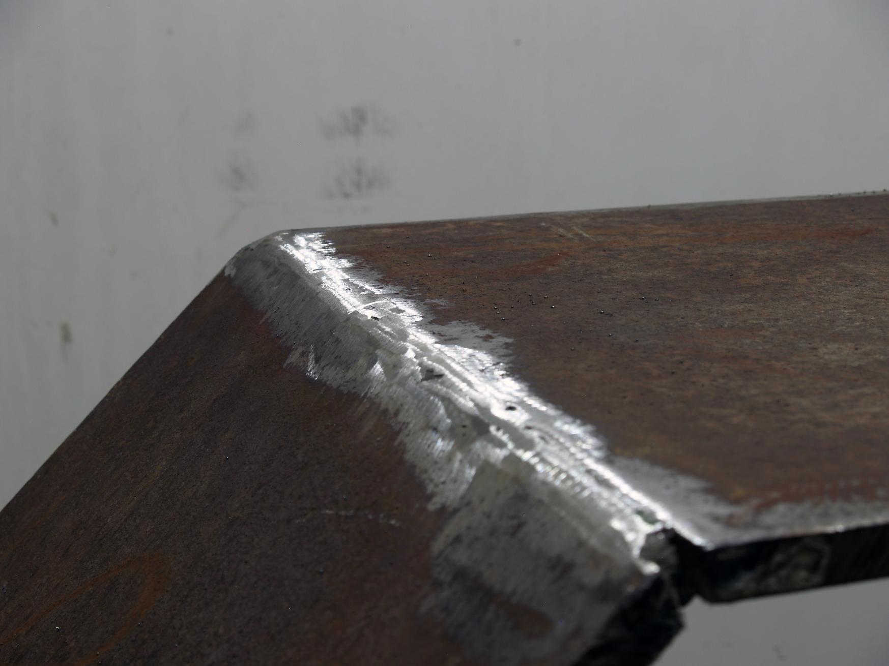

    Happy day, happy happy joy joy, I finished up my fire pit.
    This was a fun project all in all and I both learned and re-learned a thing or two along the way. I got a chance to use my arc welder for the first time in about 20 years, I thoroughly tested my mig welder modification and I re-learned some anger management skills along the way. And too, I probably inhaled all of my iron needs for the next year or so. Oh, but what I learned is that a 6010 rod works just fine on A/C. I used both 6010 and 6011 rods to weld the pit. I didn't need more than 100 amps on my welder to send it home, I forgot how damn powerful this thing is!

    Don't try this at home boys and girls, even though I did. But this is how I powered my arc welder above. Where I tied in is only a 30 amp circuit and not worth my time to install a 50 receptacle, I have a different circuit elsewhere that I'll spend some money on later. This worked well enough for the little bit of power that I needed.

    The pic above shows how I started after my aluminum foil incident. It's just a 30" diameter circle on a sheet of cement board.

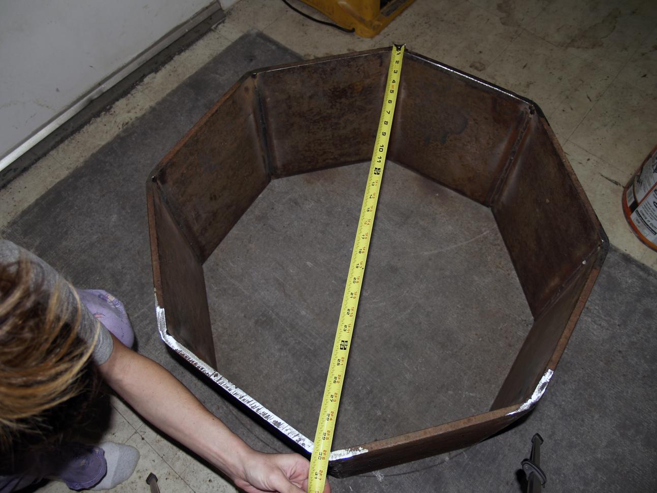

    From corner to corner I came out to 30" almost dead perfect everywhere!

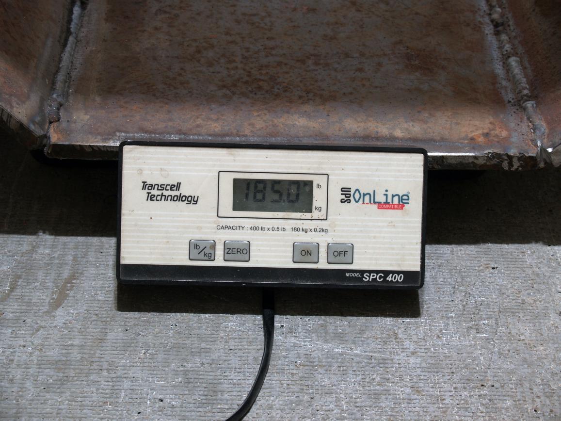

    I came in just 15 shy of my 200 Lb guesstimate, so I'll call 185 close enough.....

    I carved in some water drains/air bleeds on each of the bottom corners.
    It was painful to do, but I rounded all my outside corners. I just like the look of it this way, but man did that take some time!

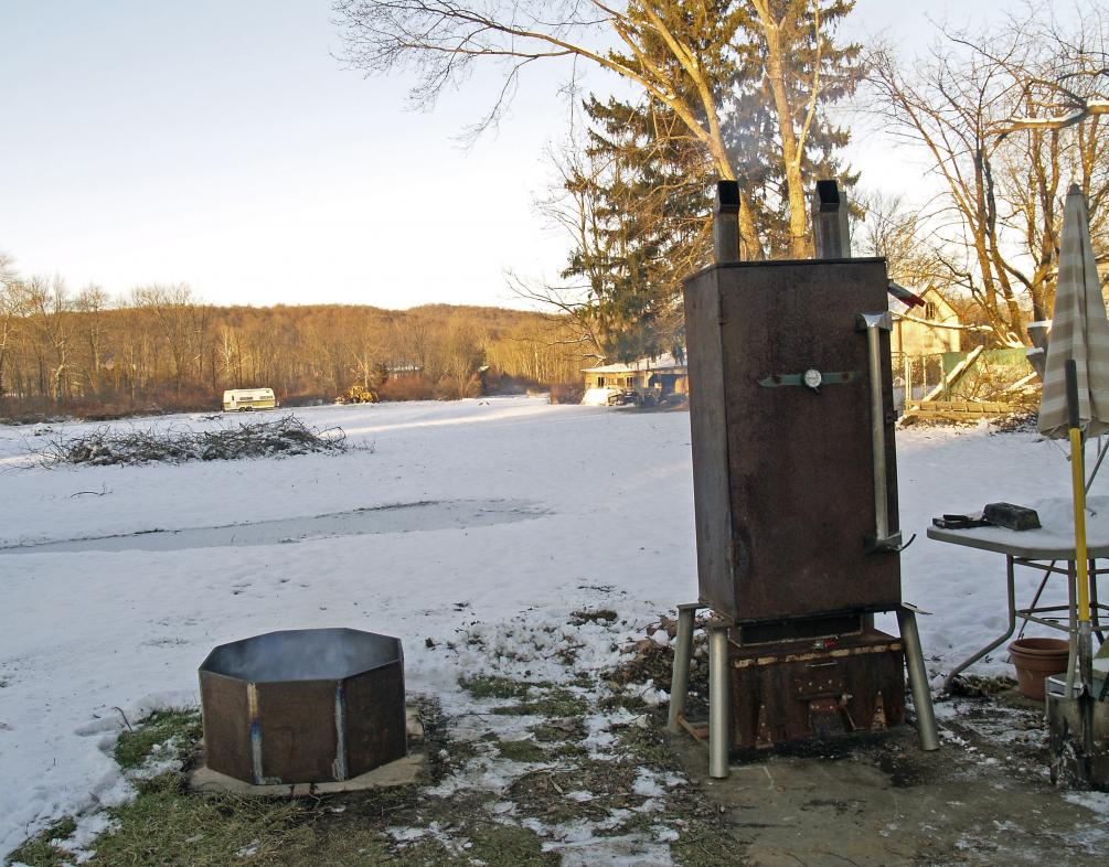

    End result, and now you can see why I call it the Franken-Smoker companion, they look like two rusty peas in a pod, ain't they adorable, lol......
    So this works out pretty darn well, I light a fire in my fire pit then shovel pre-burnt coals/logs into the fire box on my smoker. You can see where it got hot already and it's holdin! So that's about it for this year, I'm going to finish smoking some pork chops and keep indoors because it's only 22 degrees out there and it hurts to be outside right now.

    Whoever likes my background now is more than welcome to come on over and help me shovel:
    That fire pit stands 14" tall and this storm is not finished yet, the winds are picking up right about now with more snow in the forcast. But I've got food beer and shelter, so come on over.......
