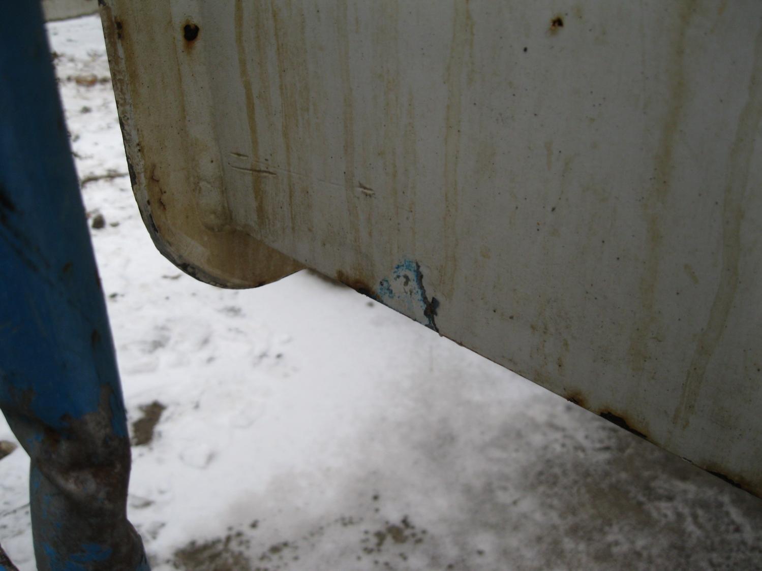

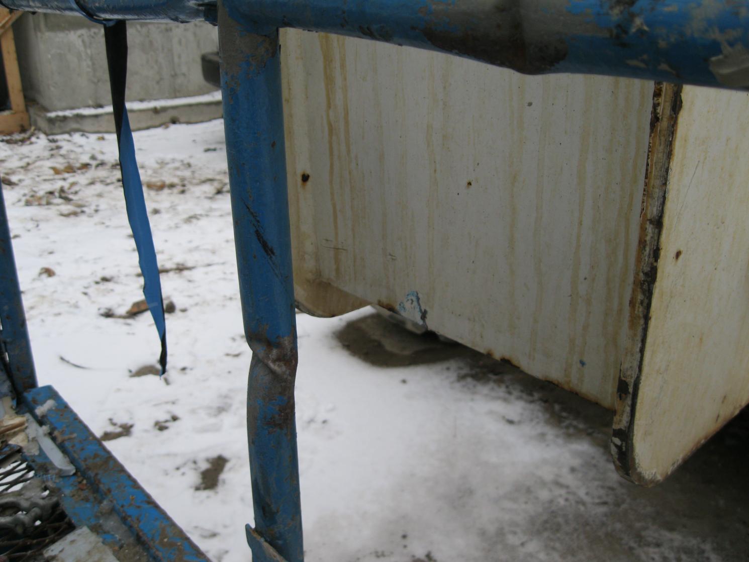

    Had to weld a Genie lift that was damaged by another lift the job site superintendent said it had to fix before it could be used. Straightened the tubes with chains and using the other lift to hook to two hour done and ready for work.

    We hooked the (8800 lbs. Gr100) chain on to my the truck first but it kept pulling it along the ground then we move behind the other Genie (12000lbs.) and hooked to it and used the bent Genie hydraulics to straighten it out just extended the arm and then hooked the chain on and slowly pulled it back till the rail was straight on each bent place till all was straight then welded the cracks and filled the dents. It was windy and cold but we did get it finished.
    The 8Kw generator would peak at 10Kw but it showed it was only running at about 80% on the readout.
    The MTS250S was set on SYN SPOOL, SYN STEEL SYN .030 WIRE 25/75 gas flow SCFH 40 for the wind.

    Being surrounded by building the wind was like an tornado it was coming at all directions. No one new how it happen it just got damaged they keep saying so we looked around to see what hit it and we saw what happen the other bigger Genie hit it. I sent these pictures to the owner of the company they own both Genies.
