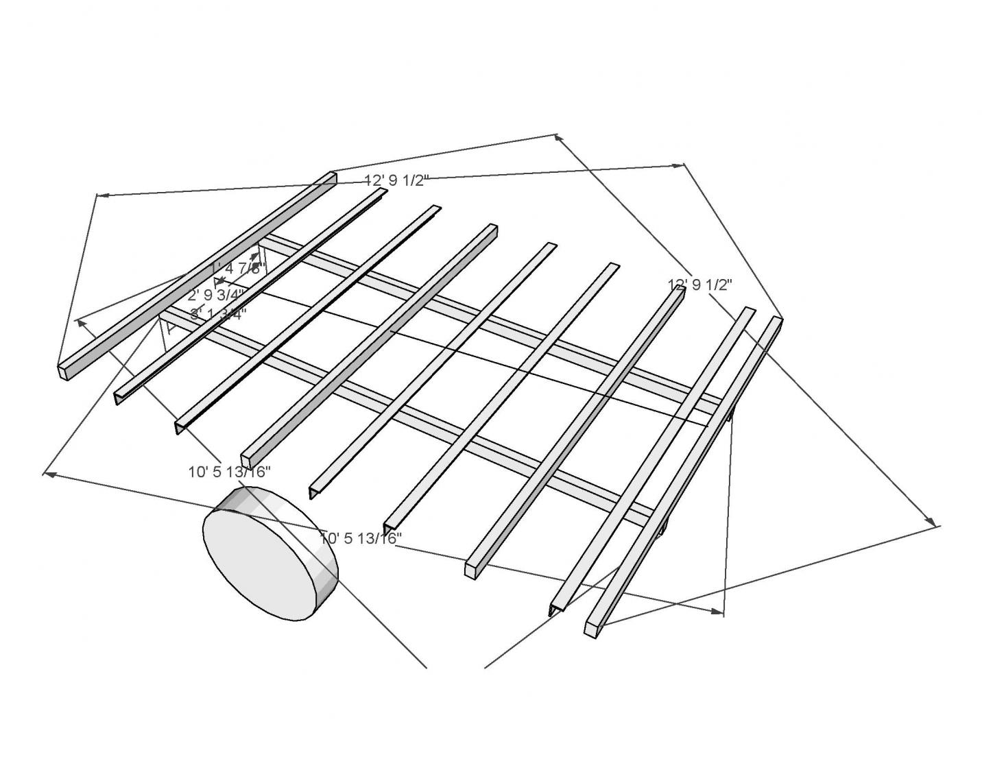

With the help of SketchUp 8, I was able to design the entire thing from the frame up. If you do not have a CAD program, I highly recommend Sketchup. Angles, dimentions, 3D view and ability to rotate around to get different views.

Then I drew up the entire design

Installed the deck and headache rack. The CAD design measurements was awesome. Cut everything to length, angle, etc., laid it out on the bench, verify that it was square and weld it together. Fit perfectly.
