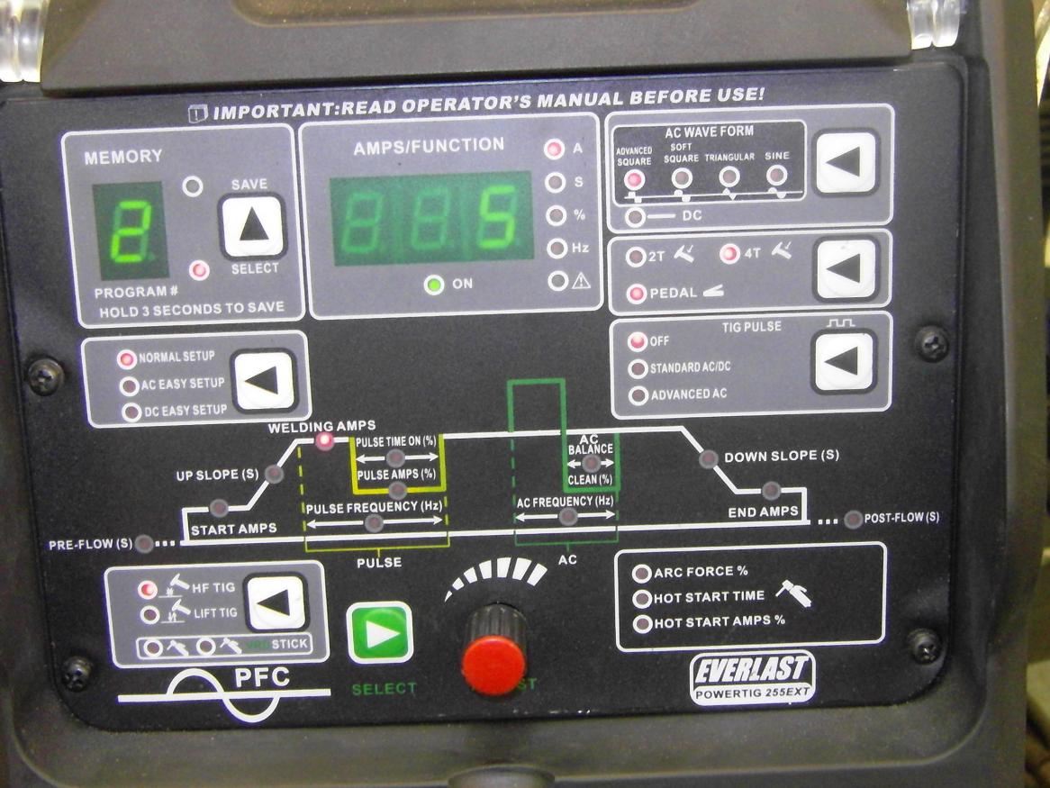

    Got a 805 code when I pushed down the foot pedal to see what I had set the amps to I and got a 805 code, let off the pedal and the code went away. Checked the book and it said that Code 805 is (TORCH SWITCH IS STUCK CLOSED/ Turn off welder immediately and check switch) the switch is fine. It only dose it when you do not strike an arc within a few seconds like just too far away for the arc to start. If you let off the pedal the code disappears but if the code come on when you are going to start to weld and don’t for some reason, know the code comes on before it start an arc it will not start even if you touch the work with the tungsten it is dead, you must let off the pedal and restart again.
    So it sounds like this is a code that means your tungsten is too far away from the work.
    I don't quite understand your last sentence, though. Is this more for information or is there a problem?
    From what you say, if you depress the pedal before you have the tungsten close, this code will display and the machine will not start until you release the pedal and try again. But if you first place the tungsten close to the work and then hit the pedal, it starts right up. Sounds like that is by design and I don't see a problem with that, but it is nice to know. I am curious as to what is the behavior when you are in lift arc mode. Do you need to touch the tungsten before you hit the switch, or can you hit the switch then tap the work?

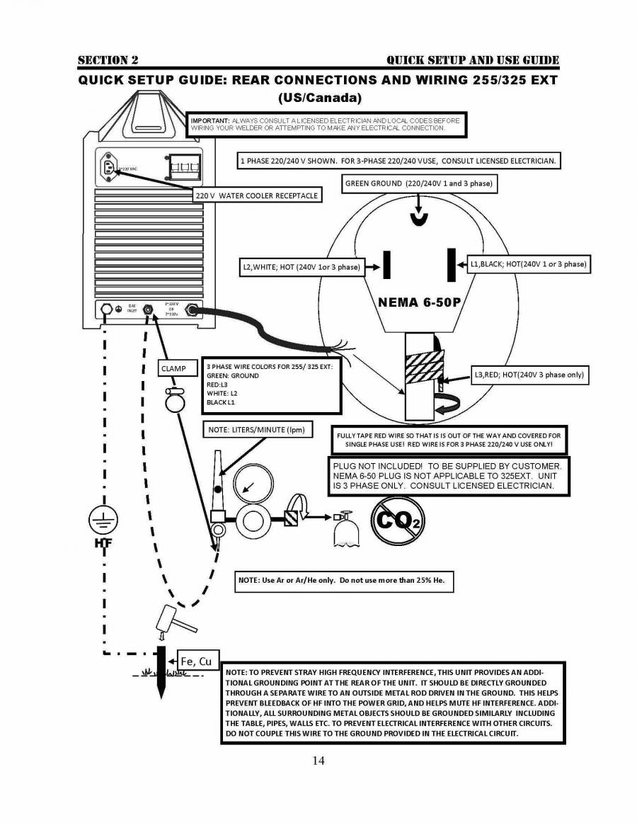

    Thanks on the green lineup. On page 14 of the online manual it shows the welders 220/240V plug is your not connected to the water cooler so when you turn the welder on it turns the cooler on. The Canadian one has it.

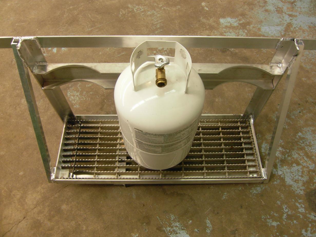

    Well my conclusion so far with the 805 code by welding up a triple tank holder all Aluminum for a trailer, using the Everlast Amptrol Tig gun set to the Special setting of T4 plus Pedal, I never got the code 805 from low amps to high even when I hit the button before an arc started (OOPS).
    It seems that the problem is in the foot pedal setting only so far in my testing and welding jobs and I did try all of my pedals one prototype and the two 250EX and the one that came with the 255EXT all EVERLAST Pedals.
    T2 or T4 with pedal I never got the code 805 in AC or DC welding.
